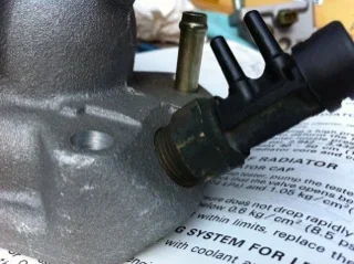

The top part of housing has a couple of sensors that have to be
screwed out of the old and put in the new housing. One is for VSV or
something and has two vacuum lines attached to it. I can not get the
thing screwed all the way into the new housing. Any ideas or tricks?
It dosnt have to screw in all the way. Just wrap the threads with teflon tape and snug it down.

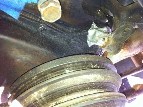

Here is another question, does this look like a timing gear gasket leak
should I fix it now or later and how involved is it?
It's a 20 year old car. It's gonna leak.
Have you thought about getting in to MG's? Nash metropolitan's?
