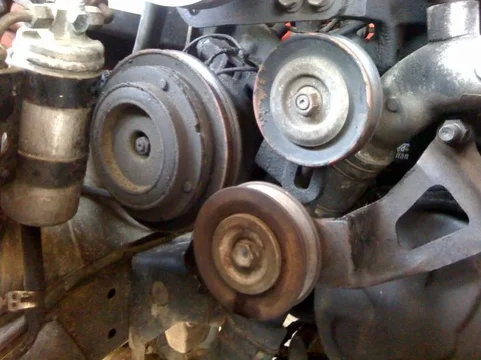

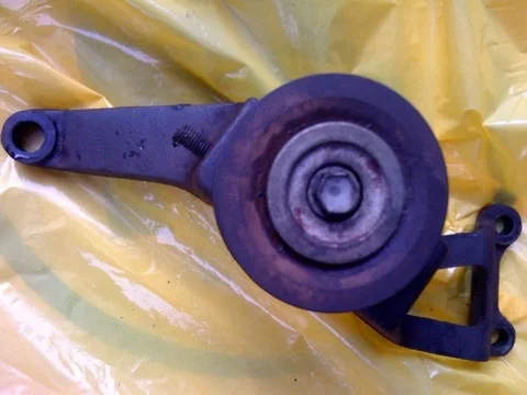

How dirty and rusty do these accessories and idler pulley look?
Clean em' up and they will be fine.
You need a Toyota Factory Service manual.
You could probably kill a lot of time taking them off and replacing the bearings at a place like Motion Industries.

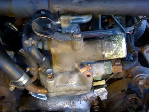

Well everybody was out of my hair today, so I got up ready to put those Cruiser Dan parts to good use.
Plan A, R&R water pump. Plan goes great until I pull out last bolt. It comes out very hard, with most of the threads rusted to where you barely see the threads. Call Cruiser Dan and get new bolt. Might be here in ten days. He has to special order it then get it to me.
Plan B, R&R thermostat. Follow FSM and get to the point of removing four bolts. First one is a little tough so I add a little PB Blaster and will come back to it. Next bolt come out easy. Back to the tough bolt. A little easier to move then a lot easier. OH s***. That little bolt on top of thermostat housing should be a lot longer than that. Call Cruiser Dan and order more parts. Damn this is expensive!

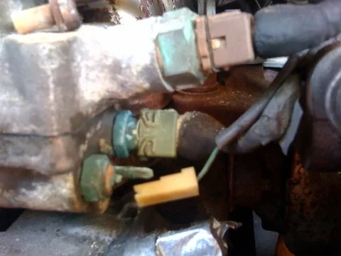

Anybody know the best way to clean that green corrosion in the pic below?
Replace PB blaster with Kroil/AeroKroil from KanoLabs.com
Steel bolts into aluminum are the worst. I soak with kroil for a day or so before trying those kinds of bolts.
Wash the green parts off with gas and they should be fine. You can also clean them with a mild solution of muratic acid. Be careful.
Be very careful removing the connectors, especially the one in the top of the 2nd pic. They are brittle and very easy to break.
