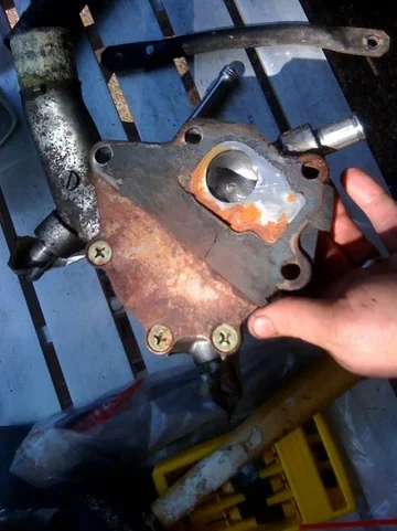

Here is a pic of water pump. It looks like gasket had a small crack in it.
When installing new water pump is it easier installing with or without hoses attached. Any hints or advice would help.
I did not sealant and no hoses. may sure it is all real clean on the truck. Also make sure they are all good and tight or you will have to bend your arms in ways they don't like after you get it all back together.
I replaced all the studs with bolts for ease of install and then I knew that I would not have a broken bolt issue later down the road.
