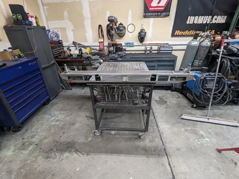

Pulled the trigger on a custom bumper! Got a sneak peak today!! Looking awesome! @TRAIL TAILOR
Does that have returns on it like the Kaymar to protect the rear corners?
@cstav86 Yes sir, I had him put returns on it. Not only for protection, but, I like the way it fills the gap from the side view.
I was torn whether to put a return on the ends and decided against it. The thought being a stick gets in there. It's easier to clear if left open.
But. If closed off, should be less likely.
Are you putting extra reverse lights in?
If so, put them on a three position switch.
ON-OFF-AUTO ON
Yes sir, he is. And thank you! That is a great idea!!
I saw a guy at SAS 8 put his 40 in the side of the trail going up Poughkeepsie and his Kaymar bumper with the returns saved him some serious body work. Been interested in a product like that since I saw it happen. That looks like a killer American made option.
I pulled power from the reverse switch on the tranny. I still have to wire and mount it, but the plan is to run everything off a relay block for any extra external lighting. So that power from the transmission will go through the switch still, but then to a relay as a trigger. That way I'm not really putting any more load on old Toyota wiring.
@sogncab the middle holes will be the backup lights. And the upper receiver on the right side will be a removeable mount for my ground tent to sit on!! Pretty stoked to see this come to life! Looks awesome!! @TRAIL TAILOR
