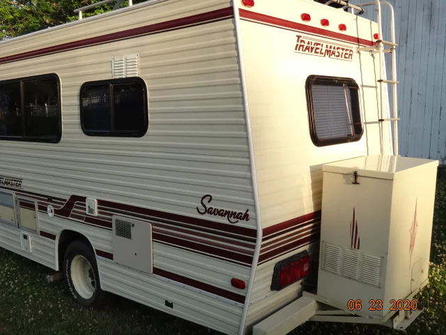

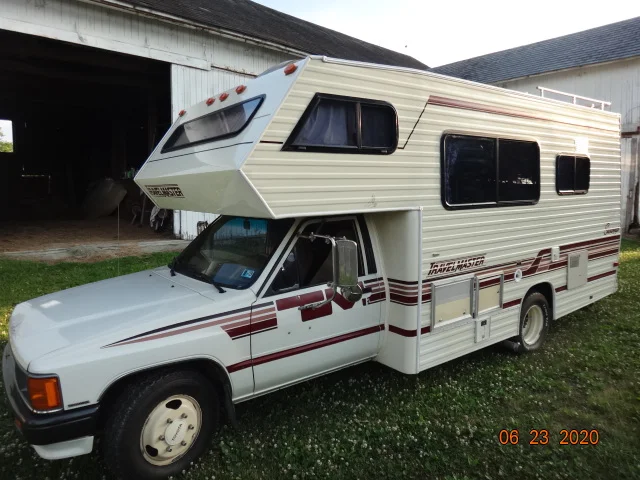

A little on the RV and why I don't want to give up on this yet.
It has always been under a carport and I have had it in a barn. There is zero rust and never had any. It does not leak anywhere. It also has a Yanmar diesel generator. It is a 5 speed and the unit gets like 26 mpg. It is marginal top end but works ok. I replaced all silicon caulking with polyurethane. I replaced all trim. Got rid of any dry rot wood sub-frame behind rear wheel with pvc "wood". This was built by Mastercraft and there was a small area behind wheel wheels that wasn't protected by aluminum so that is why there was marginal dry rot. Previous owner replace all rubber bushings for front suspension, not sure anymore about torsion bar area. I did new front shocks and tires this year. Interior of truck is like brand new with no wear visible on seats etc. Original ac unit works as well as roof top. I replaced the RV water heater and got new cooling guts for refrigerator. I also replaced charging single phase converter for house battery with 3 stage. The roof is single piece of aluminum plate with no leaks. You can run everything off of the generator as well as use it for essential items in the home in winter when you loose power. The only paint issue is slight rough area on hood from turbo, not really noticeable, but I was going to repaint and put some kind of heat shielding under the hood. Not sure what I have pic wise, but I will try to attach with this post.

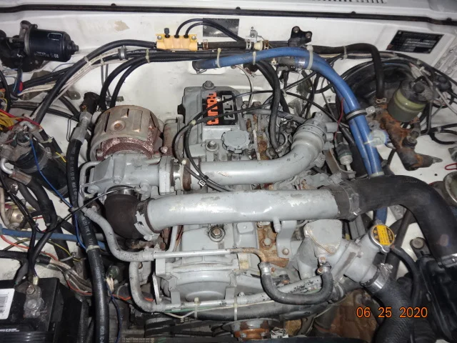

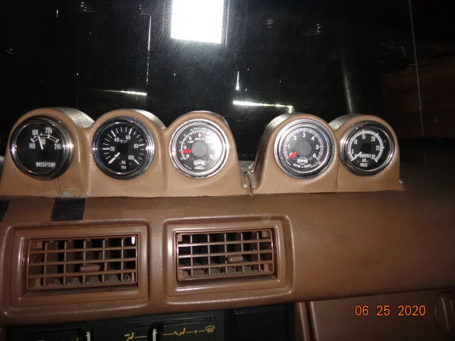

Anyway, I am in the Allentown area and this is my first diesel. I basically do all the work on my vehicles as I am a bottom feeder so i don't know many mechanics and I know zero diesel mechanics let alone one that has experience with this motor. I would consider replacing with a latter gen unit, but I do not know the ins and outs with going from mechanical fuel injection and also bell housing etc. for the 5 speed trans. Rear box is where the generator is. It has full gauge pack. Dwell, manifold pressure, oil, tack, battery etc. These pics do no justice and it says I can only load 5. you can see that engine does not have later plumbing for turbo.
