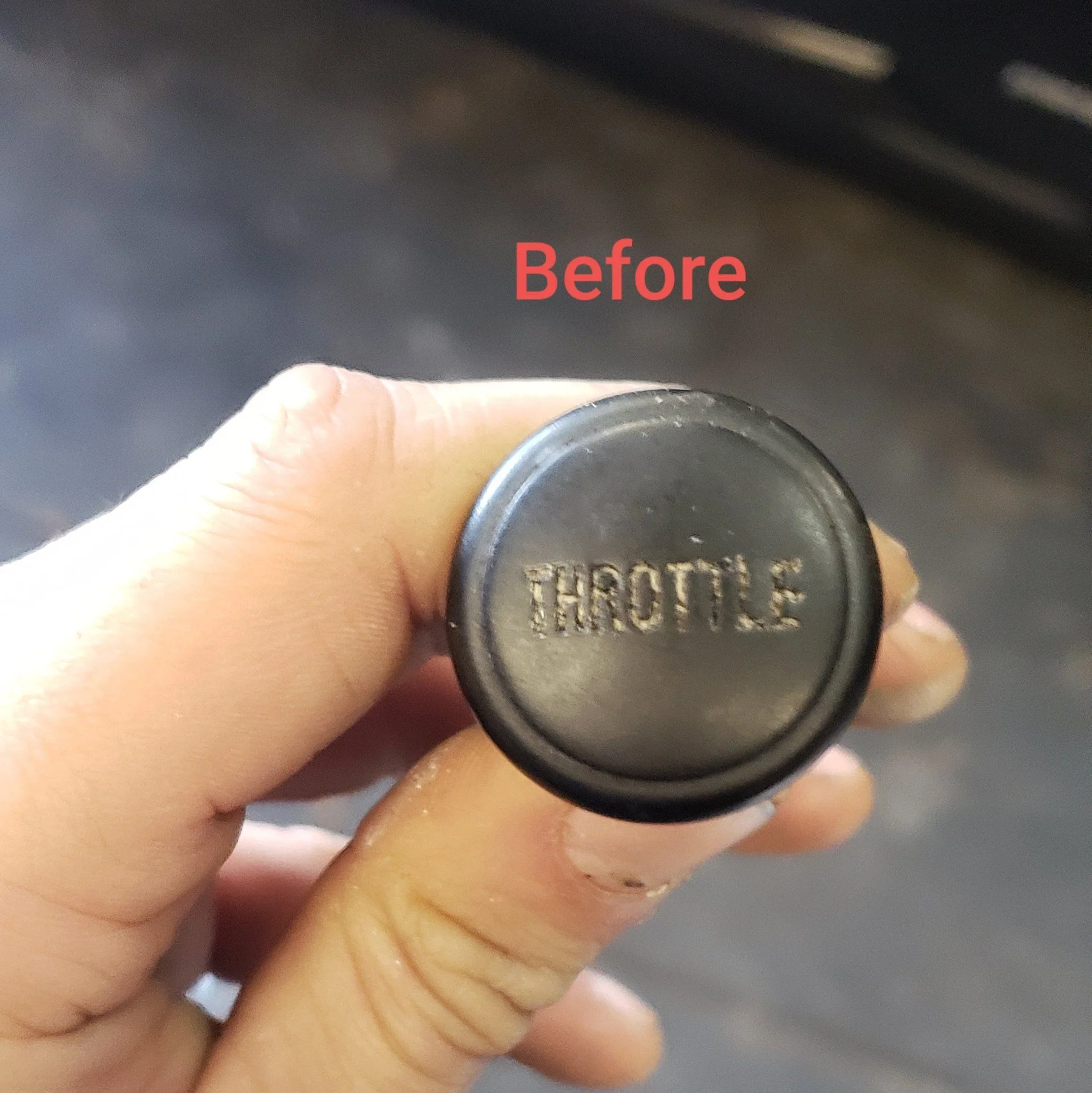

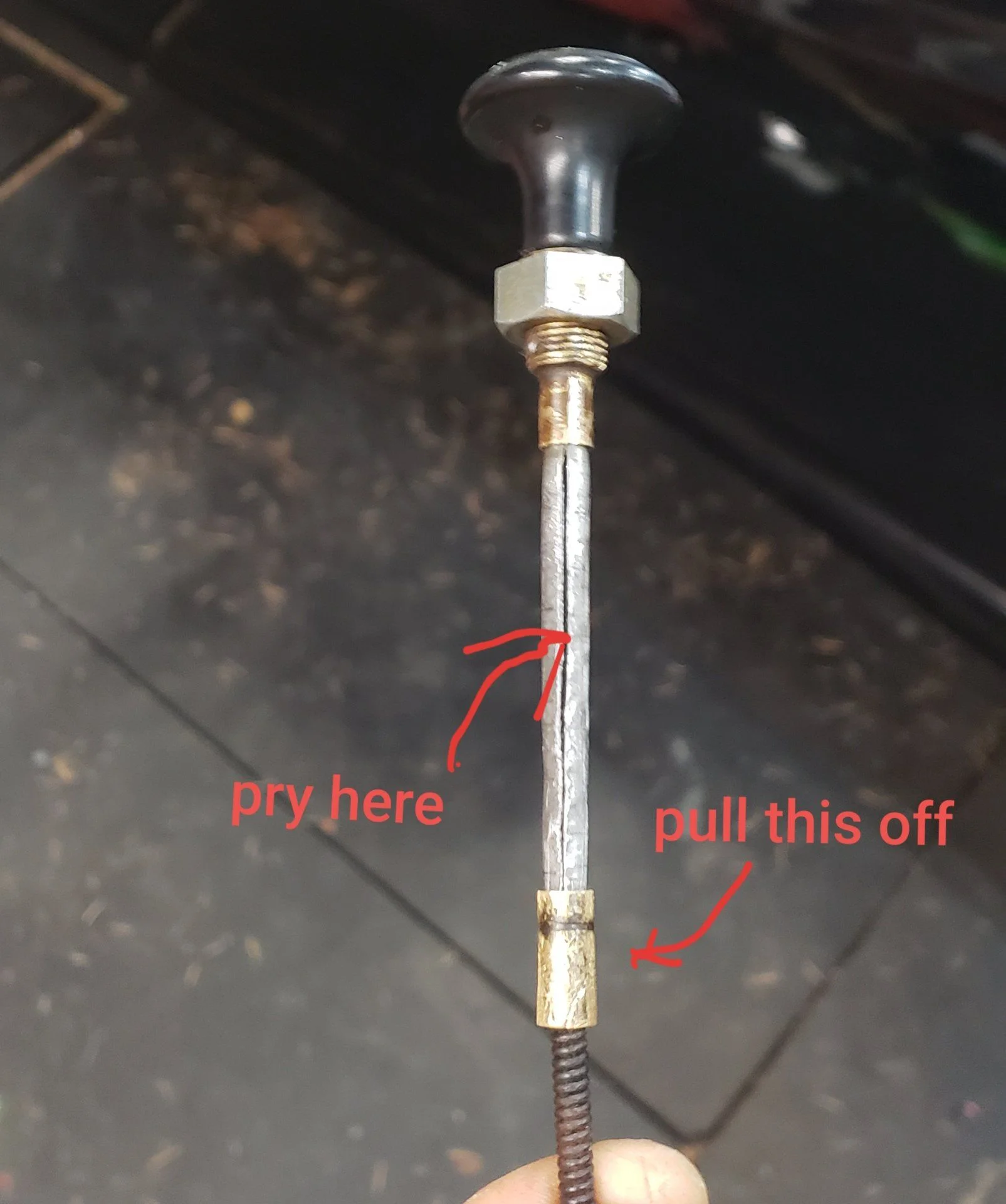

Another little project today. Restoring the stuck hand throttle knob.
The original cablecwas VERY stuck inside the housing and needed a lot of oil and heat to even get it to budge. I eventually came to the realization that I wasn't getting the housing off the cable if I didn't get the knob and solid shaft free of its housing. There is a cap at the end that can be removed and the housing can be pried apart at its seam with a small screwdriver.
From there I was able to get to the solid shaft attached to the knob and clip the cable off the end of it allowing me to remove the knob.
I was eventually able to pull the cable from the housing by wrapping one of the ends around some needle nose pliers and going to town. (I decided to replace the cable, but wanted to retain the housing). Once the cable was free I cleaned the housing the best I could and let it soak in some Marvel Mystery Oil .

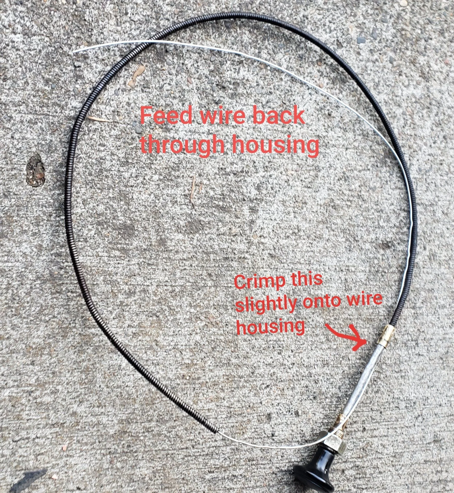

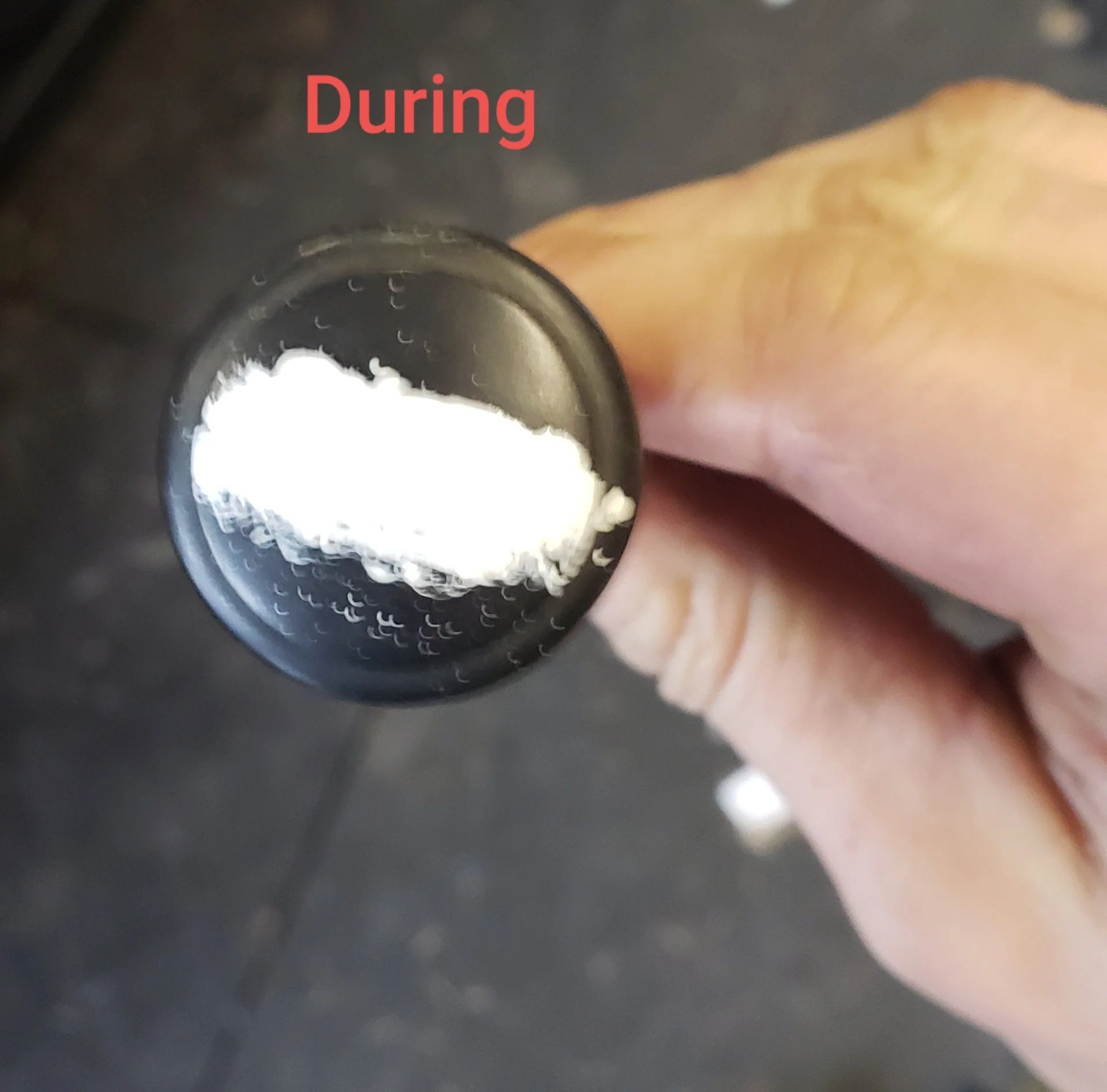

Onto replacing the cable. This poses some challenges because the solid shaft that allows partial pulling is actually fused with the flexible cable. You can't just easily remove and replace the cable. I decided the best course of action would be to try and solder the new wire on.

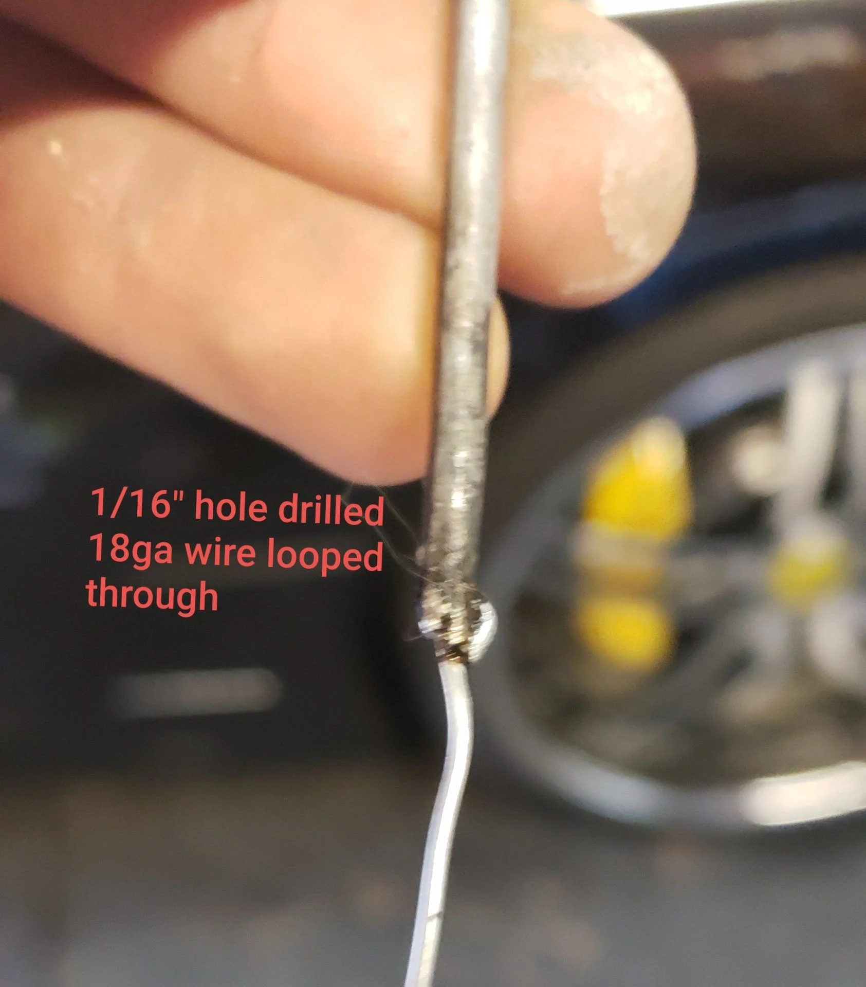

For the replacement cable I chose 18ga solid wire. The original cable is 16ga solid wire, but 18ga should move more freely in the housing and is plenty strong. (The steel galvanized wire they sell for picture frame hanging is perfect). I've heard of people using bike cables, but I tried to stay original.
To attach the cable to the shaft of the knob I first drilled a 1/16" hole in the shaft near the end. I then made a small hook at the end of the wire and threaded that through the hole, crimping the hook.
I then soldered the wire in place

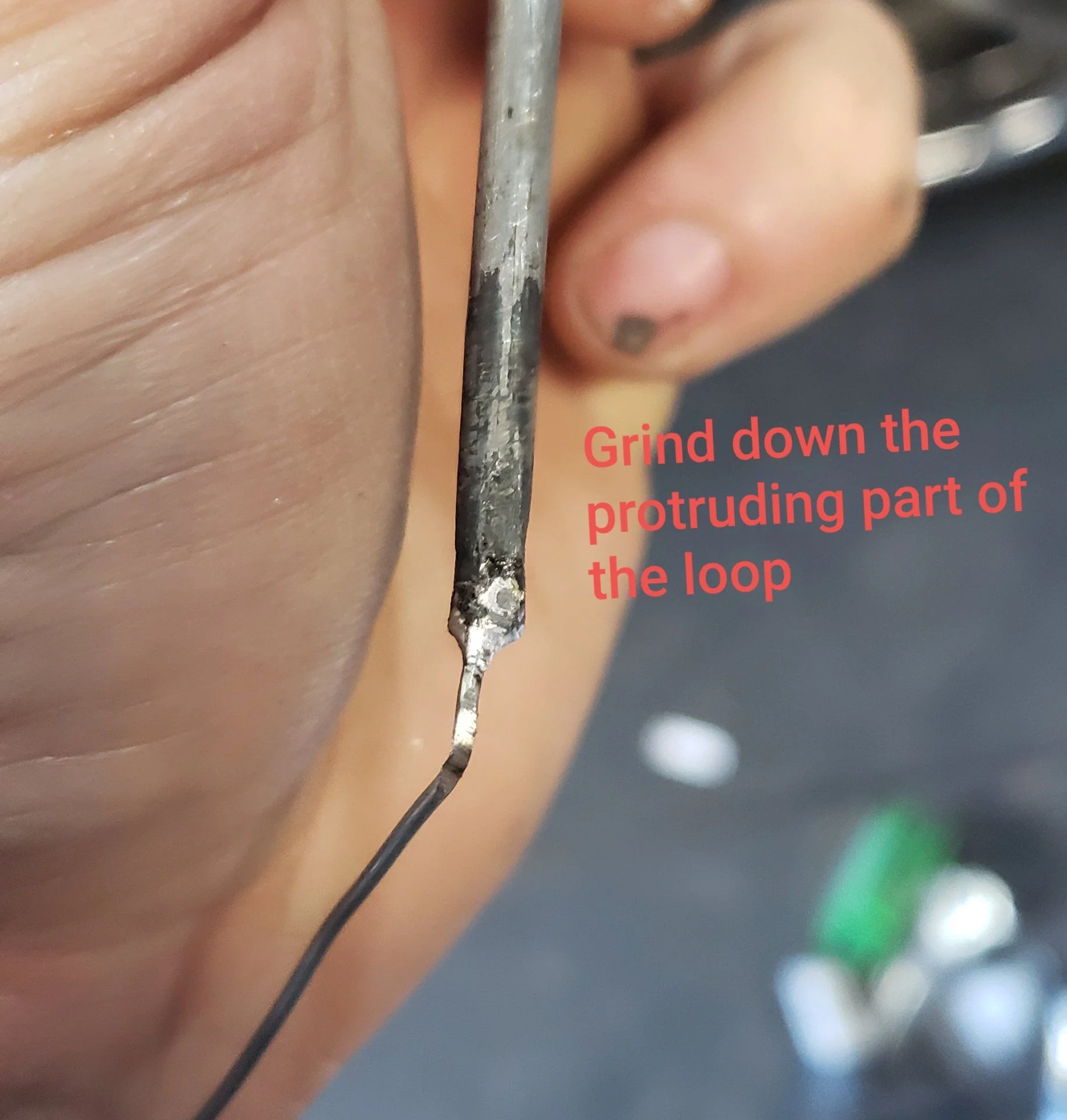

After soldering I ground down the loop on the cable to be flush with the shaft (to make sure it can thread into the housing unimpeded)
From there, thread the knob through it's housing, bend it all back together, add the end cap again then take the cable housing and thread the cable through that. Now you're done! You have a new cable!

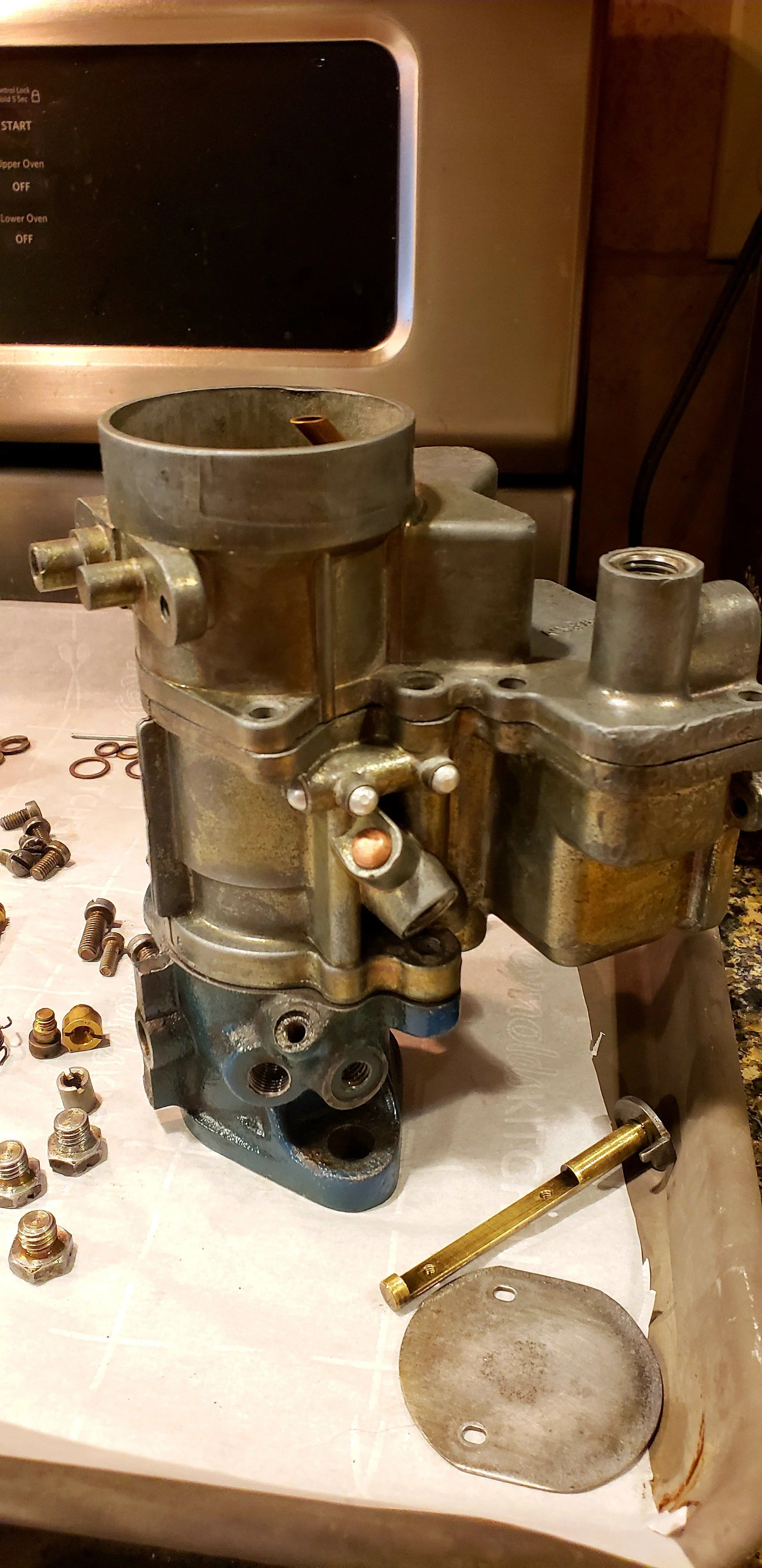

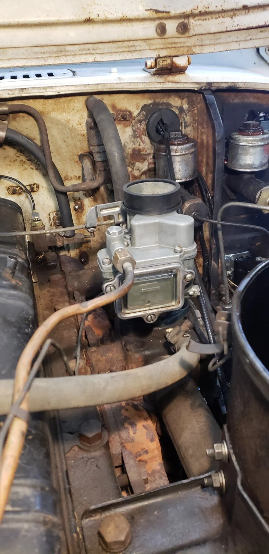

SD40 is freshly rebuilt and on the truck!
Still needs some adjustments so I'll likely be pulling it back off and going through it again as I'm getting hesitation/ stalling on throttle. Wondering if I put the wrong step-up rod in or if I don't have it adjusted correctly.
It idles beautifully though, and looks nice too!

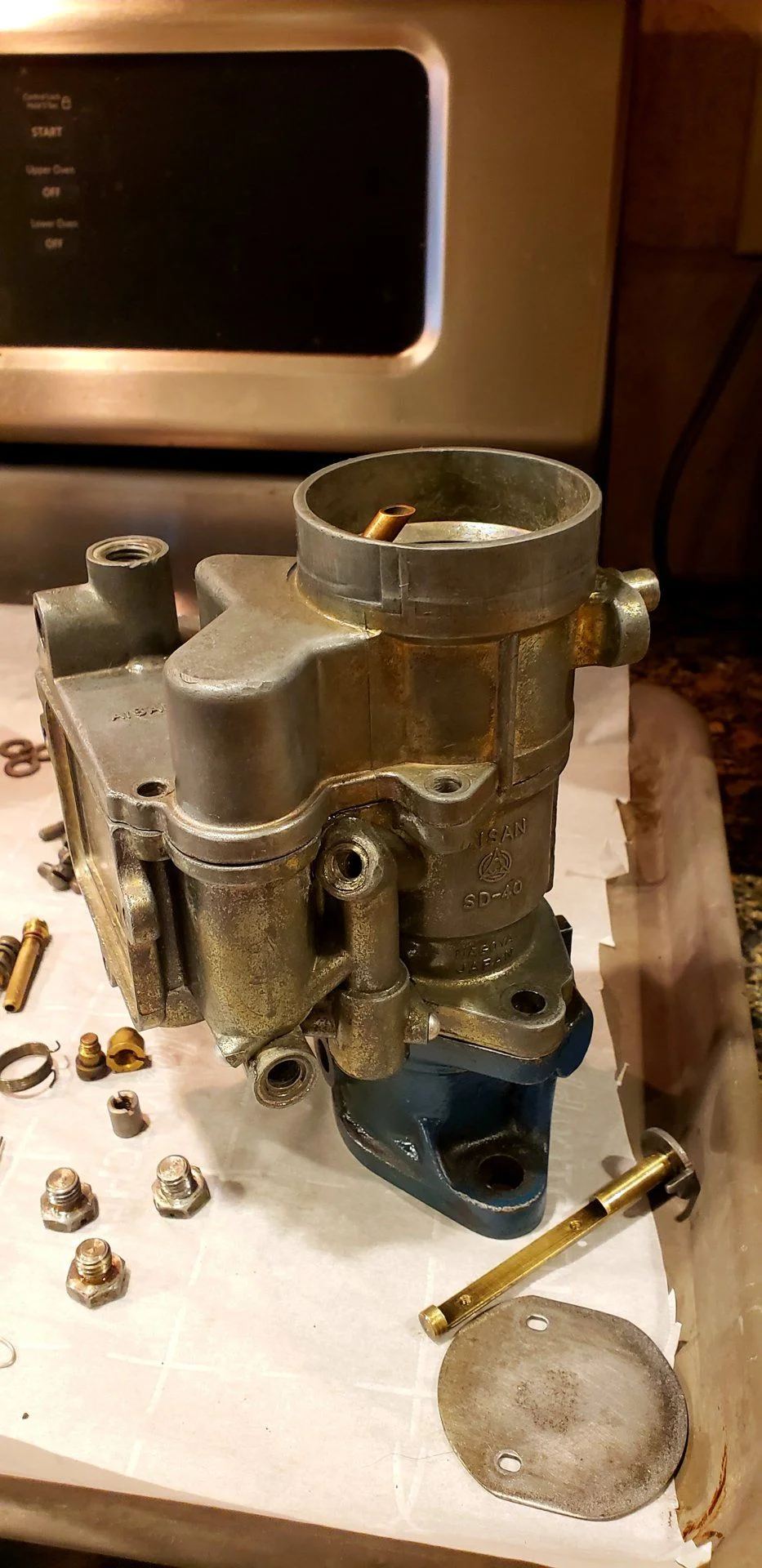

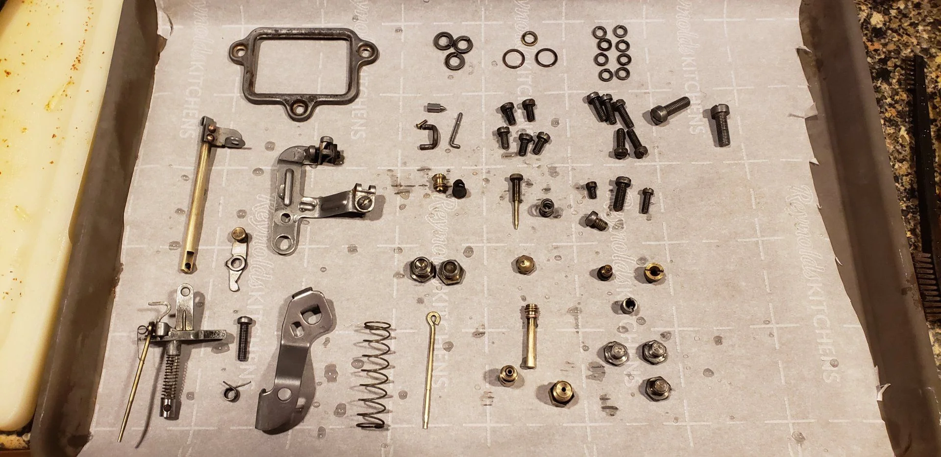

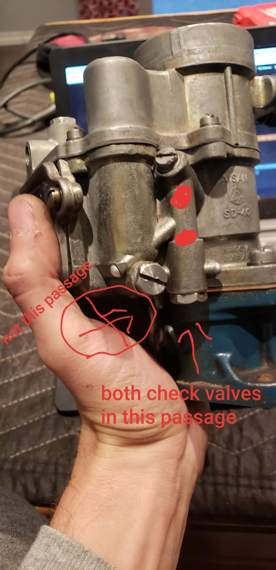

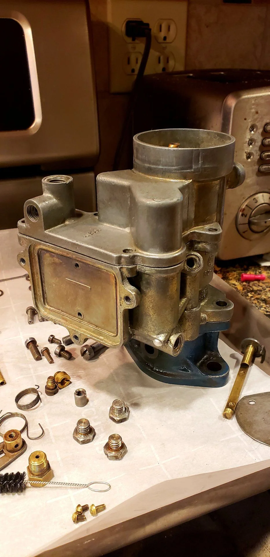

Okay pulled the carb off again, and stripped it down again.
Two things.
1. I had a check valve in a place it didn't belong (but where it fit perfectly oddly enough) and it was partially blocking a passage on my accelerator circuit. (See picture)
20181127_102059-jpg.1840950
2. I needed EVEN MORE advance than I was running with the rochester on the pertronix setup to get this to accelerate smoothly.
The rochester was running 10 degrees PTDC, I'm now running 13 degrees PTDC and it's smooth as silk....
Crazy....
