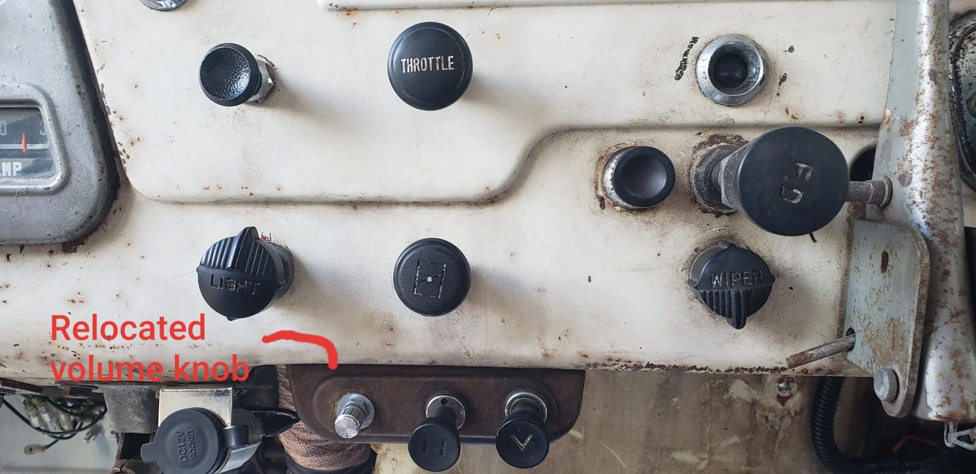

Reinstalled my restored hand throttle today. Had to move the volume knob for my stereo to an unused hole on the heater controls. I actually think it's a better fit there. Maybe I'll even get another V knob and drill it out to match.
You don’t have a heater but have the H knob? The volume knob is where the heater on/lo/hi fan pull knob goes.
I have a heater. Its just moved out of the way so i could access behind the dash easier
The fan switch is right beside the volume knob. The spot where the volume knob is was just blocked off with a round metal plug.
Oops, yeah, I’m brain dead. I added a heat shutoff valve to my ‘65 FJ40 for a FJ60 so that’s what I have in the H position, and the fan switch where your volume switch is. Funny how as time passes I forget more and more of my “OP” hacks.

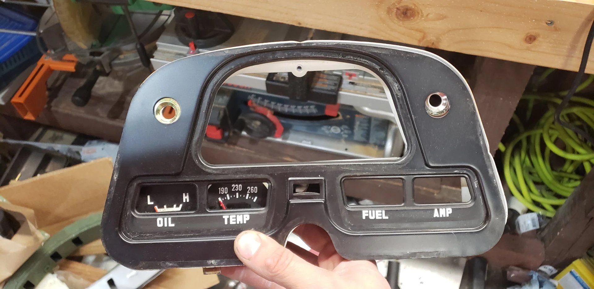

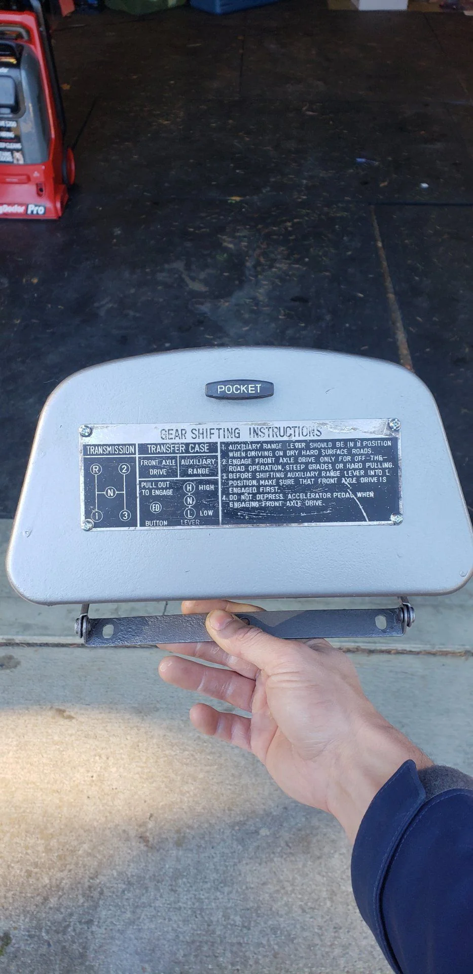

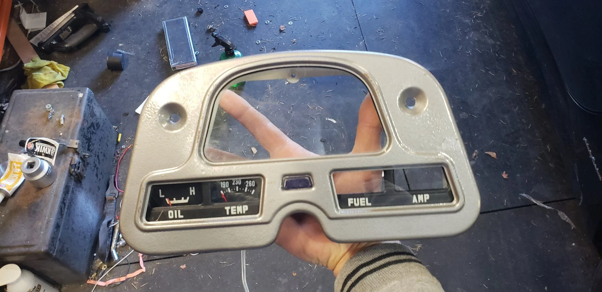

Started restoring some interior bits over the past couple of days. Didn't find a perfect match for the grey of the interior pieces, but Rust-Oleum Hammered Antique Pewter is pretty close, and everything will be getting this paint treatment so it will all match eventually .

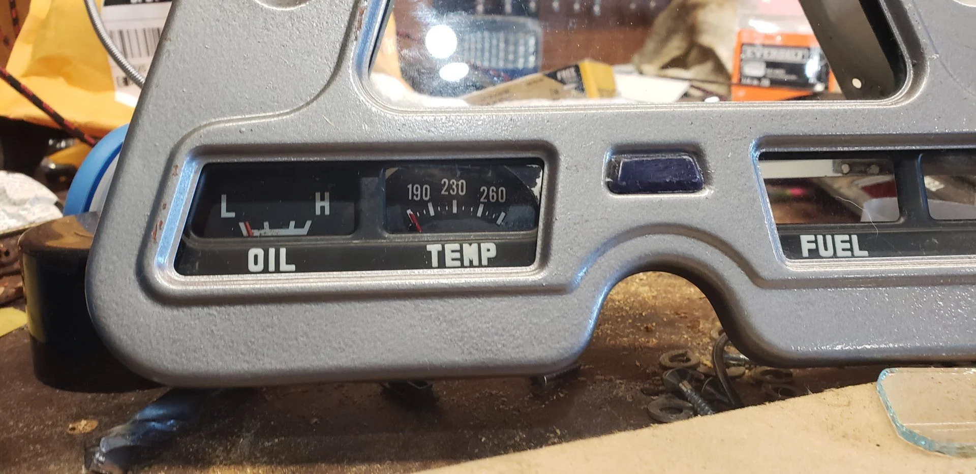

Also contemplating a move to an autometer mechanical short throw temperature gauge. My current gauge is still not an accurate reading after replacing the sender unit and rewiring it. It still goes all the way to high when it's up to operating temp. It's not over heating as I've confirmed several times with my laser thermometer .
I have some extra dash clusters to play with so I'm going to see what I can put together and still look stock, but have an accurate temperature.

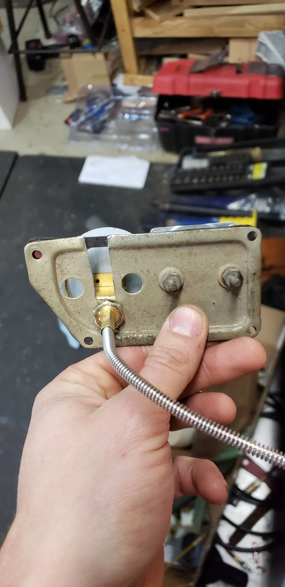

^x2. A pic of the backside mounting of the autometer in the cluster?
was posted above, but here's what i did... cut a slot in the plate the gauges mount to.
That's the only thing that kinda sucks about the mechanical gauge. You can't unhook the tubing to install it. Otherwise you'd just be able to drill a hole.
20181204_152617-jpg.1847229
Dang, another brain dump on my part. Didn’t realize that pic was the backside mount, duh! Nice creativity!
