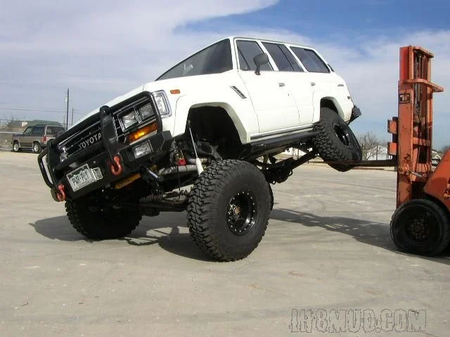

Myself I was on a really tight budget and my car is a daily driver running upto 35''-36'' tyres offroad. I chose to remain with SPUA but still got excellent results with the front end, the rear worked ok but is limited by tyre to inner guard clearance, even with a 60 series rear axle. Modified front shock mounts are a must.
On this car I did a RUF (rear springs up front) combined with a 2'' extended shackle.

Thanks, was my old one, a FJ73, was pretty rough and ready, sold it and bought this BJ74.
Very different suspension setup in this one, I have 3'' lifted (now sagged) dobison springs, less flex but I can use stock ARB shackles for a better approach angle, combined with a sway bar this one drives much better.
