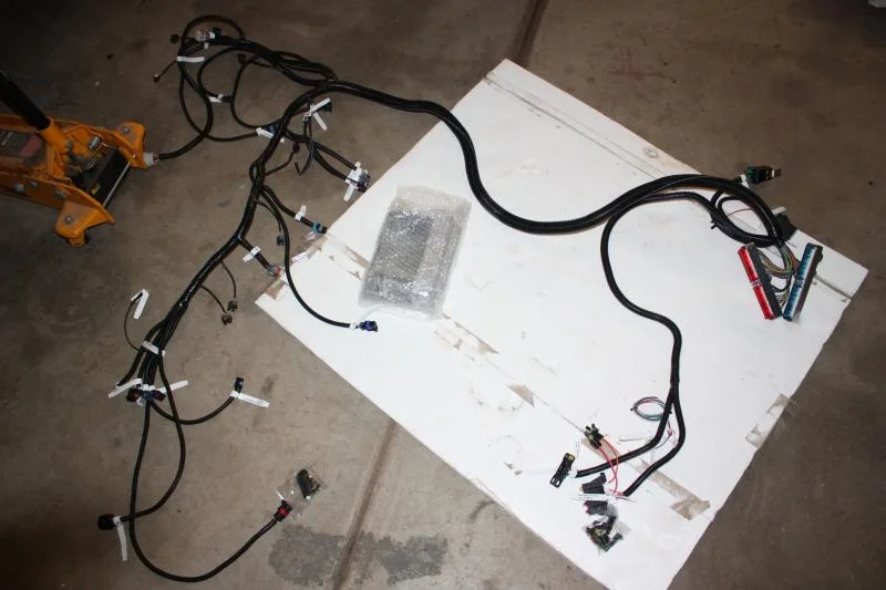

looks like we will be firing this up on wednesday or thursday as I just got a tracking number from Howell for the harness and computer. Wednesday delivery. should be okay cause i still have a few things to button up prior to throwing a match in this.

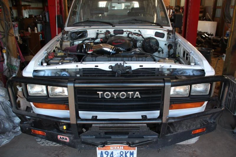

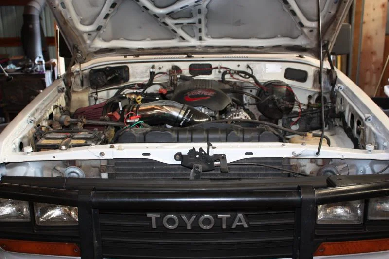

Went and saw the 62 yesterday at the Barn, WOW! It looks so amazing in person, photographs truly do not capture it. And there is tons of real estate under the hood now, you could easily fit two more batteries and a compressor in there, there's that much space.

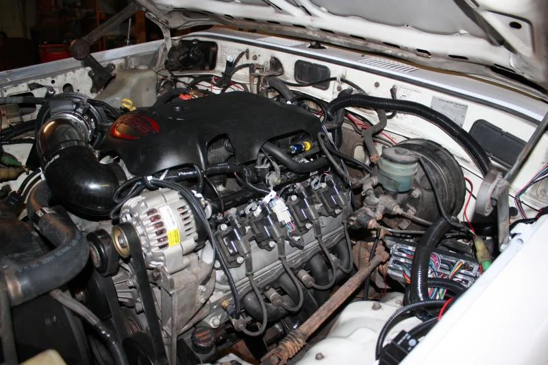

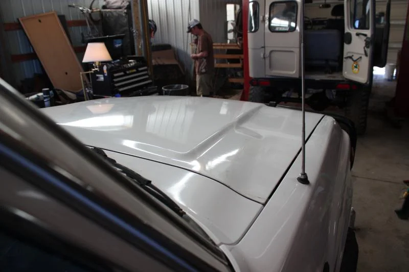

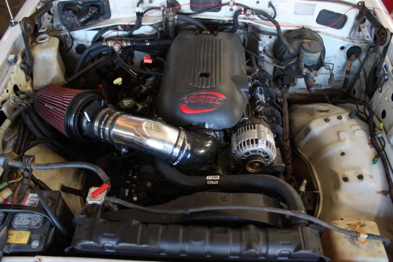

I got the hood mounted and all the lights and bling back on bullwinkle today. LOOKS AWESOME!
Ill go get the camera and download some updated pics. the harness and computer arrives tomorrow. Im going to fire it on friday....i think.

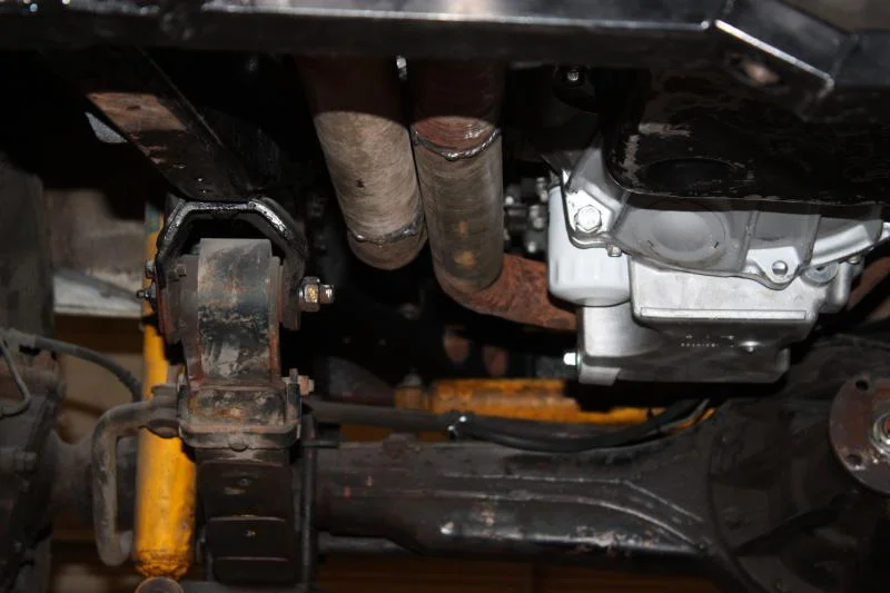

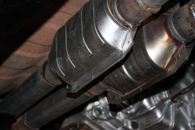

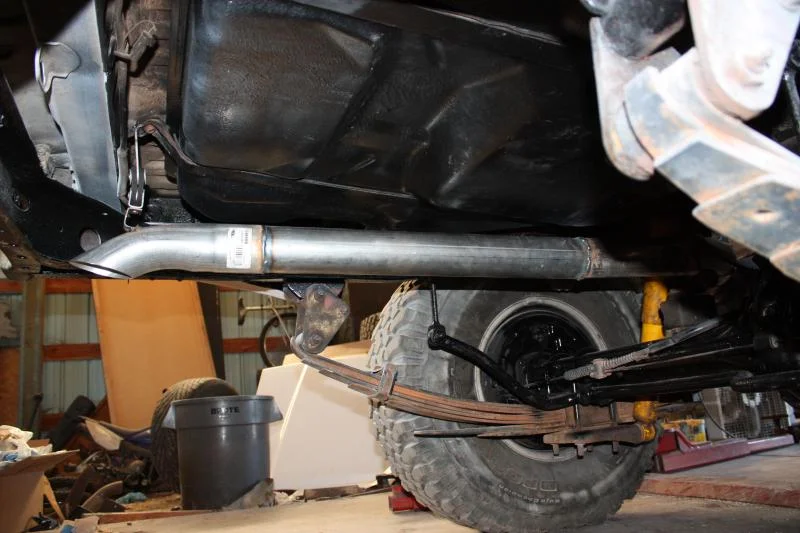

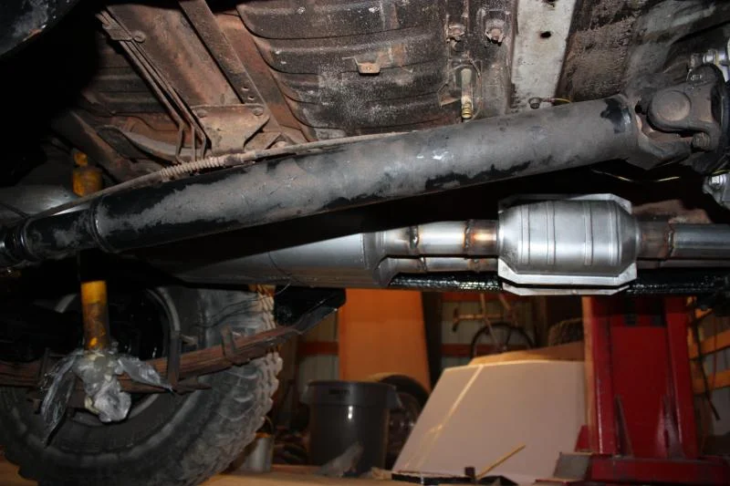

Heres some progress photos of the exhaust all finished up. Two cats and a magna flow 50 series 2 in and 1 out.

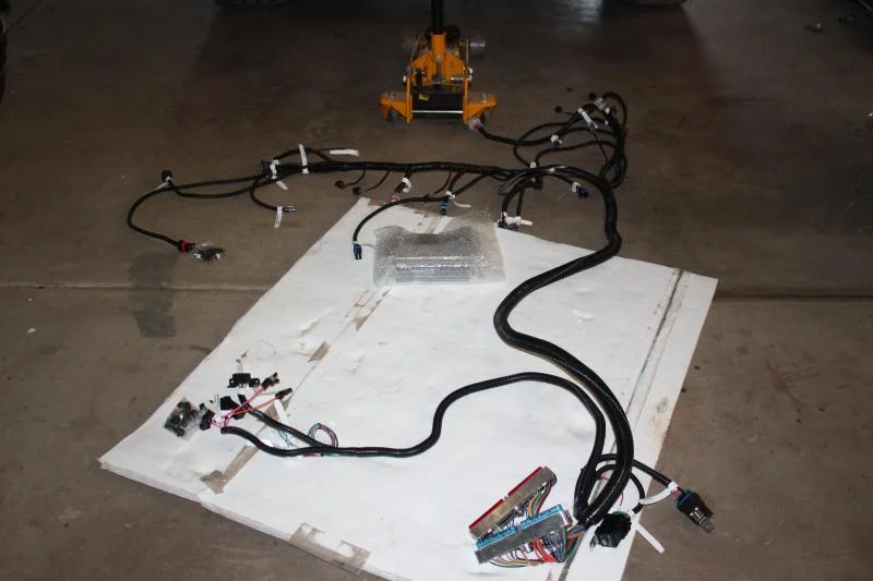

Harness and computer are scheduled to arrive today according to the UPS tracking website. I cant wait around for it though. It should be at my house when I get back from the barn.
Wiring harness arrived yesterday around 4:30. Needless to say I drove to the barn and worked until midnight. I got most of it complete but not powered up just yet. I will complete it today.
Now I need to go pick up 12 quarts of tranny fluid, (almost $6 a quart for that crap) 6 quartz of 5-30 oil, gear oil for the TC and some power steering fluid.
Should fire this rig tomorrow!!!:clap:
