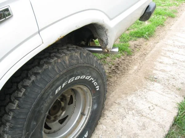

We joined the Capitol Land Cruiser Club, a cool group of folks. We went wheeling in George Washington National Forest and Uwharrie down in North Carolina. The East coast is beautiful but you have to drive quite a ways to get away from the hustle and bustle of things. We kept it stock except for a set of 31s from Lance at Iron Pig. I found a local guy selling his sixty online and asked him if he wanted to sell his rack separately. $200 later I had a relatively new Garvin Wilderness rack. As the rust began to rear its ugly head in the rear quarter panels, rockers, and tailgate, we got a job offer at a museum back in Utah and longed for the mountains so we headed back west. We had the cruiser loaded down to the axles with a few hundred pounds of stuff strapped to the roof. Over 2,000 miles and we made it to red rock country.

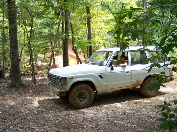

Meet Bullwinkle, getting red and muddy in Uwharrie and serving as pack mule:

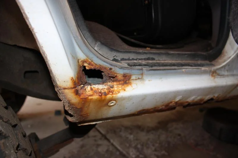

Here's a link to the OME thread once we got it to Utah, https://forum.ih8mud.com/60-series-wagons/280973-another-getting-ready-moab-thread.html. Lots of great cruiser dudes abide in Utah. You can see the awful parking lot bondo job in the rear wheel well and the rust beginning to come through, it's WAY worse than it looks. The OME has been absolutely fantastic, to abuse a cliche the ride is literally night and day. It's held up well and been tested in Moab and the mountains of Utah. I've also loved the BFG 33s, though Alaska60 is tempting me to move on up to 35s.

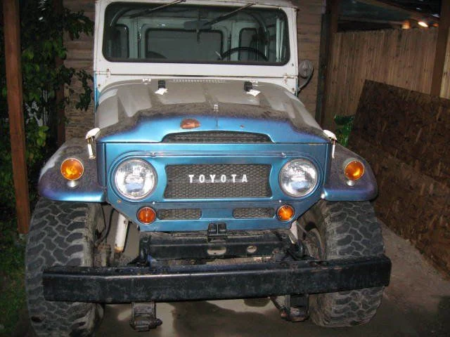

And so Rocky was reborn. This has actually been an excellent cruiser, Kurt did most of the work with his dad and swapped in a rebuilt 2f and 4 speed, body work, etc. I won't rib Kurt too much about the paint job which changes from turquoise to blue (okay...purple) in the sunlight, I actually get a TON of comments on how cool it is from my students and at random gas stations. It seems like every time I take it out and park it I come back to a note on the windshield asking if I want to sell it. Kurt sold it a decade ago, it changed hands a couple of times, and Jim of PortalTek axles bought it. He had other projects (like a SOA 60 in his driveway waiting for a 1fz) and let the 40 go, neither of us knew it was Kurt's first cruiser till later. Tom says it's the peppiest 2f he's ever driven! (well, now that it's driving that is).

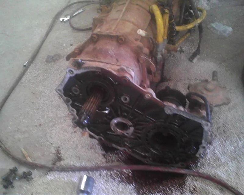

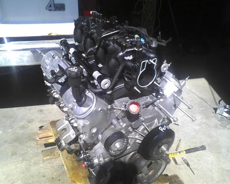

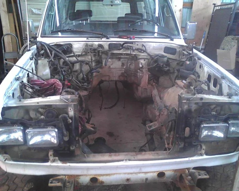

And now for the fun stuff, a low mile 5.3 Vortec ready to go. Tom is the warlock behind this witchcraft and has done amazing things. We used the 2wd 4l60e mated to a split transfer case. Rear t-case is from the 62, the front half is from a 60. We'll be able to use the mechanical 4wd linkage from the 60 mated to the rear of the 62 t-case. No more failed vac lines to worry about engaging 4wd.

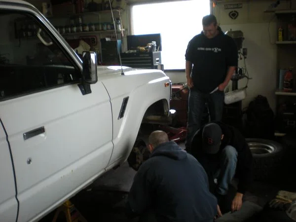

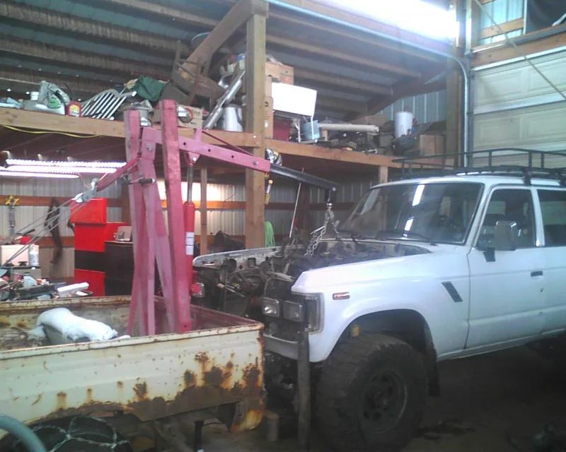

This awesome abode is uglyoinker's Cruiser Barn, home to many a lost and now found cruiser. They've got some awesome and rare 40's outside, not to mention 55's, 60's, and even an old Land Rover. Note the high-tech engine hoist fastened to a Toyota pickup with ratchet straps. It pulled the motor right out!

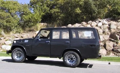

I had that rig when I met my future wife. We spent the first night of our honeymoon parked in the service drive of the Bishop, CA Chevy, Buick, Pontiac, Cadilac, Toyota dealer. It was cold and at 3 am a cop wanted to know exactly what we thought we were doing. We said, "Enjoying our honeymoon!" Seems you're supposed to tune 'em regularly--who knew? I'm pretty sure at least one of my kids was concieved in that rig. It was in that rig we courted, camped, cruised and fell in love. I loved her, but she had to go in a period of personal financial instability. The FJ55, not the wife (Whose CB handle was Silly Goose), I kept her for 33 years.
Fast forward to February 2011 and the end game of a fight with breast cancer. Unless you've been through it, you've no idea how truly crippling losing a spouse is. Shortly after that a friend had an FJ60 for sale and on a whim I bought it. So now I've got the New Goose. She's coming along. She's close enough to the Ol' 55 that all the good memories come back, and different enough that it doesn't get depressing. I'd say she's a major factor in getting me through the last year. Ahhh. . .
Here's the girls, the Grey Goose, The New Goose and the Silly Goose:

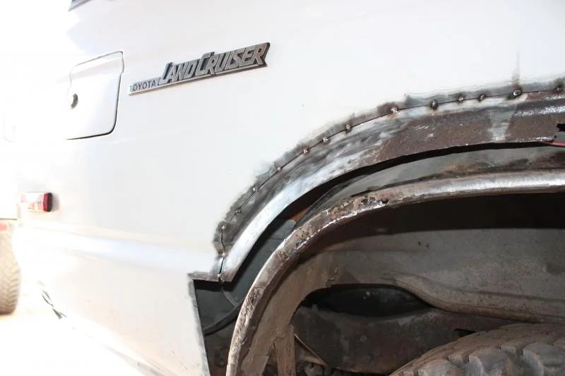

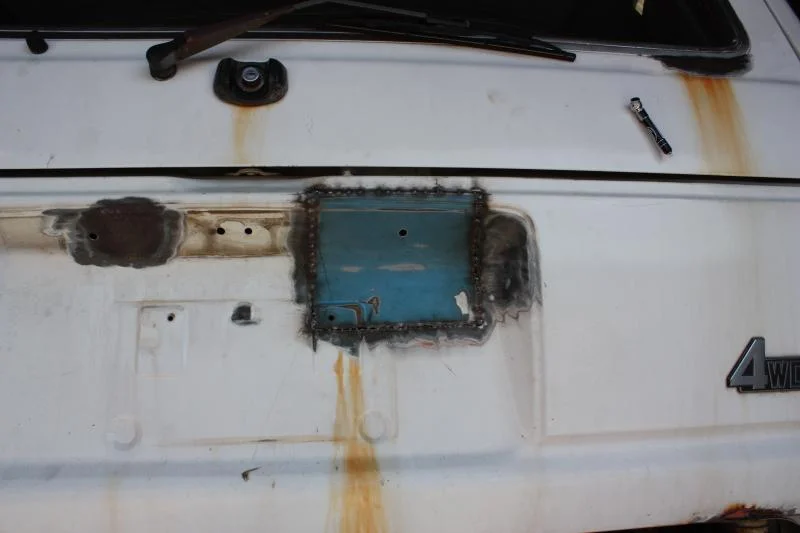

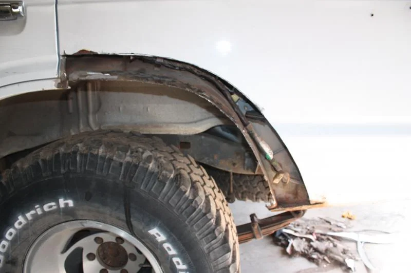

Ive been currently working on body work... Cutting a ton of rust out. reshaping rear panels and chopping off rockers and painting...good thing that adapter hasnt arrived yet...wew!

heres some shots of some rust that has been removed. All was replaced with metal.
