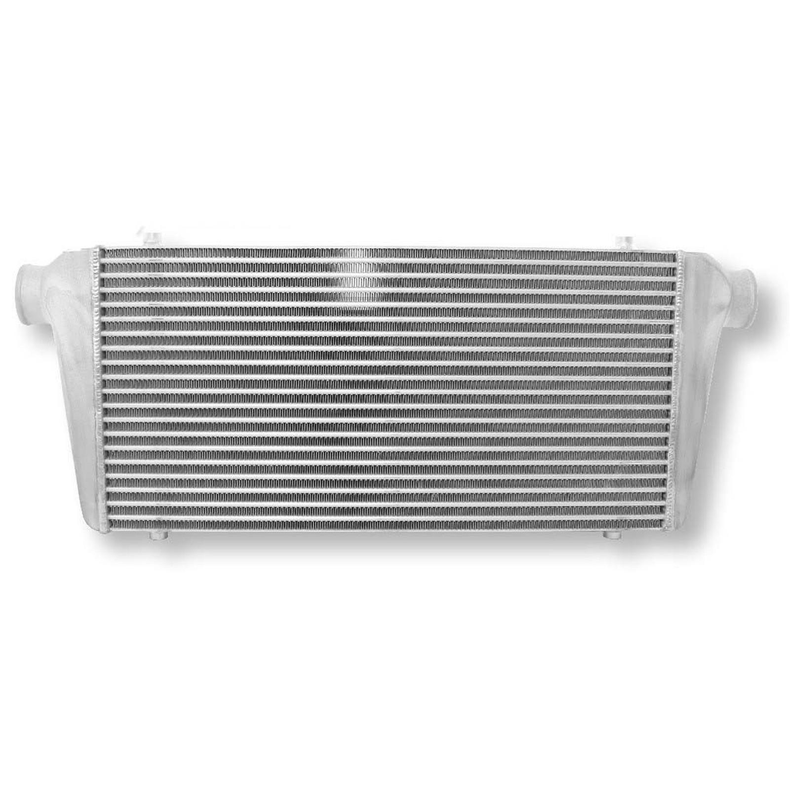

I picked that one primarily for packaging reasons as I had planned to have it out in front of the rad support originally. I also didn’t want to go too big and make it laggy and for the power I’m shooting for 2.5” pipe would be more than adequate.
Additionally, many of the intercoolers I found had pretty low pressure ratings so it’s worth it to check that before buying.
