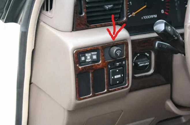

Japanese Aux/Fog light switch
P/N 84160-28010
Toyota had this type (see attached pics) of fog switch on both LC80 (for JDM 80 with built-in and aux. fog lights, and Surf/4Runner).
I "think" it allows you to have two sets of lights come on with the marker/headlights.
But you can use only one set of fog/aux. lights at a time and not both on simultaneously(sp.)

Cool switch. I've never seen the JDM foggy with the headlights before. Thanks for that!

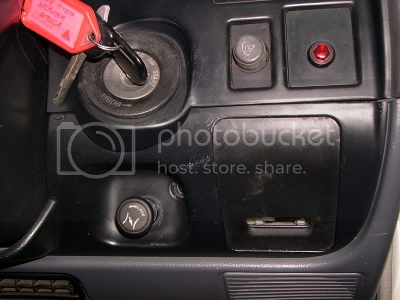

My 81 has a factory JDM fog light switch that looks identical to the rear defog or CDL switch. It is to the right of the wheel (RHD) beside the headlight washer switch. Will post pic. tomorrow.

Sorry for the delay... Here is my stock JDM foggy switch... Outboard of headlight washer and above mirror retract buttton (hehe!)
(My truck is actually quite clean!)
