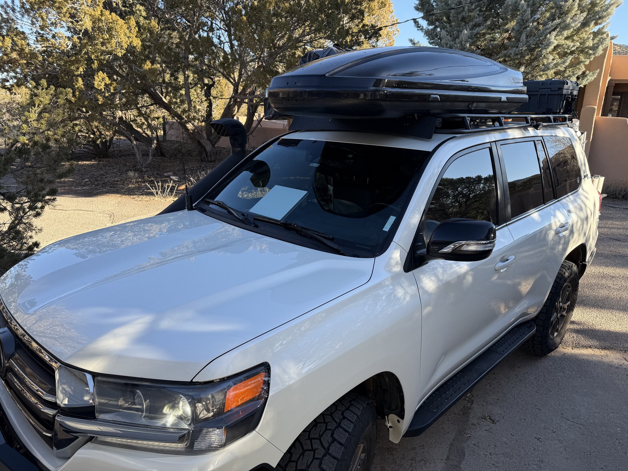

I’ve had the Roam since February, and it’s mounted using the mounting kit from Roam. The one I just added is a much larger Thule. Will take daytime pics soon, but here’s one I snapped tonight as I get her loaded up
Ohhh sick! Isn’t the roam mounting kits for 80/20? Or how are you doing that?
And thanks, would love to see the Thule setup too. Looking to do both as well!
