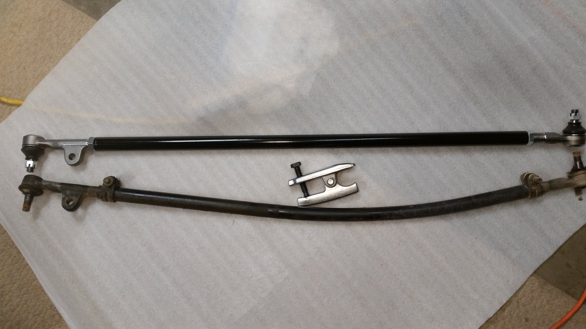

Just installed the @Marlin Crawler HD steering kit. They were easy to work with, shipped super fast, packaged bomb proof, and had everything needed.
The quality is awesome.
The install was cake with a pickle fork and a 5 lb Sledge. It went way faster than I thought It would, Let's say 1.5 banana :banana:.
Tools
Pickle fork
5 lbs stubby sludge
19 mm deep socket
Wire cutter dikes
3/8 ratchet
Large adjustable wrench
Blue Loctite 242 Optional
Strap wrench
Just make sure you
*Center the tie rods on the Dom steel bars best you can.
*Match the length of your old steering linkage.
*Use a strap wrench when tightening the retaining nuts to make sure the tie rod boots are centered and not angled extremely when installed, levelish.
*check the holes on the vehicle for the tire rods for any birs or imperfections, so as to not tear up the boot.
@marl
I run the Marlin upgraded drag link & tie rod.
MBR sure to paint the bar & the tie rod ends. Otherwise the the ends rust.
Thanks I was thinking about that, I thought man you should have these powder coated didn't even think about it.
I'm in California we don't get my rust here, maybe I'll rub them down with a little oil every oil change.
Any suggestions with them already installed?
@marl
Black spray paint, if it’s still legal there.
Are the tie rods just the stock 80 series ones ?
The 555 brand tie rods provided looked to be much larger diameter they were all so much heavier than stock as well as the securing is not a pinch clamp. The HD kit threads in to the d o m steel with a lock nut to secure it.
