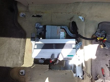

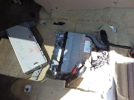

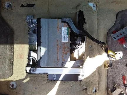

Glad you got it squared away. I've contacted United about my changer and will getting around to figuring out how to remove it in the next couple days. For today, the project was to get the amp installed properly; just got the car yesterday and the dealer just left it on the floor behind the seat 'cause he couldn't figure it out. Since I couldn't find any pics anywhere, I snapped a couple once I figured it out and have attached them in case they're useful to anyone else. Fletch.. you're amazing if you got that amp out and back in w/out removing the nav dvd player.. kudos. I took the whole seat out and the nav box... there's no way I could have figured it out blind w/out seeing how it was originally installed. Maybe these pics will save someone a little time and grief!
I just opened up the carpet a little more with a box cutter to maneuver the amp in and out. But I had the benefit of seeing how it was originally installed and how the bolt holes in the brackets are supposed to line up. A new install would have been a different story!
