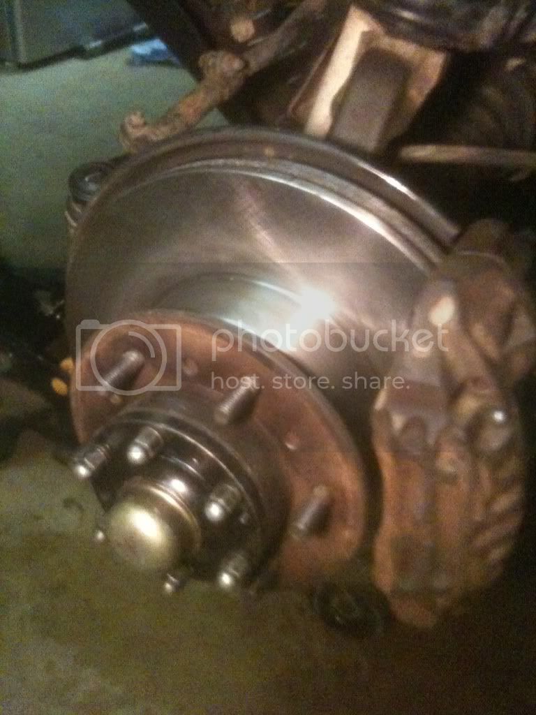

Put new pads and rotors on my 4Runner today. Also traded in my FJ62 calipers for V6 IFS Reman'd calipers to put on my straight axle... 104 bucks for calipers, cant complain! O'reily will never know :D

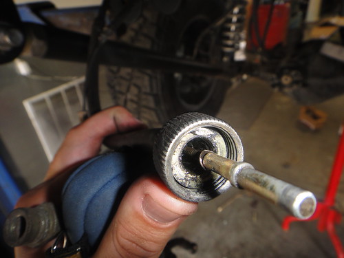

I forget whether or not you have a cable driven or electric speedo output, if cable like mine is you'll also want to loosen the speedo cable from the output and the retaining brackets as it will loose it's slack. I routed mine around the brake cable bracket and cross brace to get a cleaner line.

Not sure I believe my speedo is electronic. easy way to tell?

Crawl under and if your speedo looks like this but with a swedge face on the end it's cable driven.
