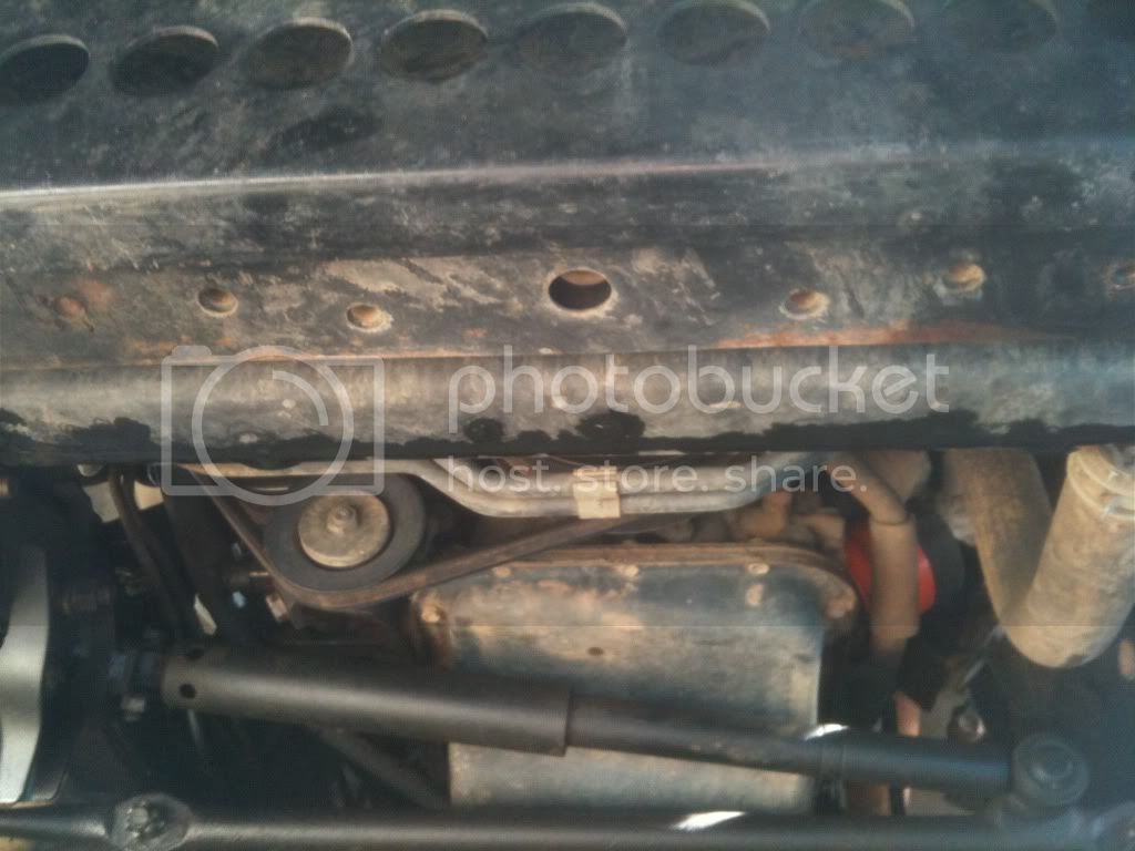

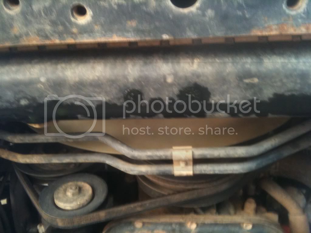

How much room do you think you will have after SAS? Oil pan is looking like it may be getting a little claustrophobic.
Everything should clear just fine. Im going to move the steering box 1 or 1.5" forward. and possibly change the pitman arm. 3vzs normally dont have clearance issues... 3.4s usually do.
