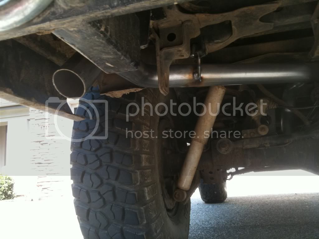

I smashed my exhaust at the latest wheeling trip, So I modded it to be a bit more clearance. Got the idea from a stock FJ80 exhaust

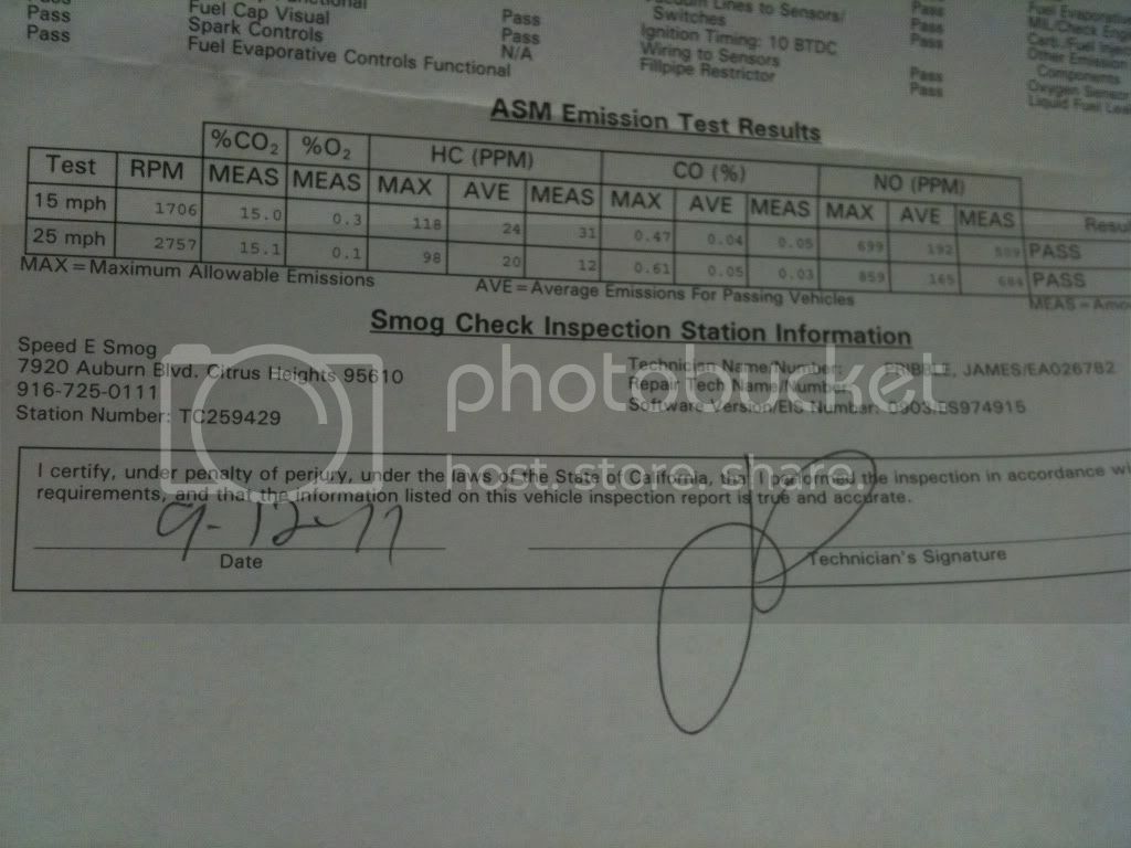

and with that being done, I also put the stock catalytic converter back in after being illegal for 2 1/2 years. just popped the original catalytic converter back in, took it to the referee and bam!

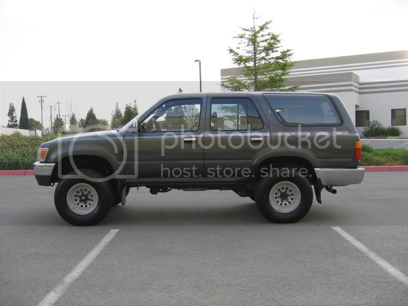

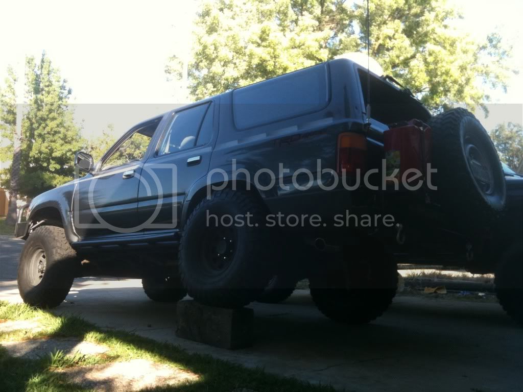

Got the trasharoo and coil spacers yesterday. I love it when brown and blue santa visit me :)

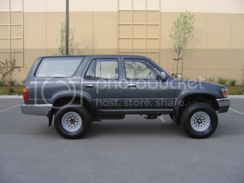

Coil spacers are going in over the weekend. Hopefully those 2" are enough to make it level out.
More pictures of the stance with the coil spacers in.

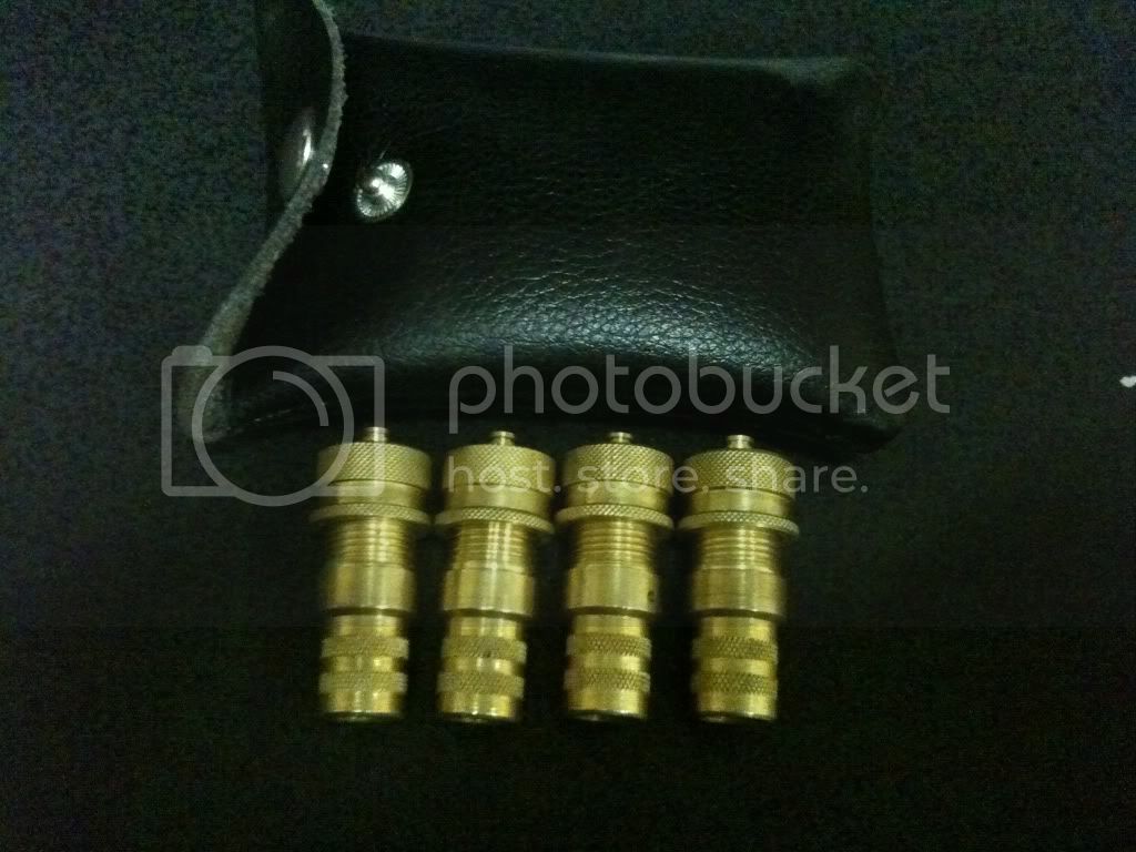

and I got my Tire Deflators dialed in and ready for pismo!

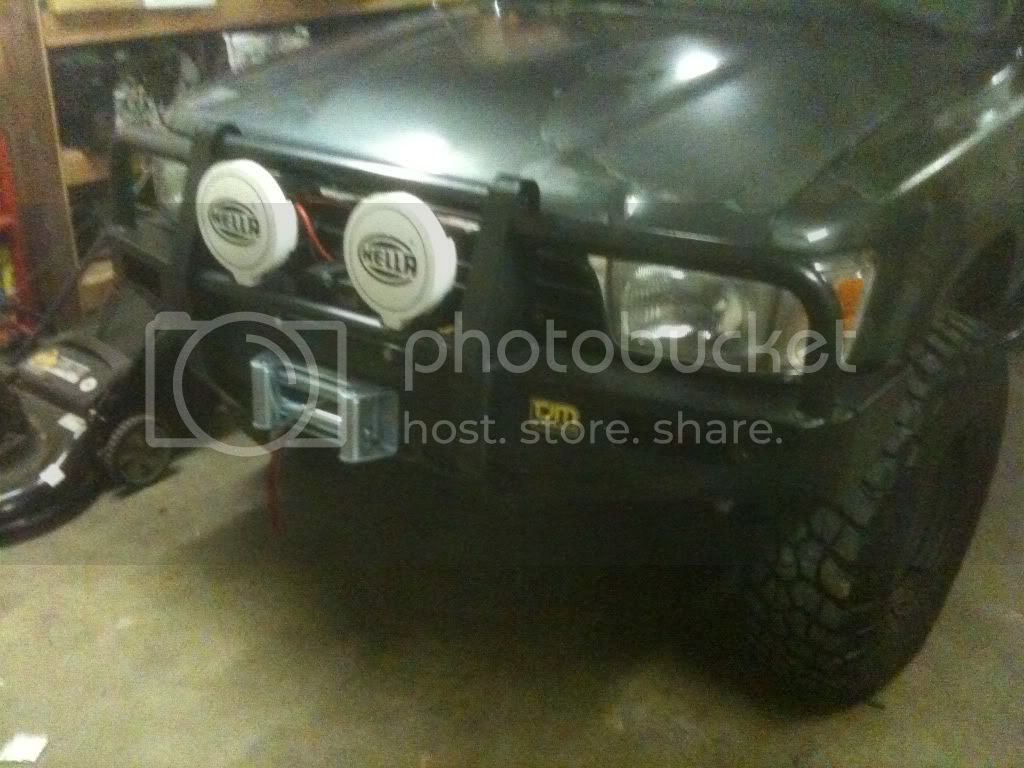

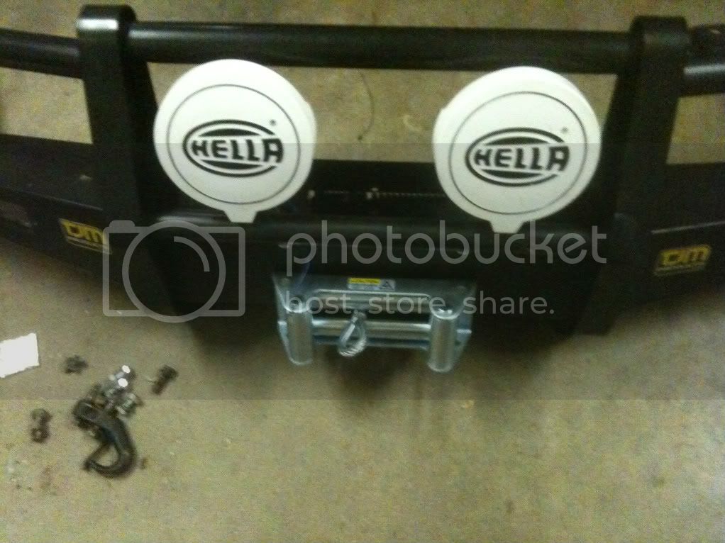

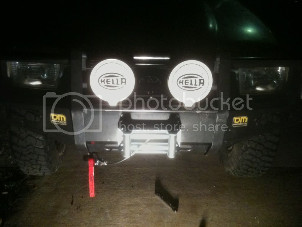

So i recently acquired a Fj62 axle, LC coils, a winch, and a FJ60 rebuild axle kit. I'll be having a baby cruiser soon enough!

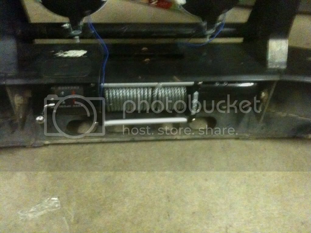

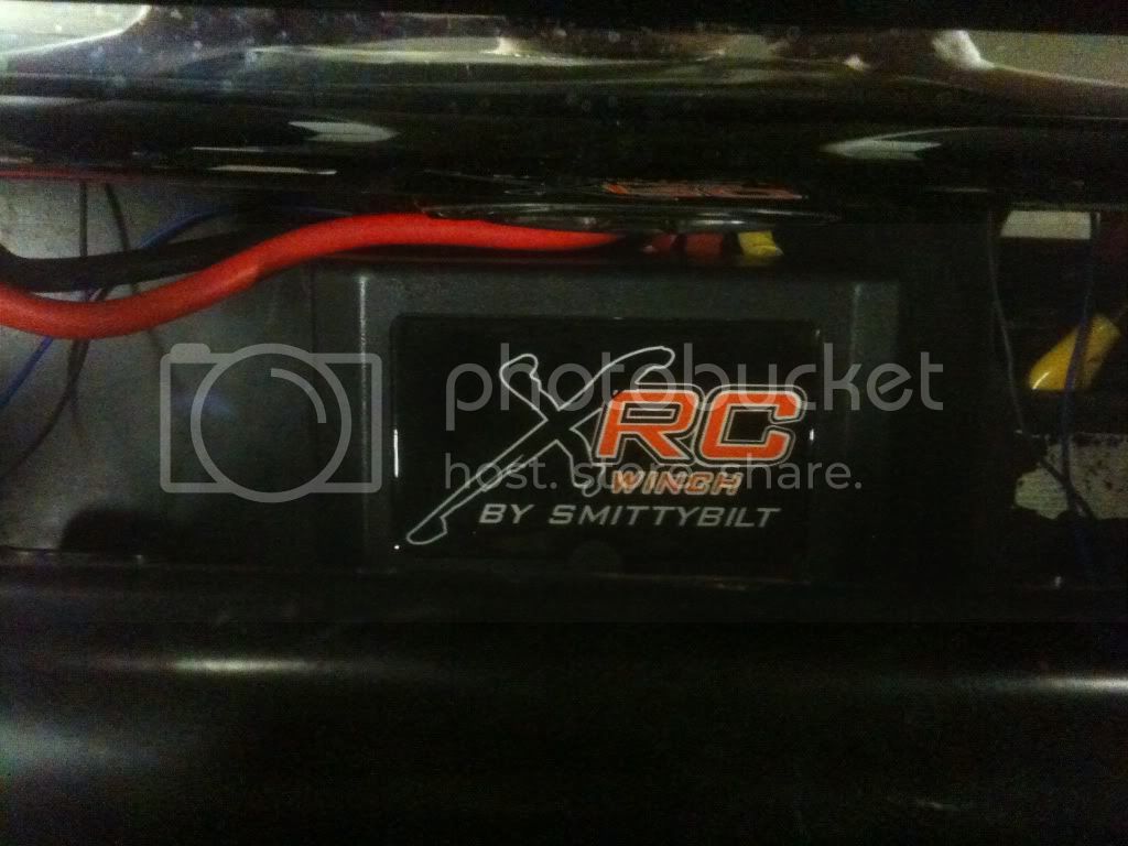

Installed my winch last night!
