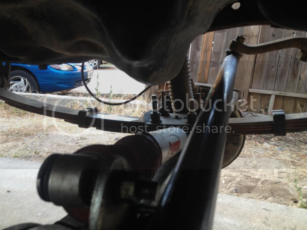

Lowering my truck down is going to require me to relocate the steering stabilizer and get a different oil pan from a 2wd 3vz ( rear sump )
Here's a picture of the steering stabilizer issue. if I pulled a leaf spring in the front, which I plan to do. it would basically bottom out on the oil pan over every obstacle. currently, theres about 2-3" from the pan, which still sucks. So I'm going to fab up some new brackets, cut the ones off my axle and put them on the passenger frame rail and route the stabilizer to my steering arm, not the drag link.
Top part of the steering stabilizer w/ a dent in it.
bottom part of the oil pan with a mark on it.

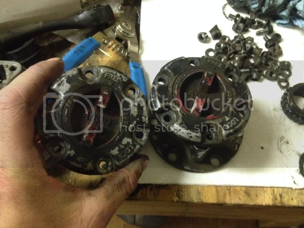

since the truck is up on jackstands till I get my wheels/tires. decided to restore and rebuild my manual hubs.:
Here's the before. they're currently sitting in alcohol in an empty paint can. should be done by Saturday, completely painted and reinstalled.

I can officially drive the truck now. For some reason, when I installed my hubs back on they were clicking, almost like they weren't disengaging from the hub correctly. after pulling them, tearing them down and putting them back together I was about ready to just give up. worked on them from 8:30pm to about 11:30 pm last night and after thoroughly inspecting everything. The damn spring on the paw/gear wasn't wrapped around the groove of the gear correctly, not allowing for the hub to disconnect completely, thus making a loud clicking noise past 30 mph.
anywho, got it working. drove the truck to work today. cruises at 80 mph with no shakes ( wonderful going from unbalanced tires to balanced tires. )
