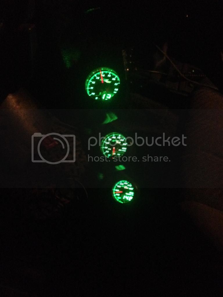

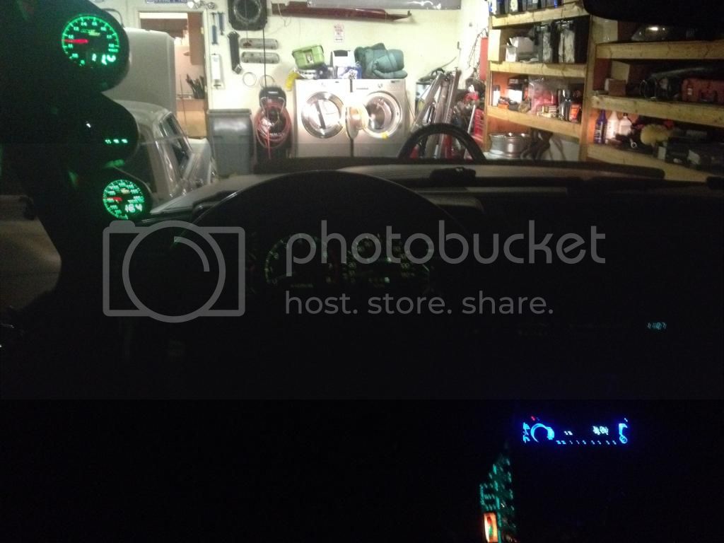

Shot of my interior at night ( climate control lights are getting a little tired, might be time to replace them with LEDs ):

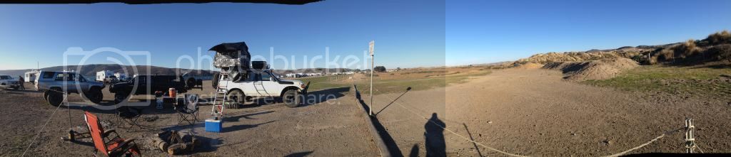

Shot of camp and the area:
All in all, not a bad trip. 270ish miles. No wheeling, just driving around most of the time.

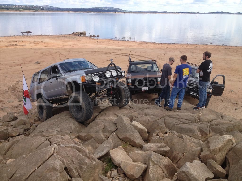

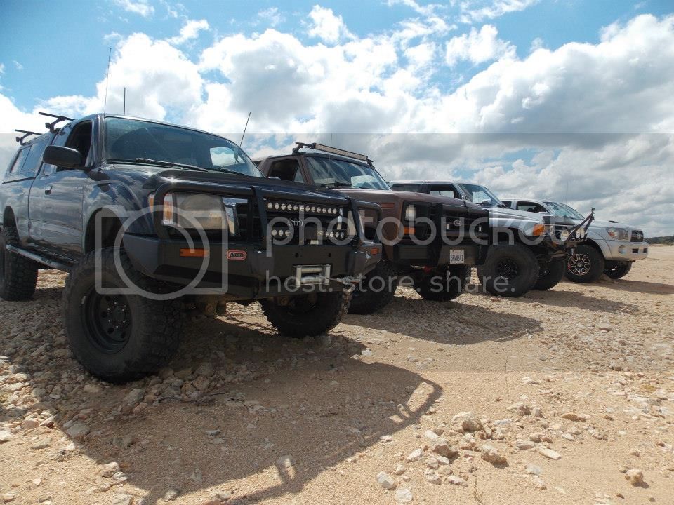

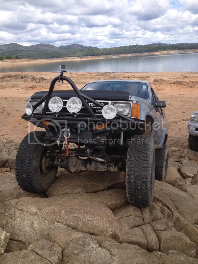

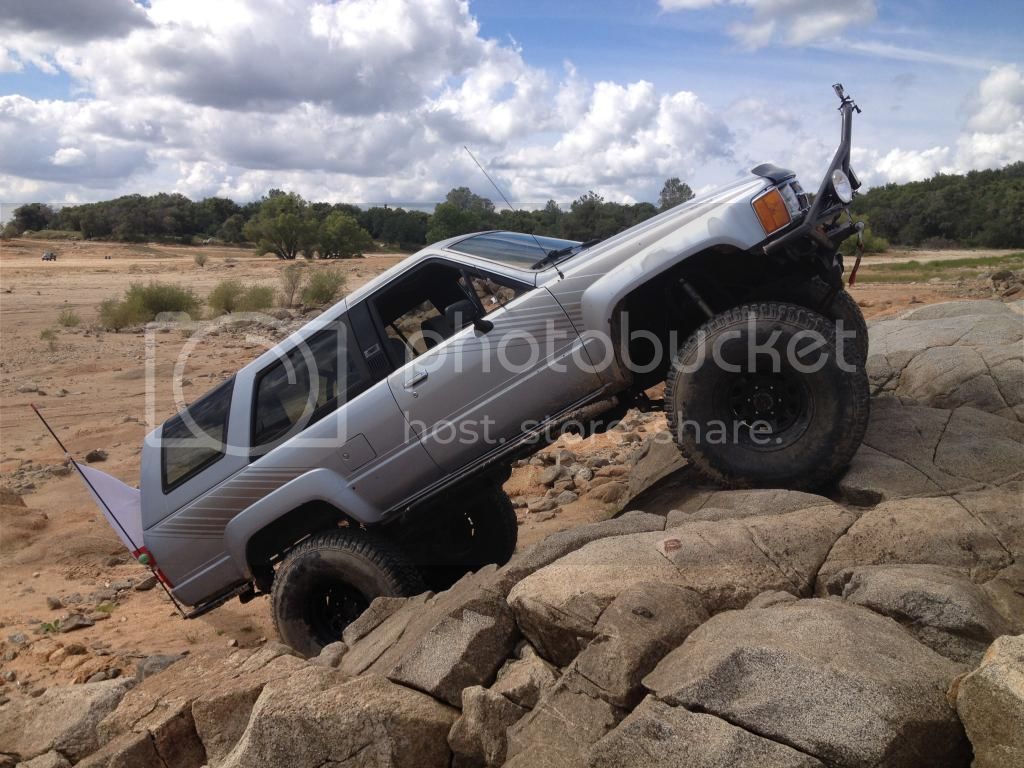

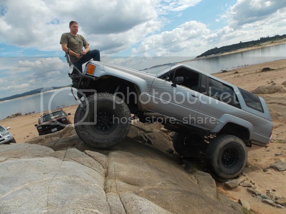

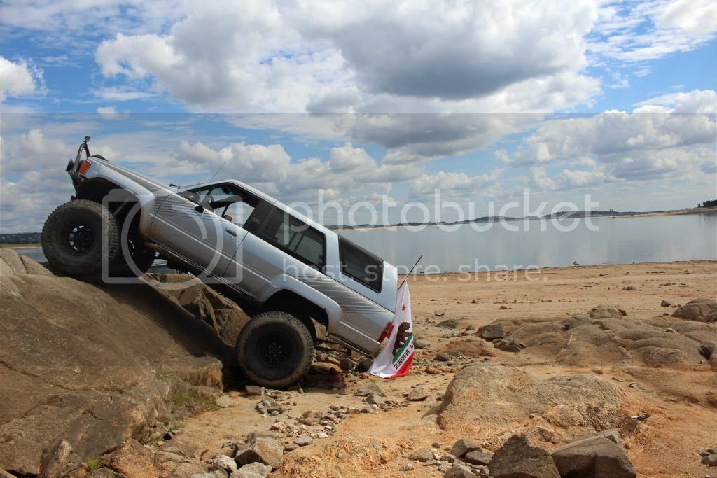

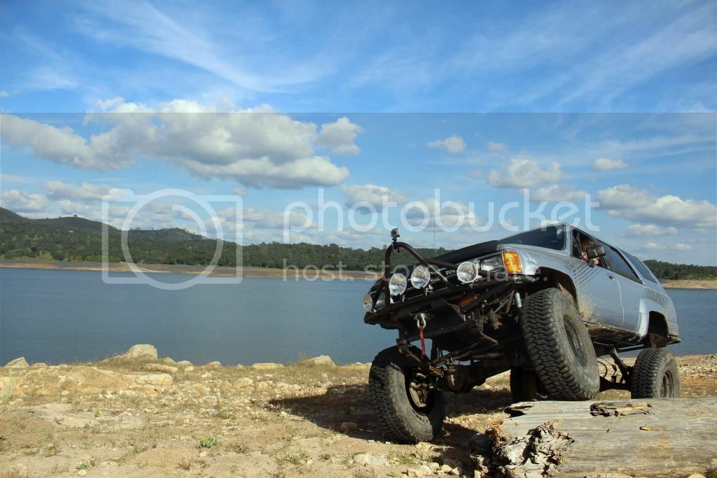

I recently installed lift kits on a friend's FS Bronco and a 2011 Tacoma, and they wanted to break it in it a little, so with a new top end on the 4Runner, we made a quick day trip to folsom lake. with the water level low, it makes a good place for some wheeling, but while we were out there, we were asked to not climb around on the rocks and such since everything is protected. It made for some good photo opportunities until the Ranger asked politely for us to get down.
Group shot:

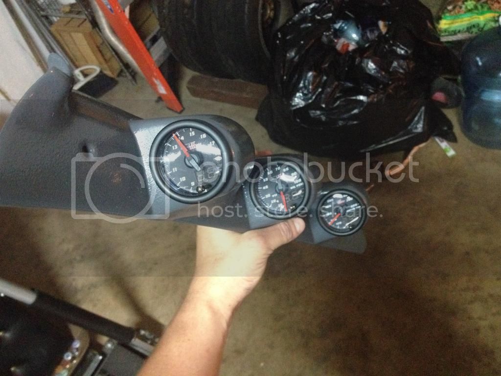

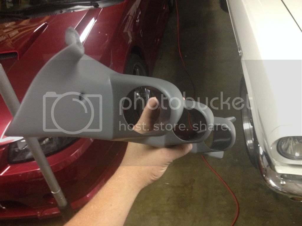

After my headgasket blew in this truck, I decided I wanted to keep a closer eye on things. The temperature gauge has been getting extremely tired lately. Right when I start my truck up in the morning the gauge just goes to half instantly, and after a few seconds it drops to cold, and then after 3 seconds goes back to half again. So rather than deal with that, I decided to just put my own gauge in. Ordered the pod, 3 gauges ( oil pressure, volts and water temperature ) and slapped them in. I went with volts because my truck is originally an automatic.

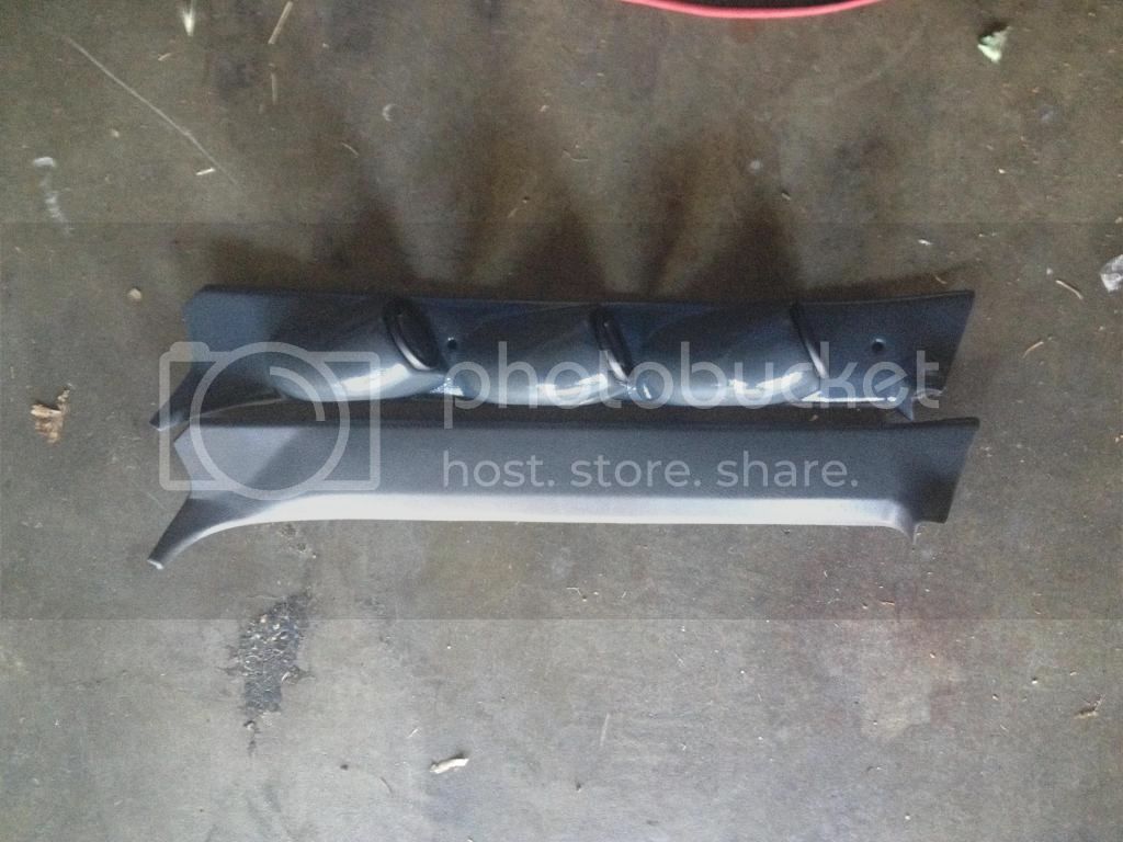

Anyway, Ordered the gauge pod gray, but it was more of a silver color so I made a trip to home depot for the closest match. its a glossy gray, but its the closest I could get. I have no complaints, you can barely tell the difference inside the truck.
Pre paint:
After paint w/ gauges installed:
interior panel pulled next to new panel with gauges:

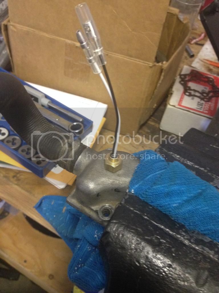

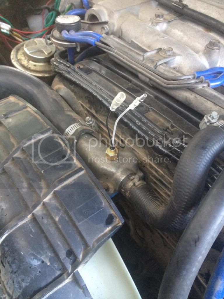

Drilled & tapped 1/8 sender into the upper radiator hose neck and wrapped the threads with Teflon tape:
installed the modified neck w/ sender:

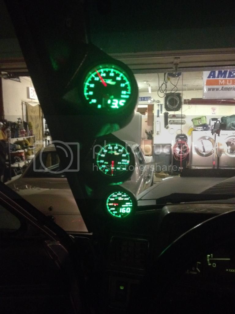

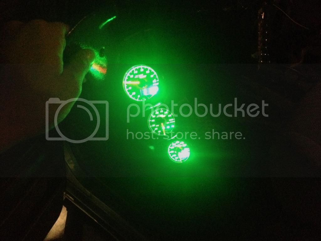

gauges wired up and installed. This is before I modified the brightness on the gauge:
This is after the brightness has been modified:
Here's the pod installed:
picture of the whole interior and how the gauges face me:
Here's a quick video of how the gauges work. They're wired into my headlight switch. the analog needle works as intended, but the gauges don't light up unless the running lights are on. The oil pressure gauge is currently not hooked up because I still need to get a T fitting to mate the stock oil pressure sender and add the new one. So yes, it flashes letting me know the gauge isn't working correctly.
All in all, its definitely a great setup, definitely a must for ANY 3vz owner. The gauge pod was an exact copy of the stock pillar interior trim piece. The bottom two gauges are extremely easy to see, but the top one ( where I mounted my volt gauge ) I cant really see the digital number on the gauge, but I can read the needle no problem. But then again, its volts... who cares. lol

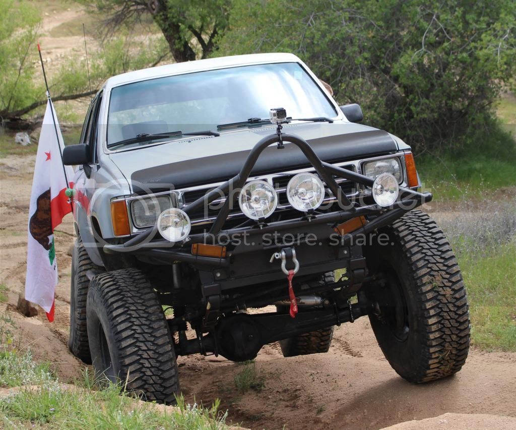

I feel like the truck would be a lot more stable on a 10" wide rim. I borrowed 93yotaSR5's 345s off his 80 when I first bought the truck. and I must say, that setup looked amazing on the truck. Here's a picture of it.
Nice truck! I miss having a first gen Runner.. I had to much fun in my '86..
