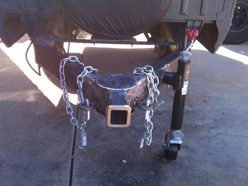

First things first. It needed a multi-axis coupler for full articulation offroad. I ordered one from Adventure Trailers. Multi-Axis Couplers by Adventure Trailers
It also needed a receiver tube, drop leg and safety chains.

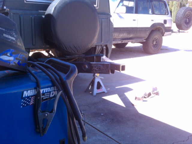

I broke out the torch, grinder, welder and some scrap plate I had around and went to work today.
This is what I started with.
Then

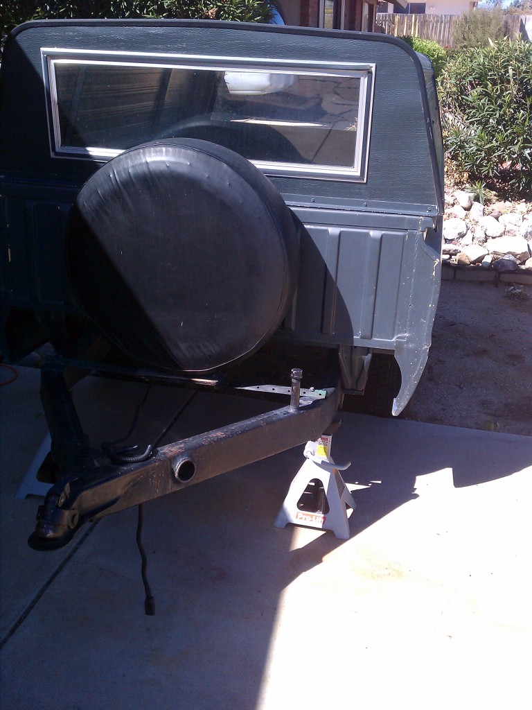

So, working on the trailer today I had a chance to better inspect the underside. There is some rust, just surface stuff, nothing major.
What I did notice, however, is that the bed and frame do not go together. The bed is mounted with some homemade gussets and it is wider than the frame. This isn't a big deal, but may change my suspension plans a little.
It has an axle under there, pumpkin and all, and I thought it was an old mini axle, now, not sure. My plan was to get some mini lift springs from Kurt and drop some 33's under the trailer. Now, I may get a trailer axle and hubs from a local joint. I may lift the bed from the frame a bit and see if I can squeeze some 35's under it. Might require some cutting.

i think the a frame pieces are part of the old frame and those flared holes pointing out used to point in and are what's left of a round tranny brace cross member.
if so i see an absence of toyota holes and the whole thing looks pretty beefy. is that two c channel frames welded together and have the holes been welded up?
It's boxed frame all the way back. It was cut/folded to make the A. It is smaller at the back end. I'll have to get a pic of the way the bed is mounted. It may or may not be a Toy frame and axle. Either way, it will work for me, I just may need to make more custom stuff when I get to the suspension/axle. Once I get past that part, I will take the bed off, clean it all up and have it blasted and powder coated.

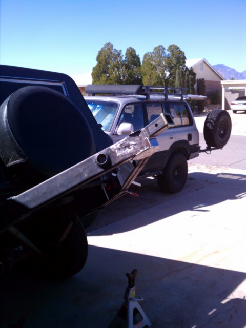

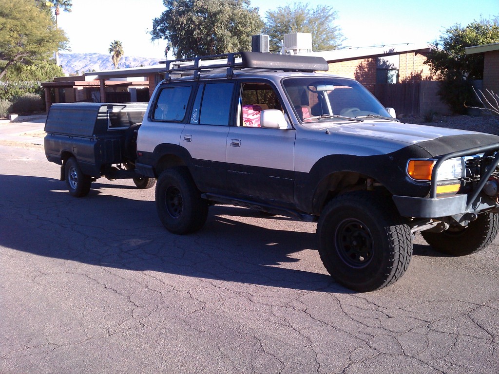

Since you have a receiver on your trailer, you might find an extension bar to be of use. The reason is that your trailer is compromised by the A frame in front that in tight turns, particularly with any articulation, may allow the trailer bed to strike the tow vehicle body.
This is an extension bar I made to allow the trailer to tuck up close, or move it back for more clearance. An extension bar can also come in handy for overly long cargo, like canoes, rafts, long posts, etc.
No extension bar.
Extension bar shortened.
Extension bar full length.
And you've backed the truck to the point of jackknifing to know what the limit on cornering is? Because at some point on the trail you'll wind up in a less than ideal spot requiring you to back up with space being limited.
This one, not yet, but I've had an offroad trailer before. I could kick the old one nearly 90˚ with no extension. This trailer will have more room.
No extension bar.
Great idea.
