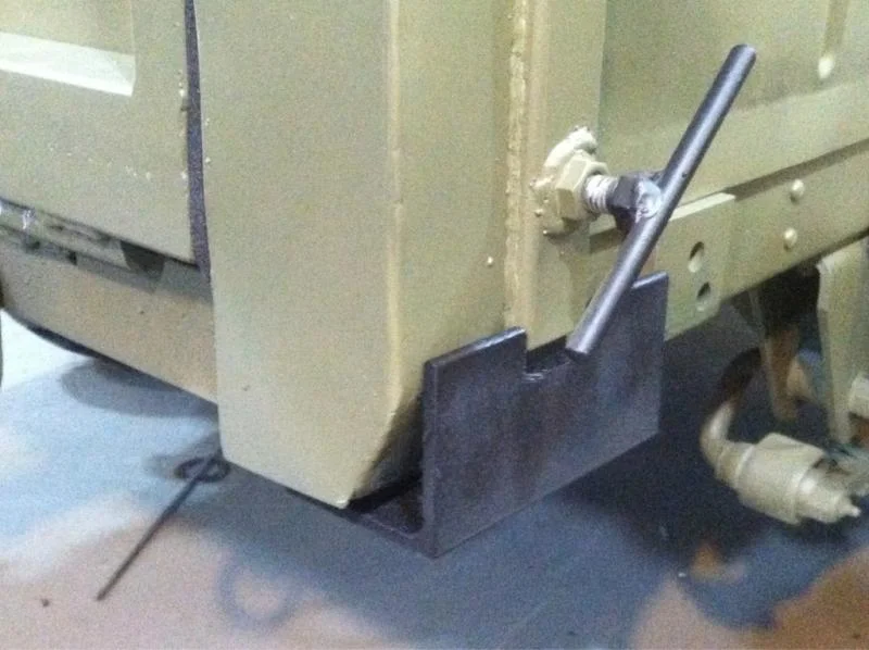

Is this some sort of kickstand that drops down?

Had a few questions on this trailer I'd thought I'd post up.
Latches were from McMaster Carr. http://www.mcmaster.com/#13835a87/=og2lk3
Hinges were from ebay.
Like these. I bought two styles one aluminum and one steel and mix matched them for the steel tub and aluminum top.
http://www.ebay.com/sch/i.html?_trk...+hinges&_nkw=bullet+hinges&_sacat=0&_from=R40
D rings were from northern tool.
Struts were from McMaster Carr. 28" 250lb
Latches for inside the tailgate were from an S-10 pickup.
Top weighs maybe 70-80 lbs and could probably handle a party up there. .090 aluminum and 1x1x.125 tube
