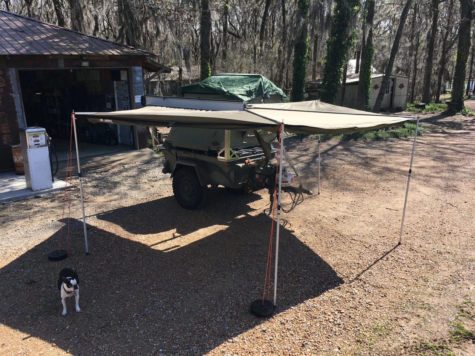

This build won't end-up simple. You'll go all-in...probably with a high-rise mount for your awning so that you can pull the 416 with all of your Cruisers (which will likely include a 40 and a 55 by the time this build finishes).
And the width. And the expense of adapters or changing out the perfectly good M416 stuff. I love the weight and size of this trailer. Anything bigger I could not manhandle around.

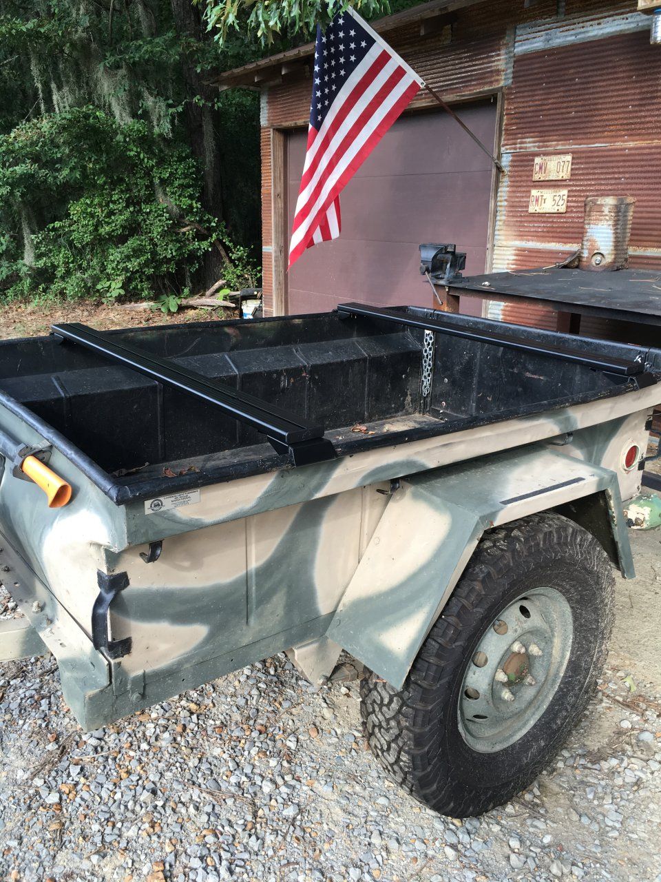

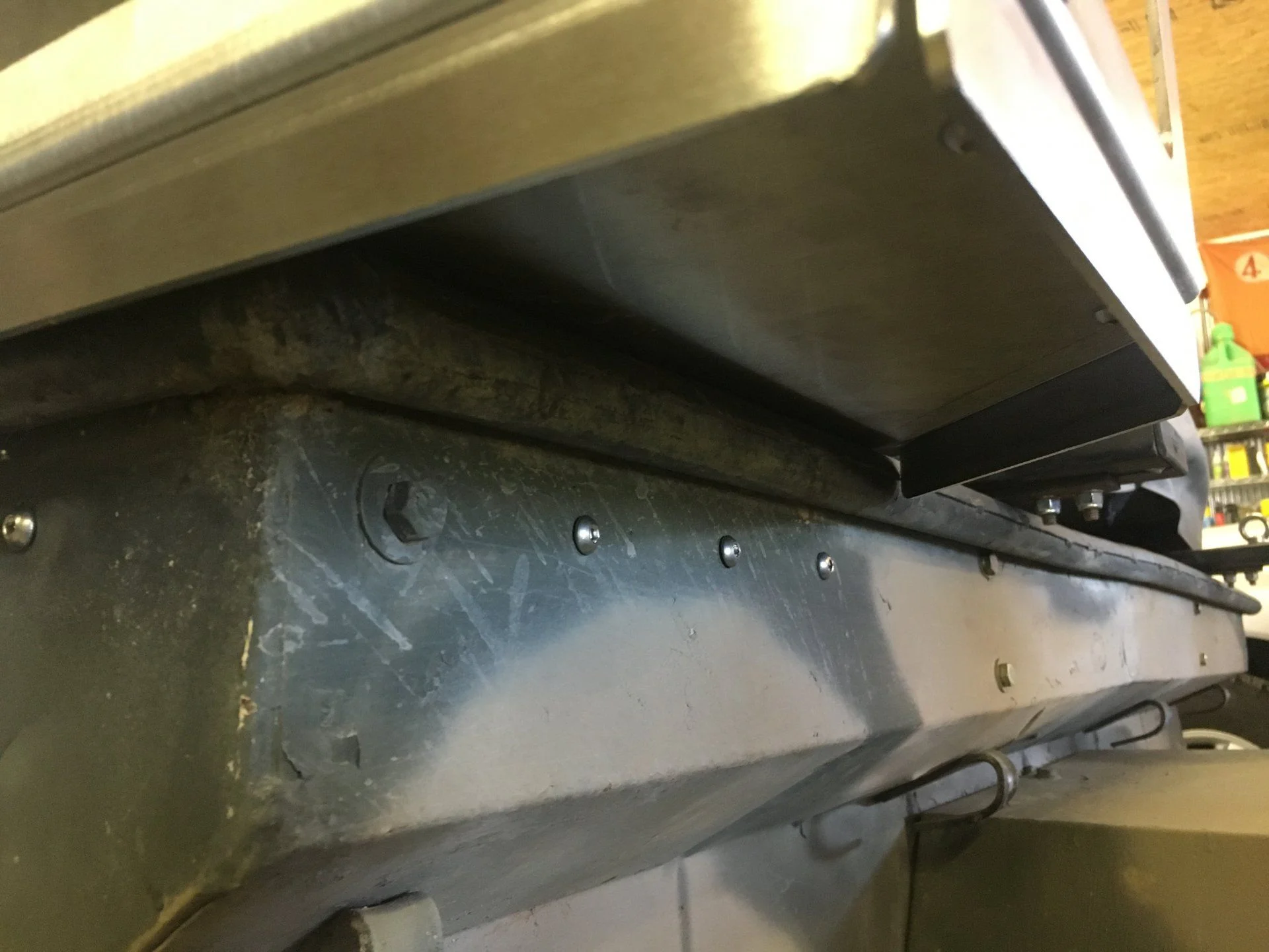

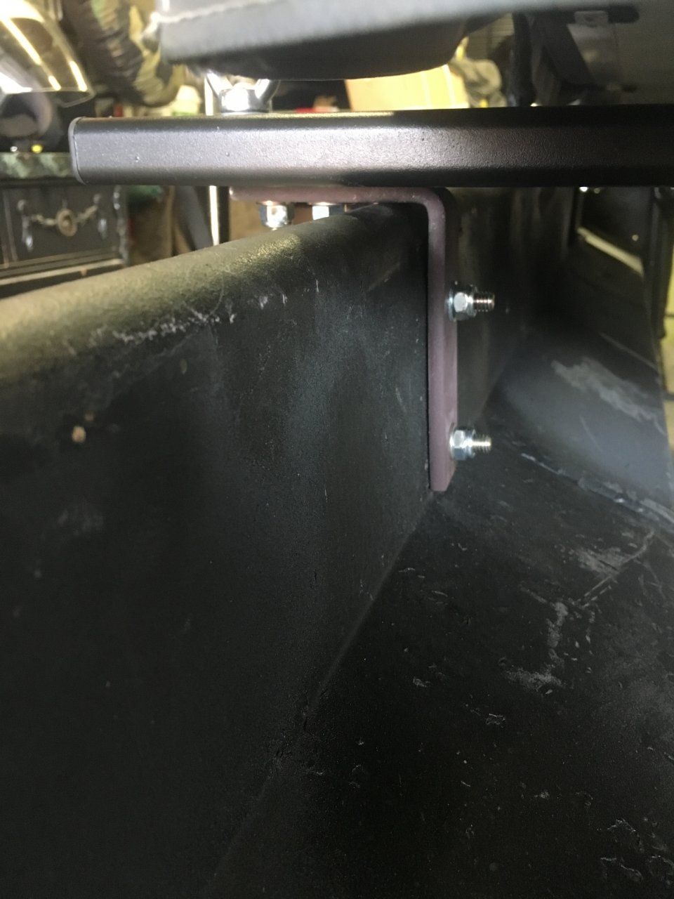

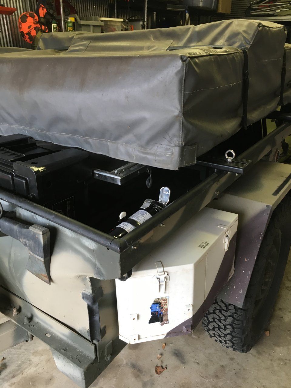

Added a 1255mm set of FrontRunner rails to replace the Yakima.

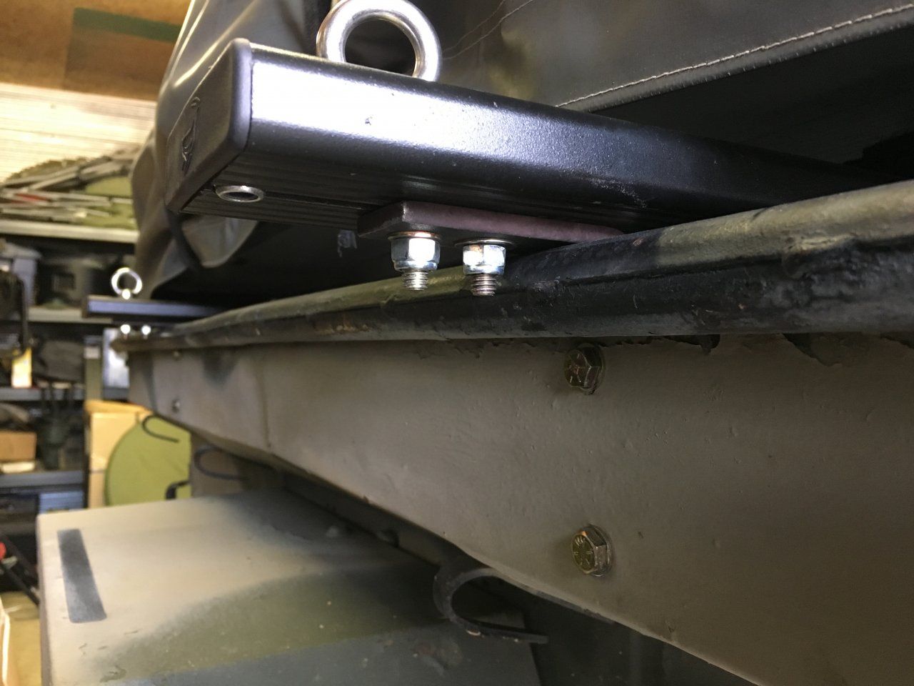

I decided to make my FrontRunner bars a solid mount after the trip to Arkansas last month. I love the FrontRunner bars but the clamps are designed for thick OEM roof rails so they didn't grip the tiny 1" tube rail as good as I hoped.
This will take the same amount of time to remove as the other. 8 nuts and it's off. Super solid.
img_1578-jpg.1367939
img_1579-jpg.1367940

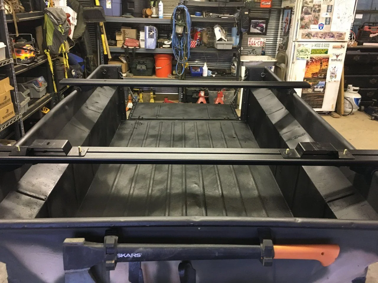

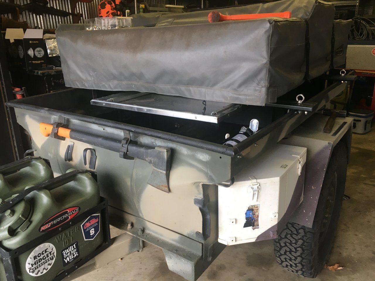

The Beaver Box slides under the tent but won't go past the crossbar so it's in a solid spot with no real need for straps but I keep one back there if for some reason the tailgate was to open
img_1580-jpg.1367942
All ready. The FrontRunner wolf packs slide in the front gap so I can take in and out without unloading all the kitchen stuff
img_1581-jpg.1367943
The FrontRunner stainless table slides under the bars on a tray they sell
img_1577-jpg.1367944

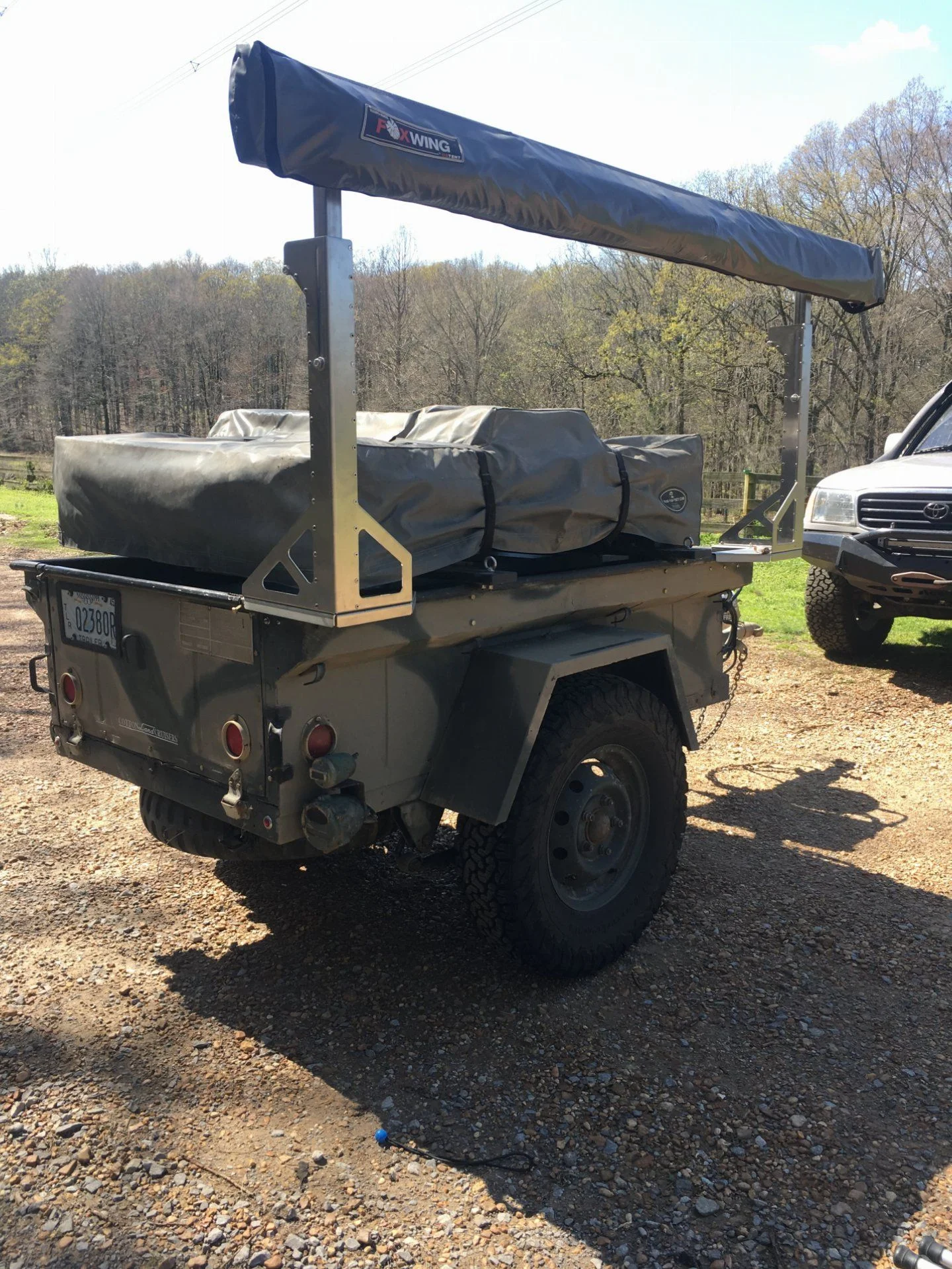

As for a trailer update.

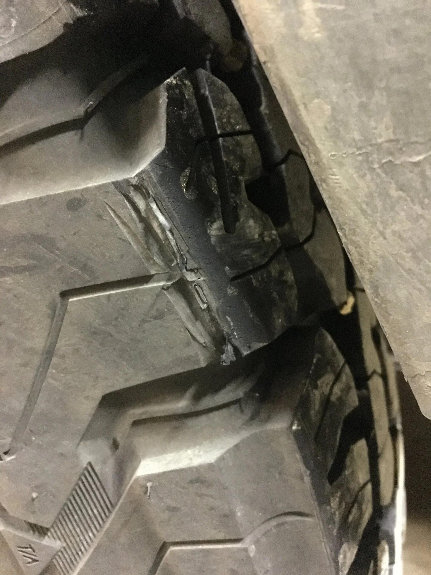

My trailer tires did finally do some rubbing on the close fenders but I also had a s*** ton of weight on the trailer with two rows of greenish Hickory and Oak plus all my #eaf gear on a 2490 mile trip with major off reading.

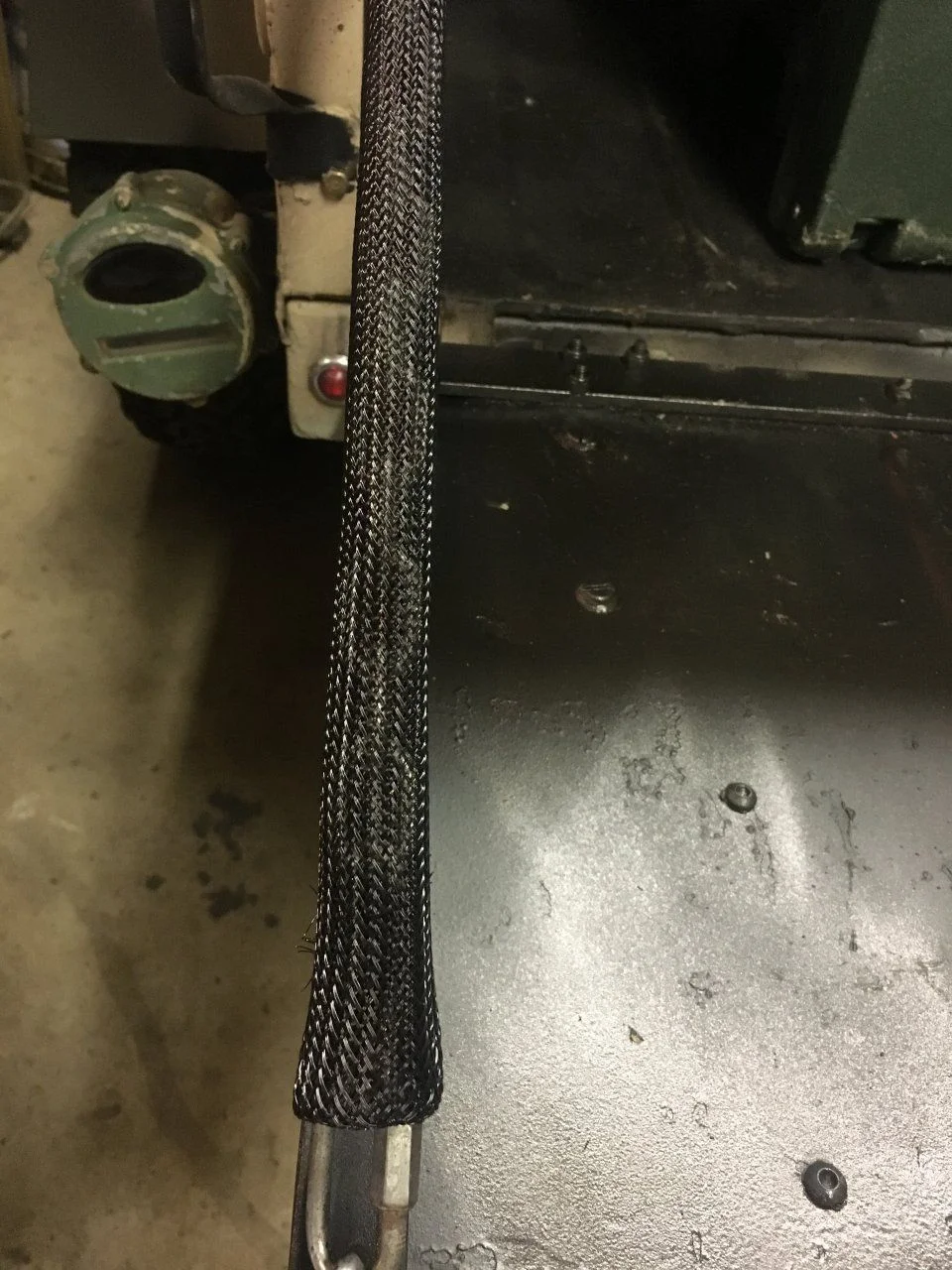

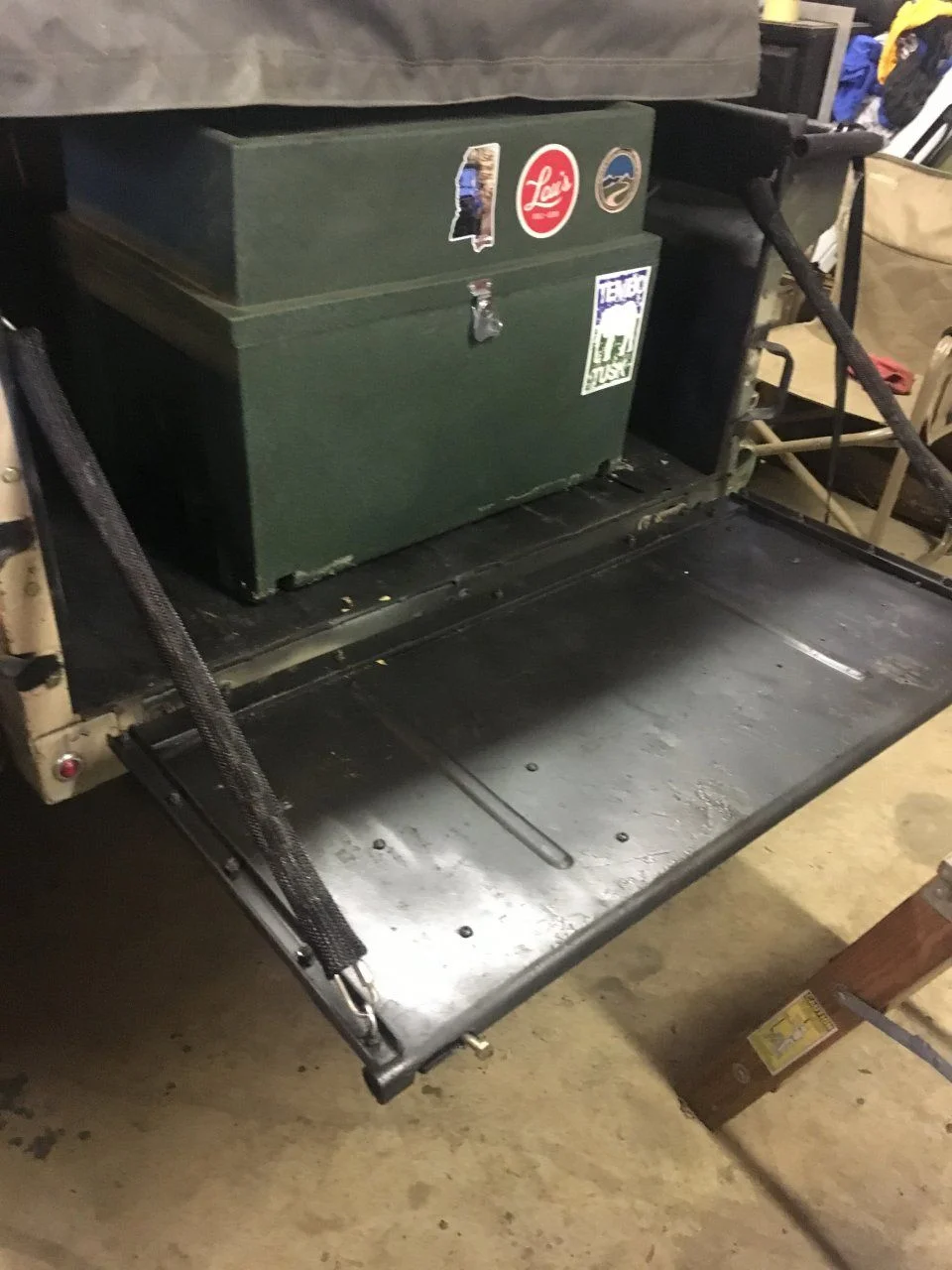

Also when you cut a tailgate into it you may experience some box integrity issues.
Two in my group (out of 4) had the rear corners spread. This effects the way my tailgate latches. Because of the way my kitchen box fits I can't weld a solid bar across to tighten it up and a skratchet was not strong enough.
I got some slick clips today at Revell Ace and have a ratchet back there that will do the job.
img_2827-jpg.1384702
img_2828-jpg.1384703

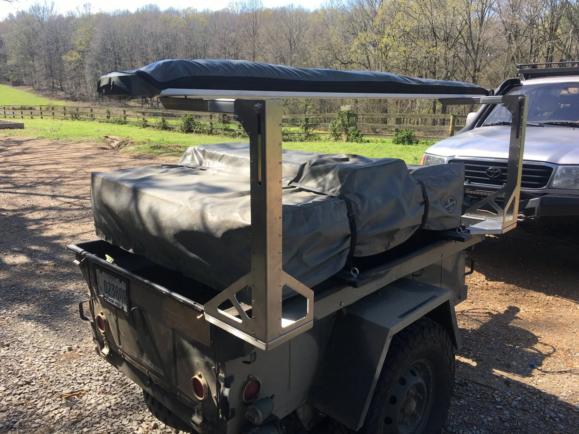

I still prefer the low COG of the tent direct on the rails and with that a tailgate is mandatory.
One guy that cut his tailgate with us has not had the problem and Another that built his trailer with a frame that raises the tent made it where a tailgate is unnecessary
It barely moved the springs. It felt the same going home with it in there as it did empty going up
As for the spare, it's a 100 series tire winch that is directly bolted to the C channel cross member and then I have a ratchet strap under there to keep it tight. So far it hasn't budged.
Balance. I ran it empty up there. No fishtail at all.
That said, I extended the tongue 8" and I run an 8" 3" hitch extension. The tongue for backing and storage and the 8" receiver extension to allow me to open the swingout with the trailer attached.
I'm putting some bigger tires on it today. I tried them on with the weight of the motor in there and had no clearance issues.
