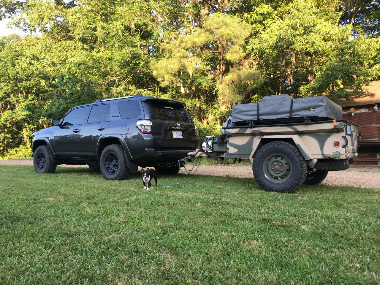

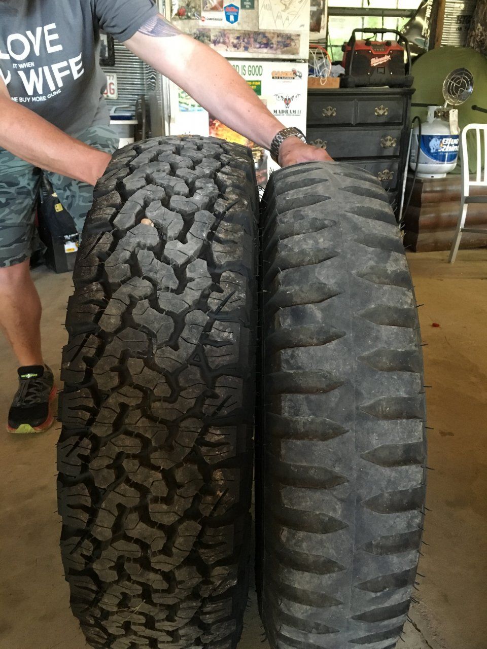

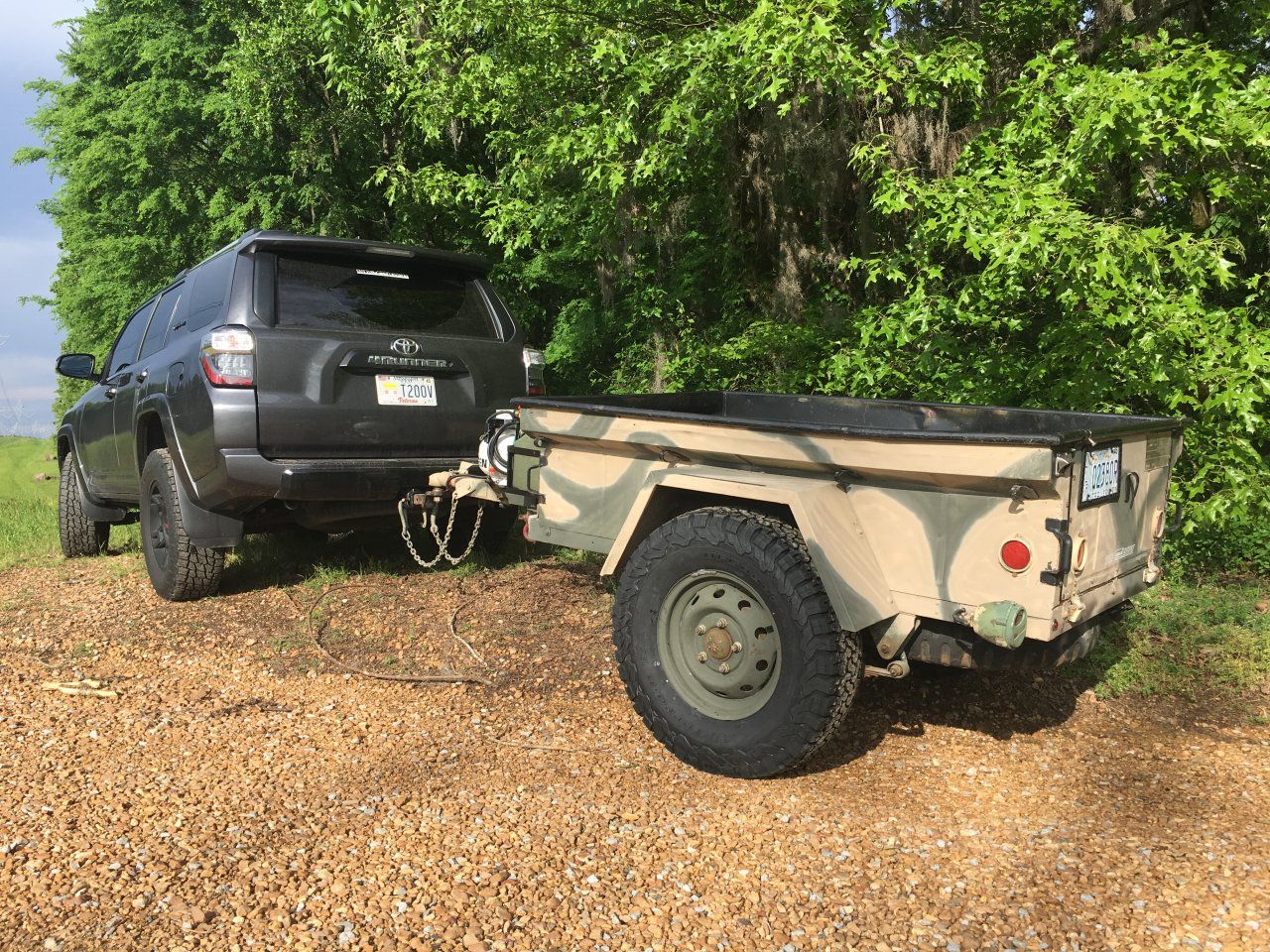

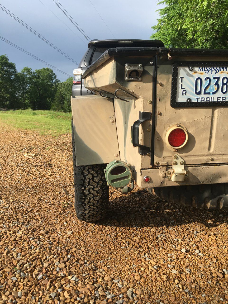

I got my 235/85/16 BFG KO2s on it today. They are pimp.
I like the look of the new tires but tire clearance to the fender looks close. Wonder if a spacer on the front spring perch would give more room. I know the front perch is bolted as used the front hole for the tire care and used fender washers on the three other bolts to make up the difference of the thickness of the tire carrier. Didn't have to deal with the shackle end and not sure if that perch is bolted on too. Spacers and longer bolts would be a simple way to get more clearance. Right after I bought my trailer picked up some more rims and new tires and tubes. Back then was only cost a $100 each side. Prices on tires have gone since then. New tires are 7.50 NDT and old ones were 7.00 NDCC.
Did you use the whole 100 series tire carrier of just the winch? Only two holes I drilled were in the main frame rail just in front of the spring perch, nothing on the cross bars.
Just the winch. It is the exact same width as the cross member.
Clearance.
You can't think of this like you would a traditional leaf spring setup with 2 axles. In that case when one side stuffs the 2 axles cause articulation.
In the case of a trailer, unless the hitch is bound up, the tire won't stuff into the fender like in a truck. It will just go up over the obstacle because there is nothing there to force the spring to flatten.
As I said, I installed a set of these on my trailer with the 1000# load and drove it and banged it around and no rubbing.

Question, when your springs compress does this reduce your clearance in the wheel well? When a spring with a shackle in the back compresses the wheel moves back and up. Your new tire looks close to fender and was just suggesting a easy way to lower the axle and create some more clearance.:meh:
Yes. They flattened out quite a bit with the 2F in there which is way way more weight than my RTT and a load of gear and even firewood
Just to be sure before I bought this size tire I put them on my trailer while the 2f was still in there. I live on a super rough road and there was no rubbing.
My point is that the way i set up my M416 with a good spring pack and new shocks and a longer tongue I won't bounce around empty or full. Now with the radials I can run less pressure in the tires if it ever gets real rough, but after my last trip I feel real comfortable saying that I don't need much tire clearance because they don't move much.
Look at a car hauler trailer. They have about 2" of clearance and they are set up that way.
The only thing I could foresee happening with less fender clearance is if a stick or rock gets picked up and carried around by the tire it could damage the fender easier than if I had 4" of clearance.
