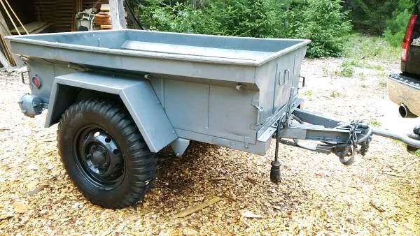

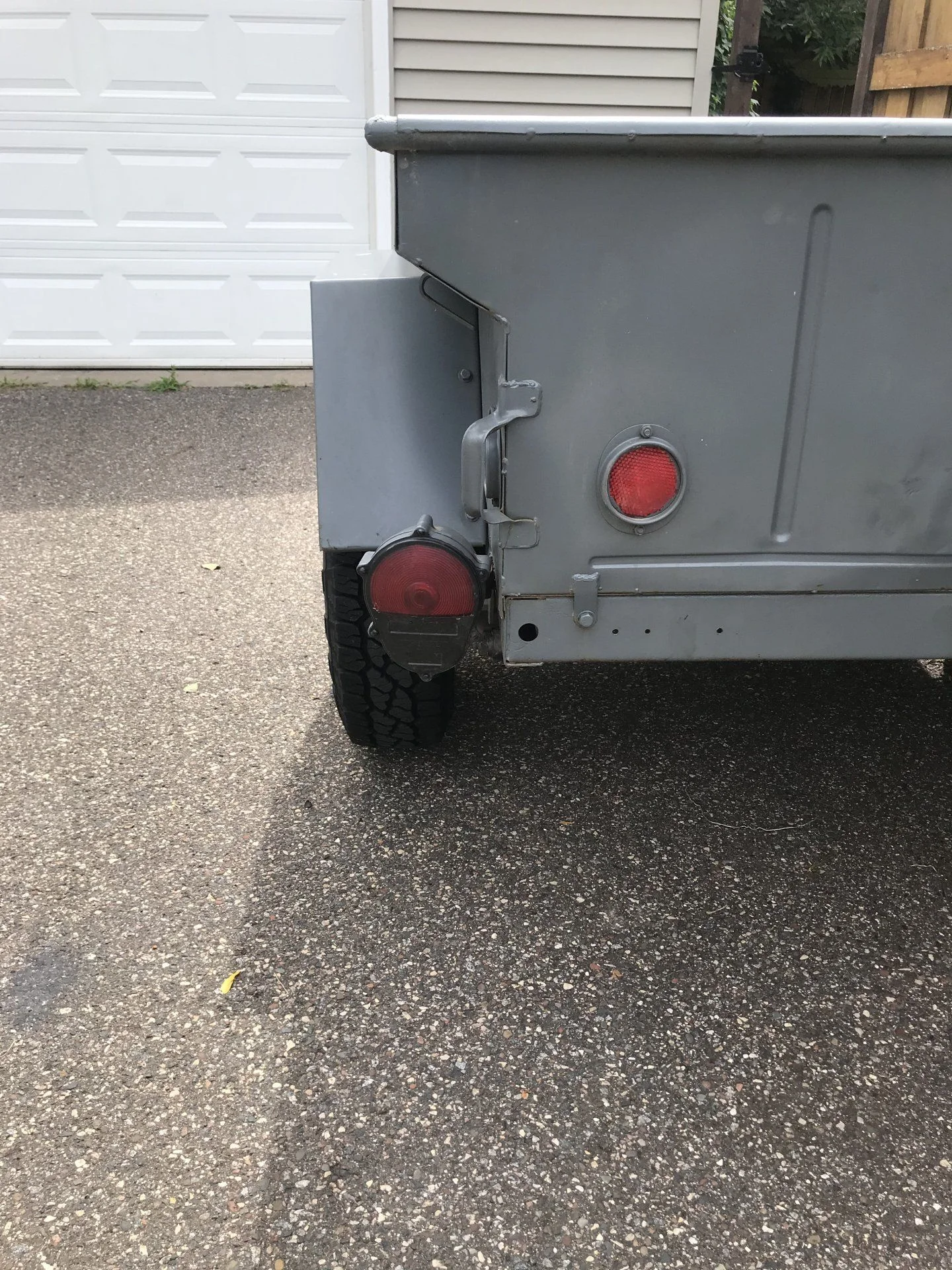

I found a local M416 trailer that I'm going to pick up tomorrow. It's in near mint shape, has tailgate intact, shorter pintle/lunette hitch, 12pin connector, lights work, side indicator is included, original wheels/tires and spare included. No rust, tub is in great shape. Here is a picture of it.

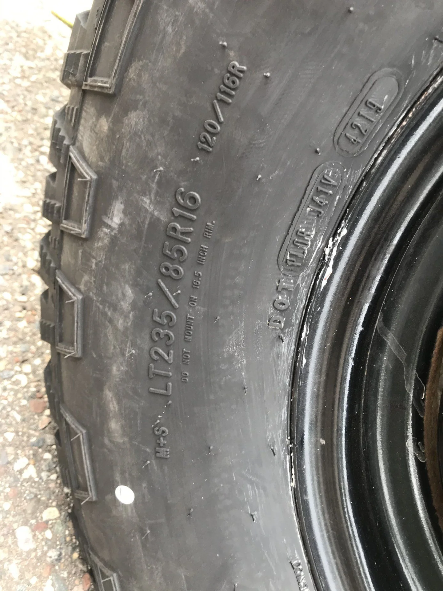

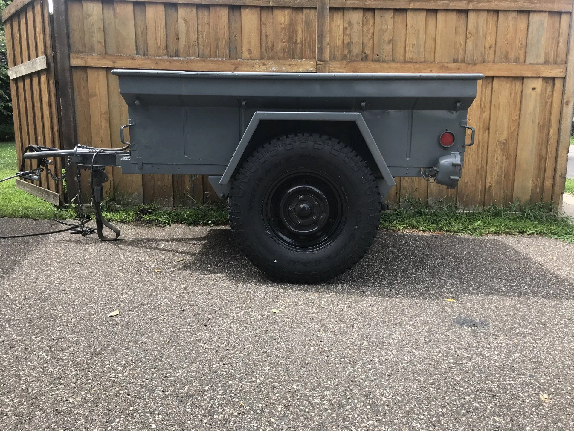

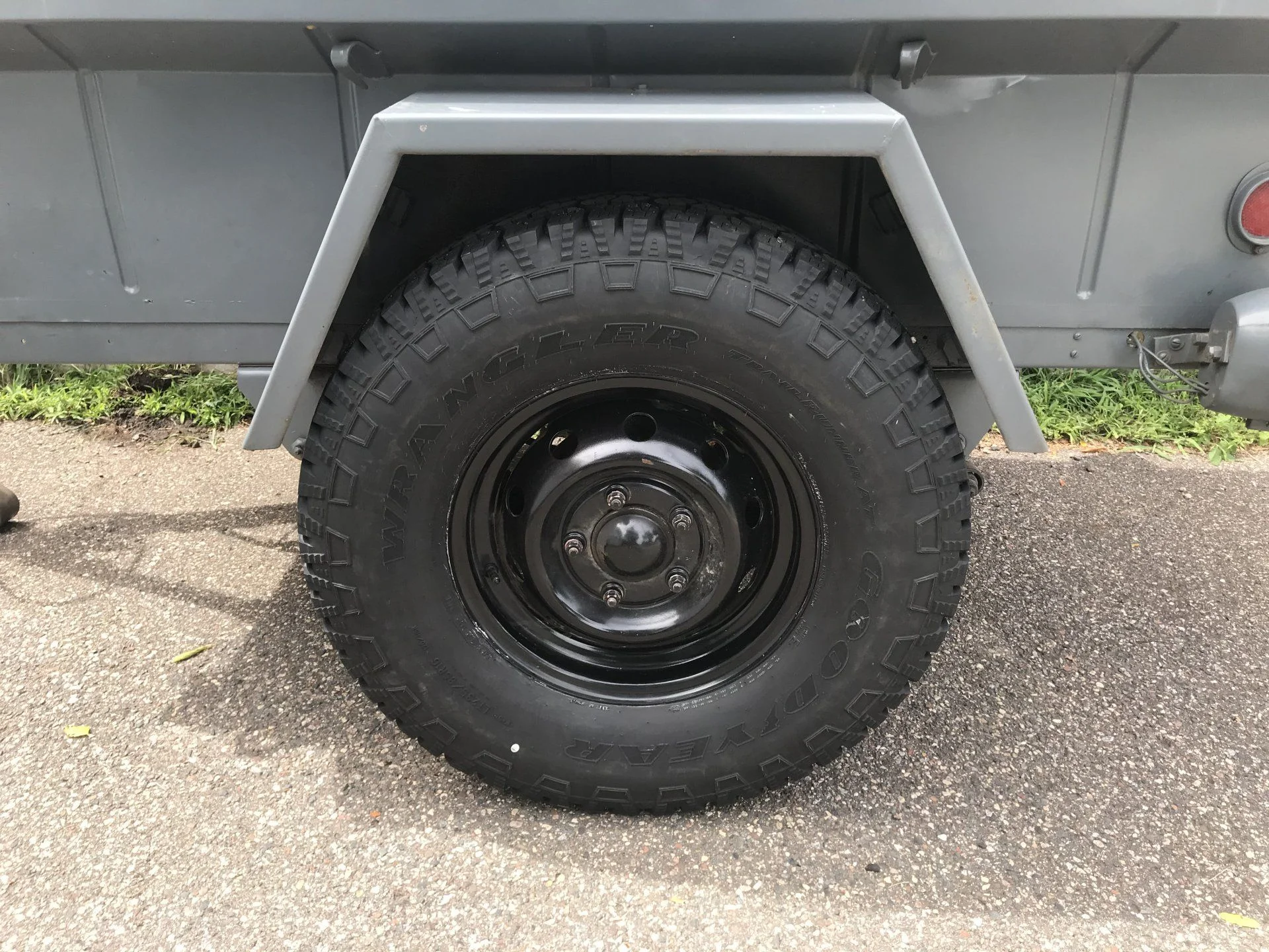

New shoes! Duratrac Wrangler Trailrunner 235 85 R16 LT E load rating and the M+S snow rating which may be good for MN winters... Nice aggressive side wall and a relatively low rolling resistance middle tread seems like a good compromise and at $120/tire I can't complain. I had duratrac wranglers on my 4runner and loved them. KO2's on the 100 series though... mismatch. I mounted them on the original rims for now. I gained about .75" with the tires for reference. They sit within the original fenders which should prevent too much mud or gravel fling.
Next up is mounting the brackets for the RTT and the cross bars to the side walls and welding a 2" receiver to the rear for bikes. 2x rotopax will likely mount to the front inside of the tub and a 20# propane tank to the tongue. Debating where to store the spare trailer tire... may do a bolt on solution through the front wall of the tub and have it sit over the tongue somehow. I'm trying to balance the rear weight with 2 mountain bikes with a spare and 2 3gallon rotopax up front. I may mount the maxtrax upsidedown in the blue ridge overland bag underneath the tent to the crossbars. Ideas?

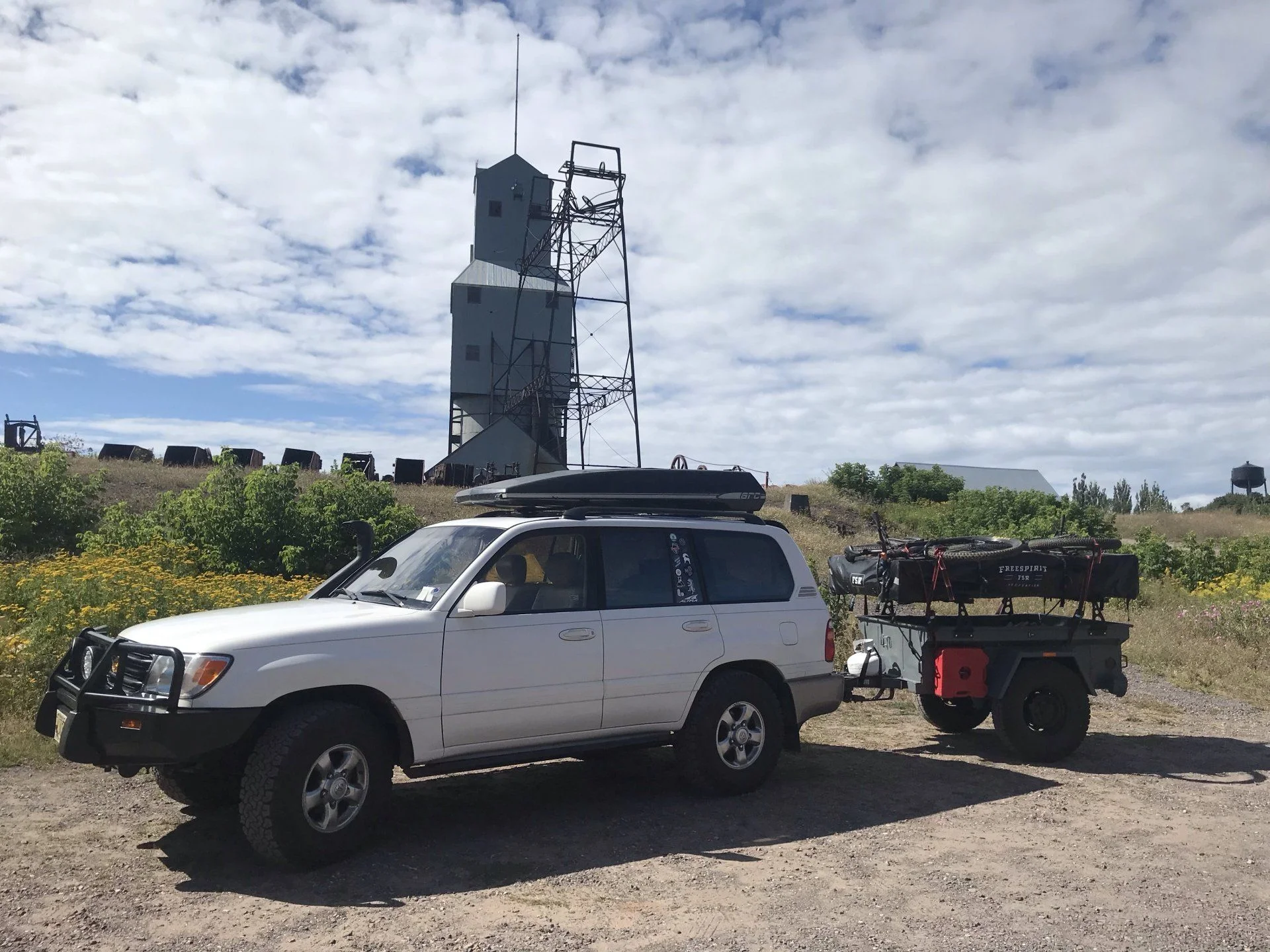

Here it is at the end of shakedown week #1. We took it on some challenging trails around the Upper Peninsula and it performed flawlessly. A little loud with the Pintle/Lunette but it allowed the trailer to articulate on its own which was a must for some of the trails.
Next comes:
1. Getting the bikes off the roof top tent (the hitch I was using on the rear was too heavy and caused a lot of swaying when we got on the highway despite the 250# of water I had in the front so we ditched it before the trip) The hassle of taking them on and off was enough to make that the next necessary step in this build. I'm either going to try to use a lighter rack and put 2x 45# plates in front under the water or under the propane tank or get a tongue box and start the electrical system to counter balance the weight from the bikes. If those options don't work, I'm going to try to get 70" cross bars and put two bikes on fork mounted roof racks on either side of the tent. It would still be a hassle but may be better in the end to avoid the long rear end on the trailer.
2. Design and weld up the lid!
3. Weld up a new rear bumper with a hitch that is much higher than the one on the rig presently.
