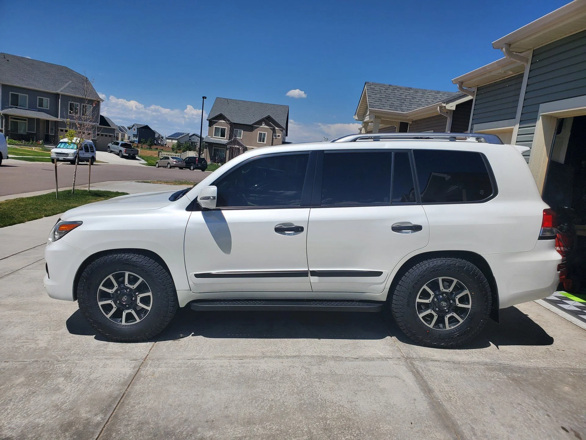

LX570 wheel well "adjustments" for 35s
Interesting solution. :hmm: Pair that with some of the Icon Vectors and it would look sexy with all that meat. (sounds weird)
I can't recall the wheel offset but they are standard Tundra TRD take-offs. They were cheap and essentially new when I got them. I did a COVID quarantine art project and made them into LRD wheels - an idea I got from mud somewhere - but I don't have pics yet.
I use 1.25" Bora Spacers and have no complaints. Turning radius is still impressive and I have no fears parallel parking or turning around on trails.
I've considered starting a build thread, but I suck at taking pictures so I'm afraid it'd be too boring. Not a bad thing, but when I go out and wheel or work on the truck and I forget to take pictures because I'm having too much fun or too focused. Also, I'm no photog.
Wheel parameters get more critical when fitting such meats so I was particularly interested in your offset. Tundra wheels paired with the 1.25" spacers puts you at 28mm offset, which is just about perfect.
Those bigguns put you in monster truck territory. Def monster truck.
Isn't it interesting how the LX variant is the one now more readily capable of fitting big meats. They both rock, but there should be no need for the BS of "if you want to mod it, get a...".
Awesome pics on your instagram @dubyahard . Throw big ol tires on. Get out there. Lots of height and clearance to tackle aggressive stuff even without the benefit of armor.
Thanks!
Made some anti-rub mods this morning based on all your advice (really appreciate all the suggestions!) and got the LX aligned. No rubbing so far other than in low, at full lock, turning up my driveway. On the road to LCDC now but will post about how I did everything later.
