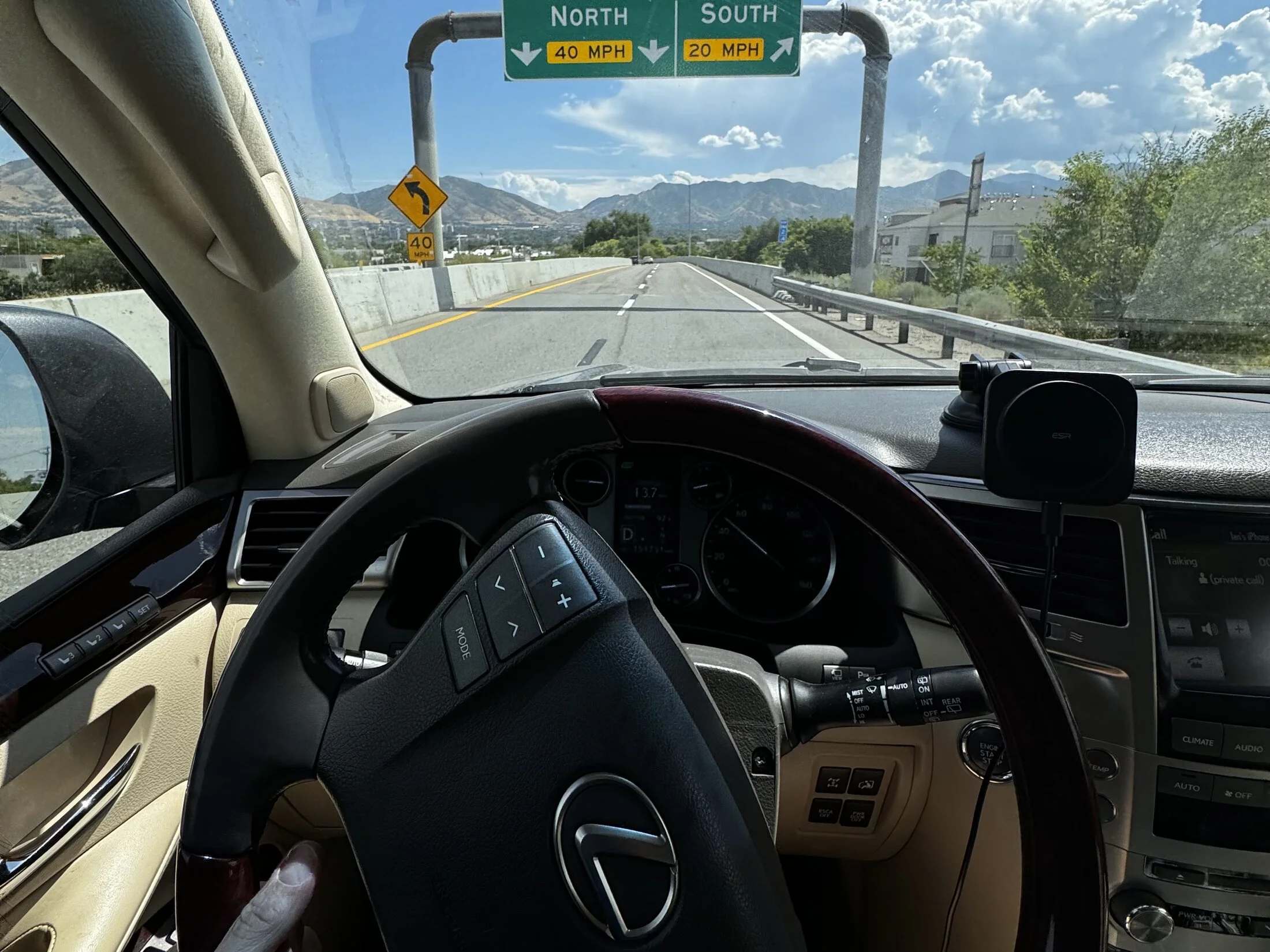

Does anyone have ANY idea what might have caused cause this?? My steering wheel was 80 degrees right while I’m driving straight. This is NOT an alignment issue.
2013 LX570. I left it idling for 30 minutes, did some lock to lock turns to get out of a tight spot and then this… I tried turning the wheel lock to lock stationary and moving, turning the ignition on and off with the wheel in various positions and it didn’t seem to make a difference. Then my daughter drove it and it mysteriously sorted itself out… no problems since.
It’s just the VGRS getting off center from the maneuvering. Search that term on here and you’ll get lots of info.
