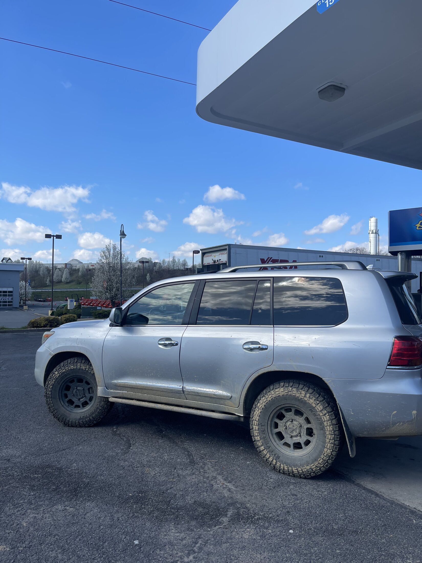

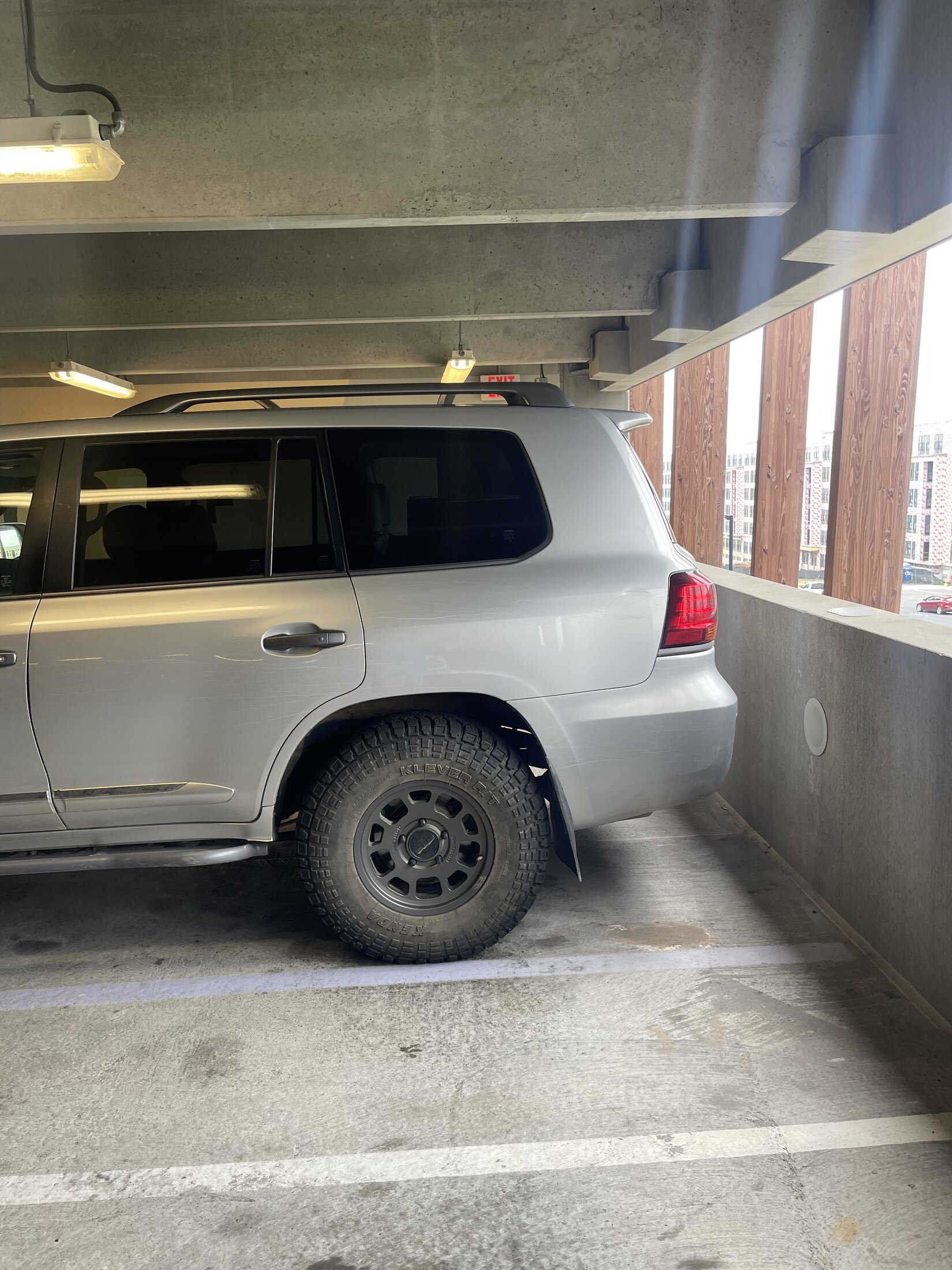

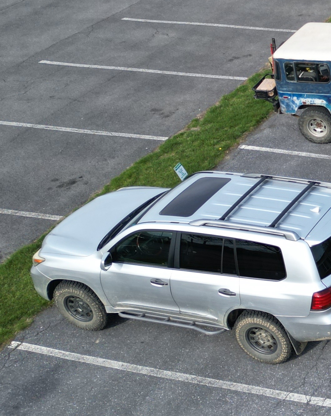

I like my slee sliders steps. Slow but reasonably straight forward install. I put LC200 rockers on and they fit perfectly. I like things to look as oem as possible (I hate exposed welds and bolts, etc.)

I run the @sleeoffroad ones with 200 series rocker panels. They’re solid, easy to install, and take a hell of a beating.
I have a set if 1st gen Slee sliders and they are still as solid as when I got them. For day to day use having a nice step is hard to beat. If you are building a wheeler you’ll miss having a kickout. These trucks are wide.

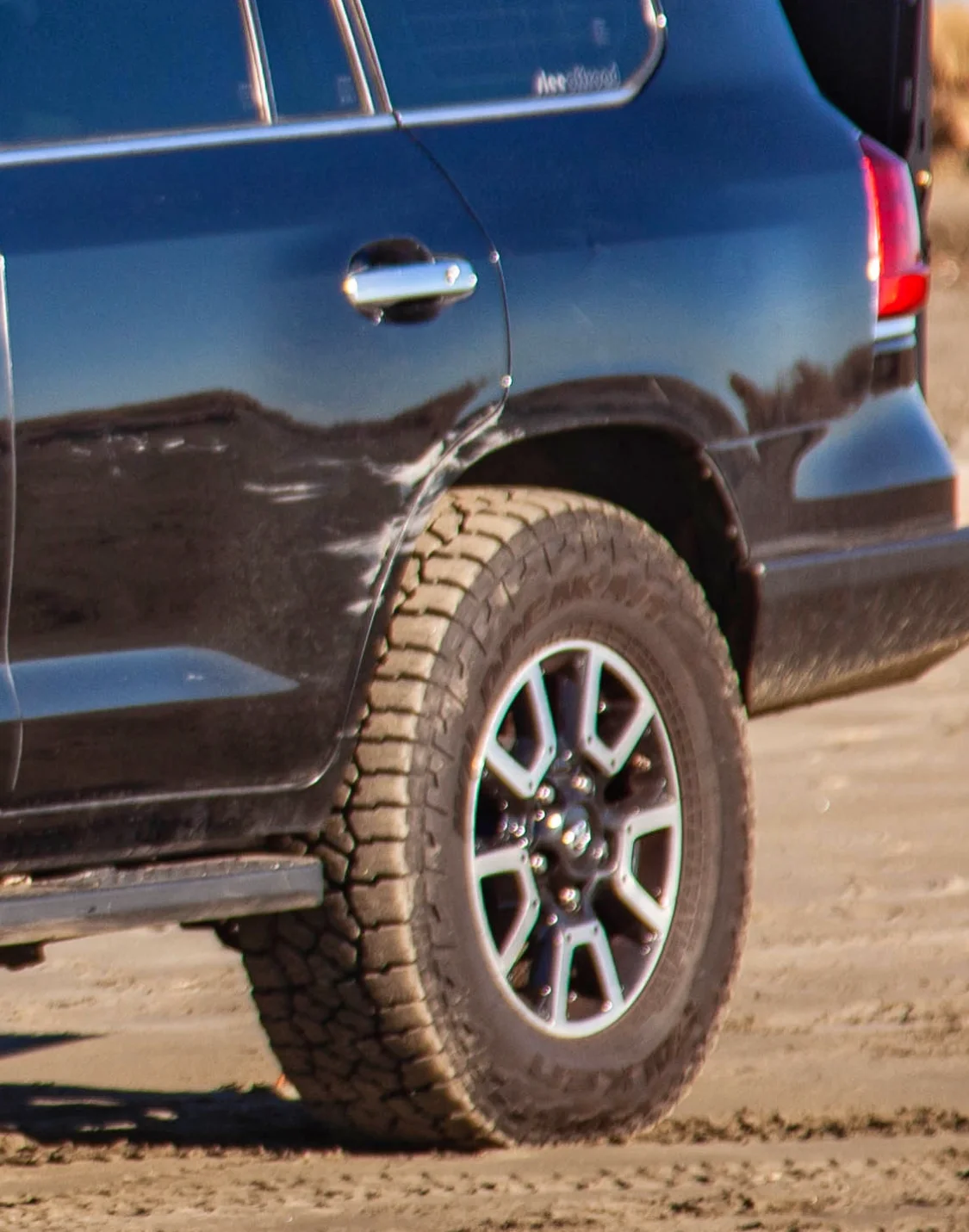

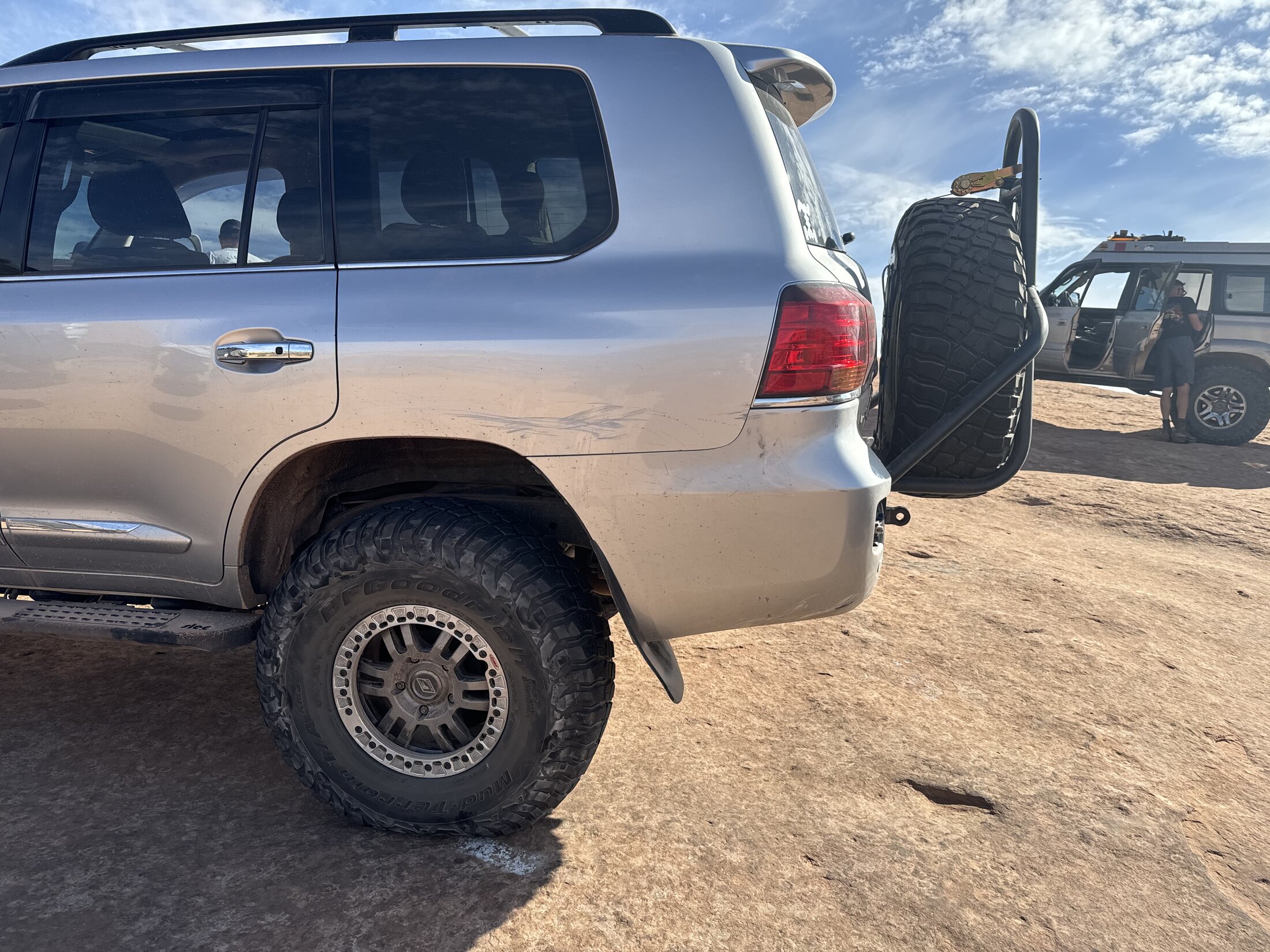

Got a little hung up on a rock in Moab and tried to power through (AKA slide). Well I slid, but the front edge of the slider bent up into the quarter panel. Not the full weight of the vehicle, but a pretty solid impact--enough to make the wife ask if I broke anything :hillbilly: Somewhere a little over 1/2" deflection. The body of the slider was not deformed and actually took the abuse quite well (and I have impacted the sliders more lightly many times, the body held up fine other than scraping off the powdercoat). I think the attachment arms are just a little weak for heavy use.
