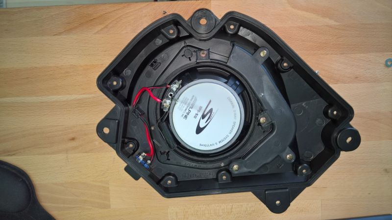

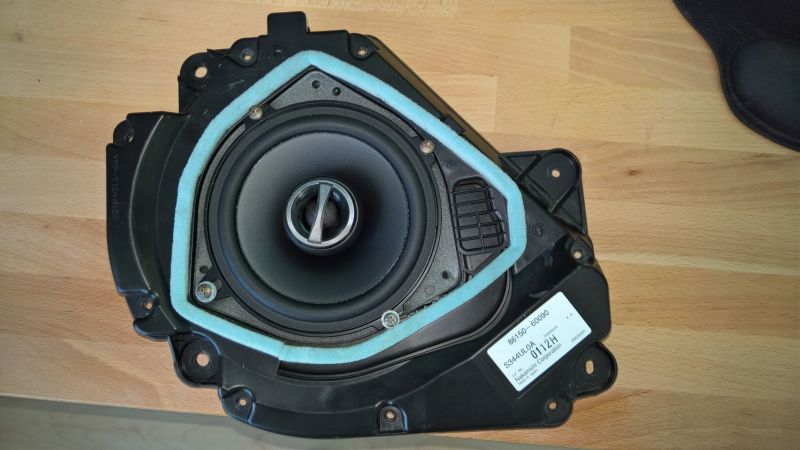

Did the 4" rear door speakers today:
As you can see I left the ML tweeter in place, but disconnected since the Alpine SPS-410's already had tweeters on them.
