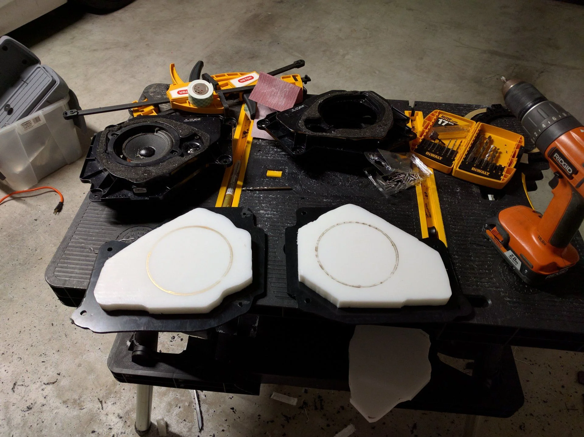

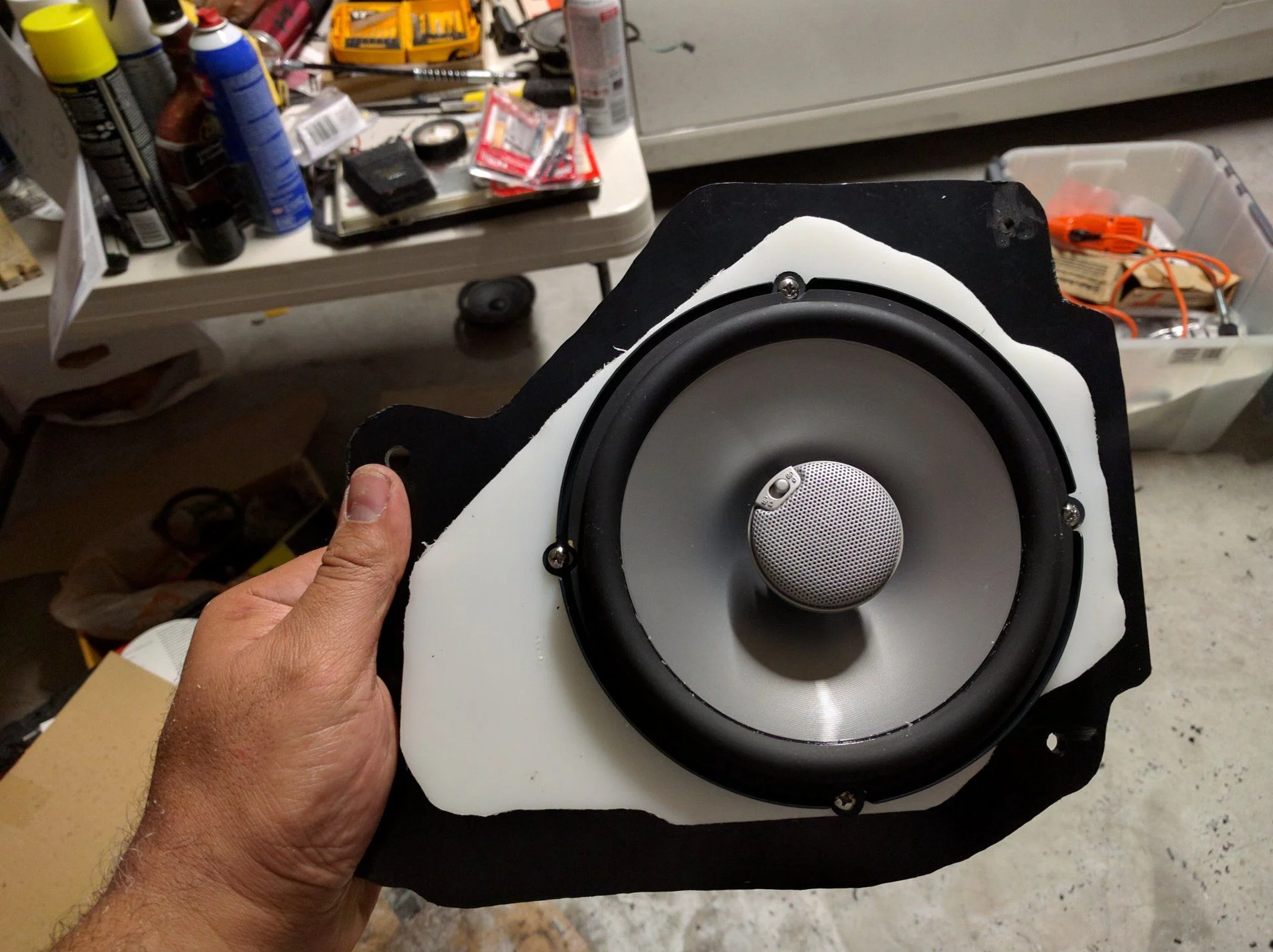

I have a 2003 LX with the Levinson System but ordered Infinity 6.5" speaker for the rears by listening to crutchfield.com. :doh:
I thought no big deal. Find a LC speaker pod and replace the ML pod. Nope. Shape of the speaker pod is different.
CARP!
To not let a stupid plan go to waste, I constructed these:
They sound great but I believe they are held back by the high crossover points the ML amp is sending to the rear.
These are not hard to construct with a modern jigsaw. They would be trivial to construct if you have a table router and router bit talked about here :
