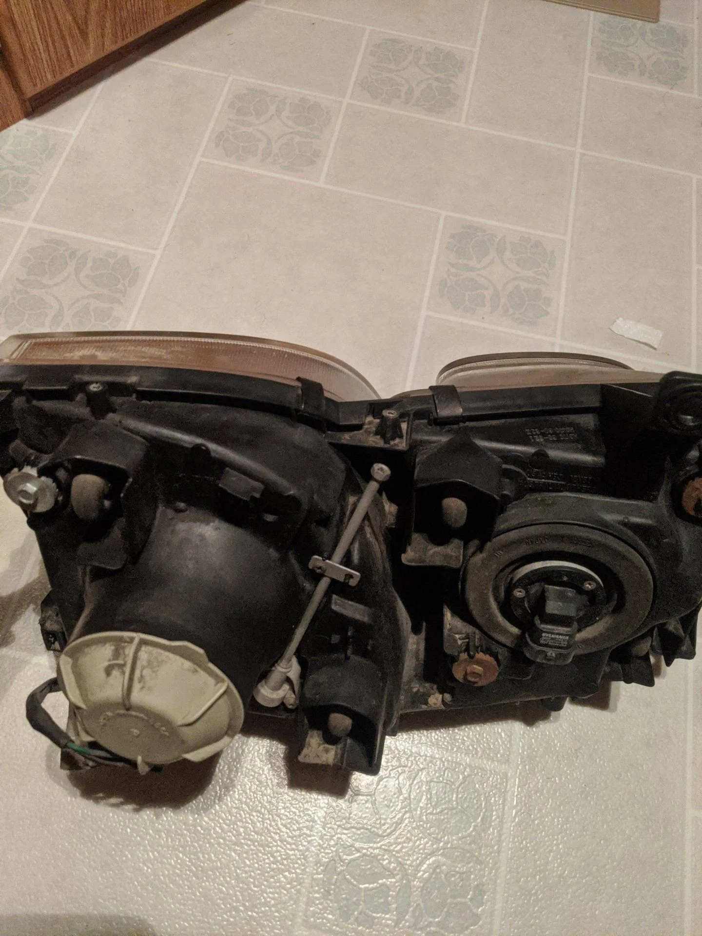

open the hood. Just in front of the rad support on the back of the lights about halfway between the high and low beams theres a very long screw that sticks up that has a philips head and i think also its a hex head. Turn that.
I'll see if I can find a picture or ill go take one...hold on.
crap picture but as you can see by the first picture, theres that seriously long screw that runs diagonally up from the base of the low beam up to the middle of the light housing, thats what you're going to want to turn. Second picture is a crap picture from the top. My desktop computer took a crash so I cant get to all my pictures right now.

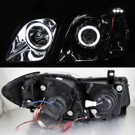

At the end of the "seriously long screw," there might be a plastic cover. Under the cover is a geared wheel (think ring and pinion). One of my screws was stripped and adjustment had to be made by turning the wheel itself. I think there is a phillips head on top of it.
This is an aftermarket headlamp but it shows all the geared wheels.

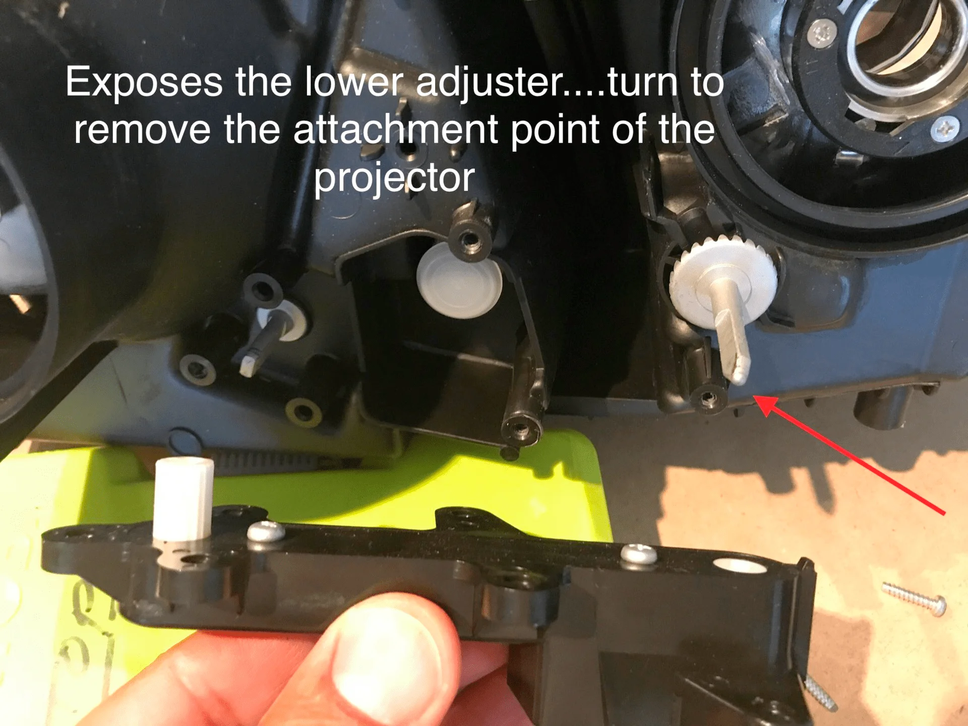

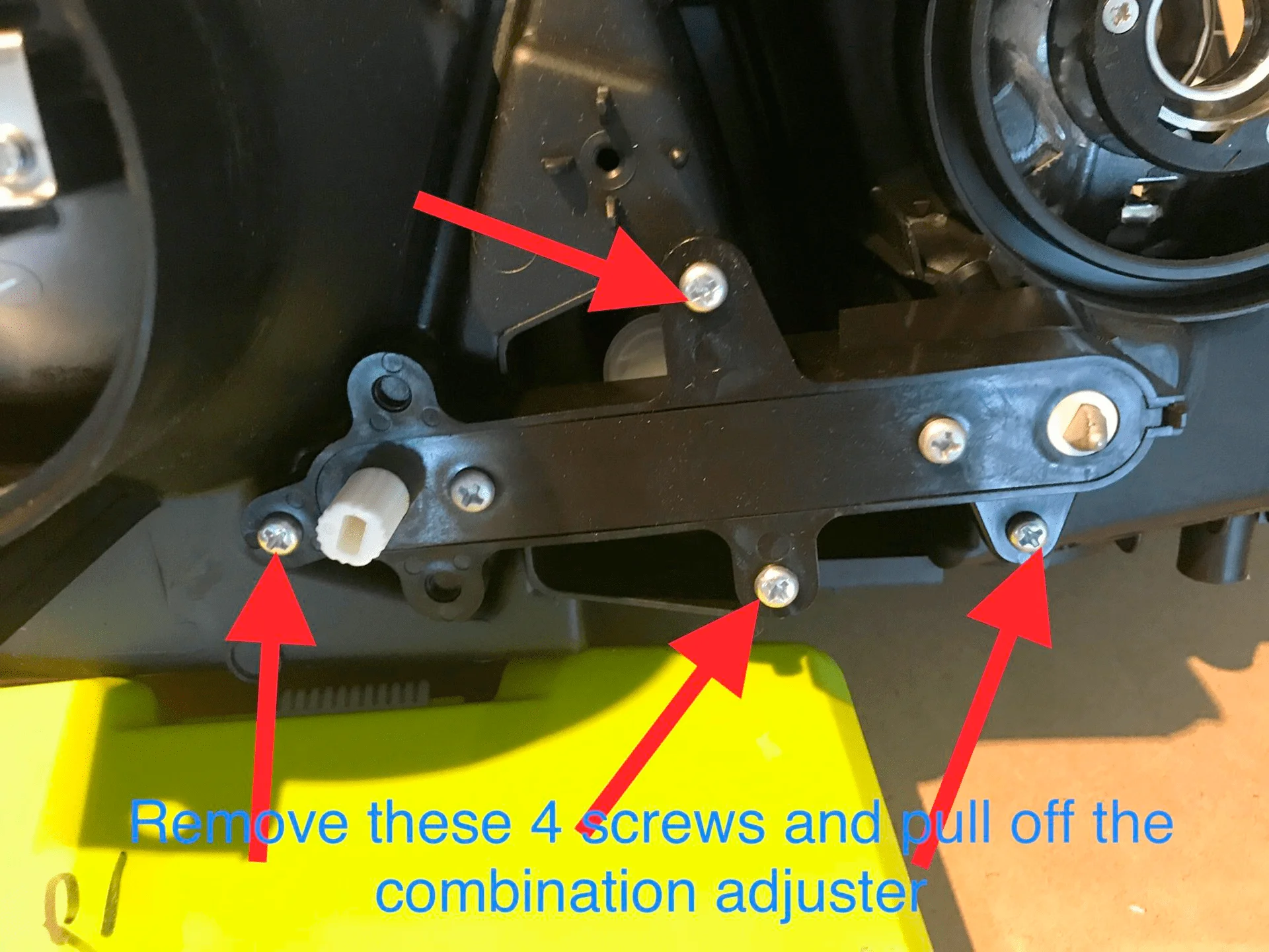

If it looks like this... it's a combination adjuster . The white plastic knob adjust both high and low beam... you can remove it and adjust them separately. Disregard the instructions and arrows... the pictures are from my HID projector install guide

I just tackled this job in my '03 lx. Taking off the combination adjusters is the way to go. The combination adjuster is plastic, and I didn't want to risk breaking it. You will need some type of tool to turn the adjustment knobs. I couldn't get channel locks or any other pliers to work. I took a grinder to small piece of aluminum scrap metal, cut a notch in it, and used it to turn the metal adjustment rods (knobs). I had to remove the battery, put it on the ground in front of the truck, and use jumper cables to the battery terminals to turn on the headlights and see how the adjustment moved. It's not difficult, but way more time consuming that need be. I'm sure the Lexus techs have a sweet little tool that makes adjusting the lights a breeze.
