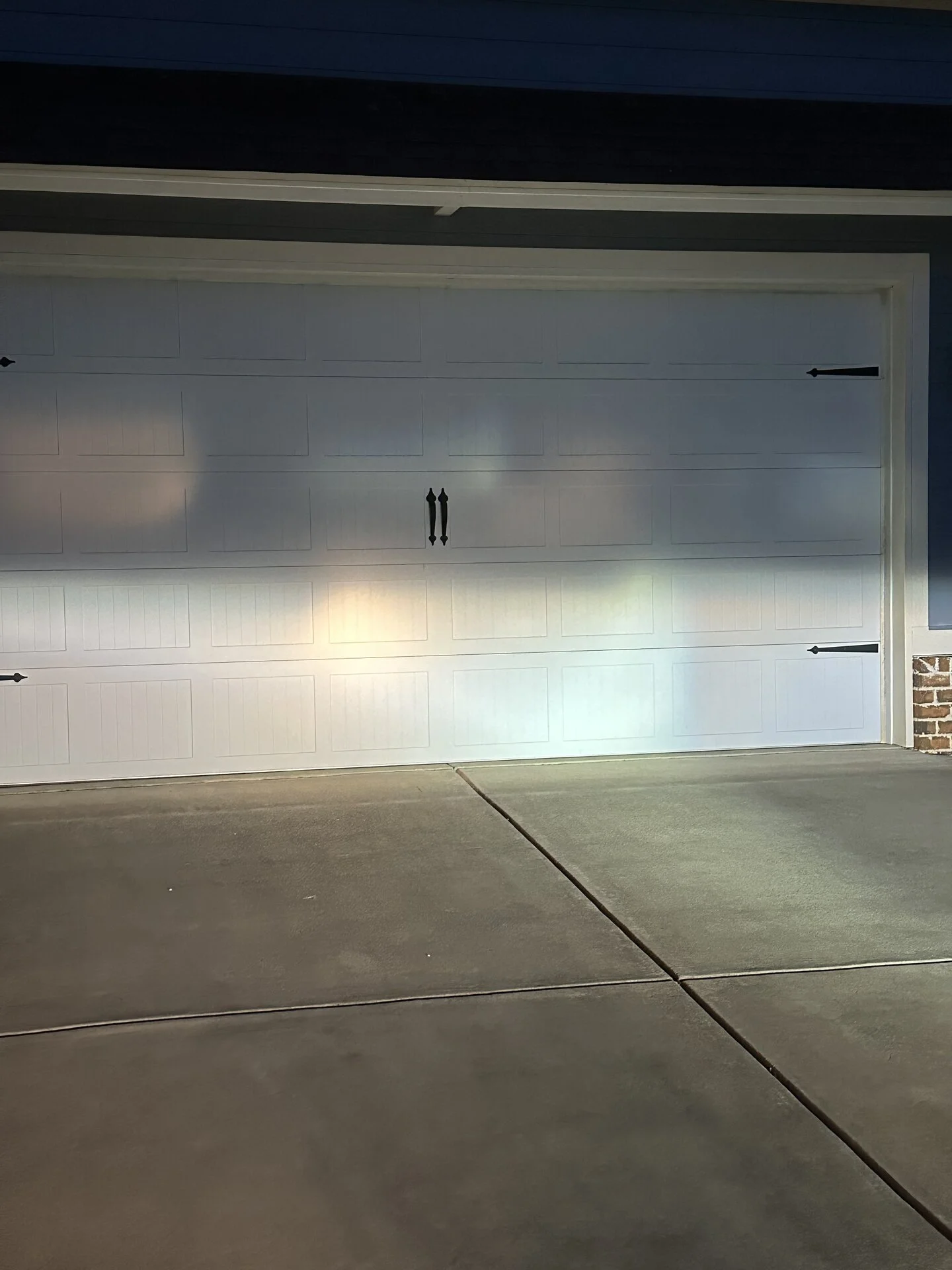

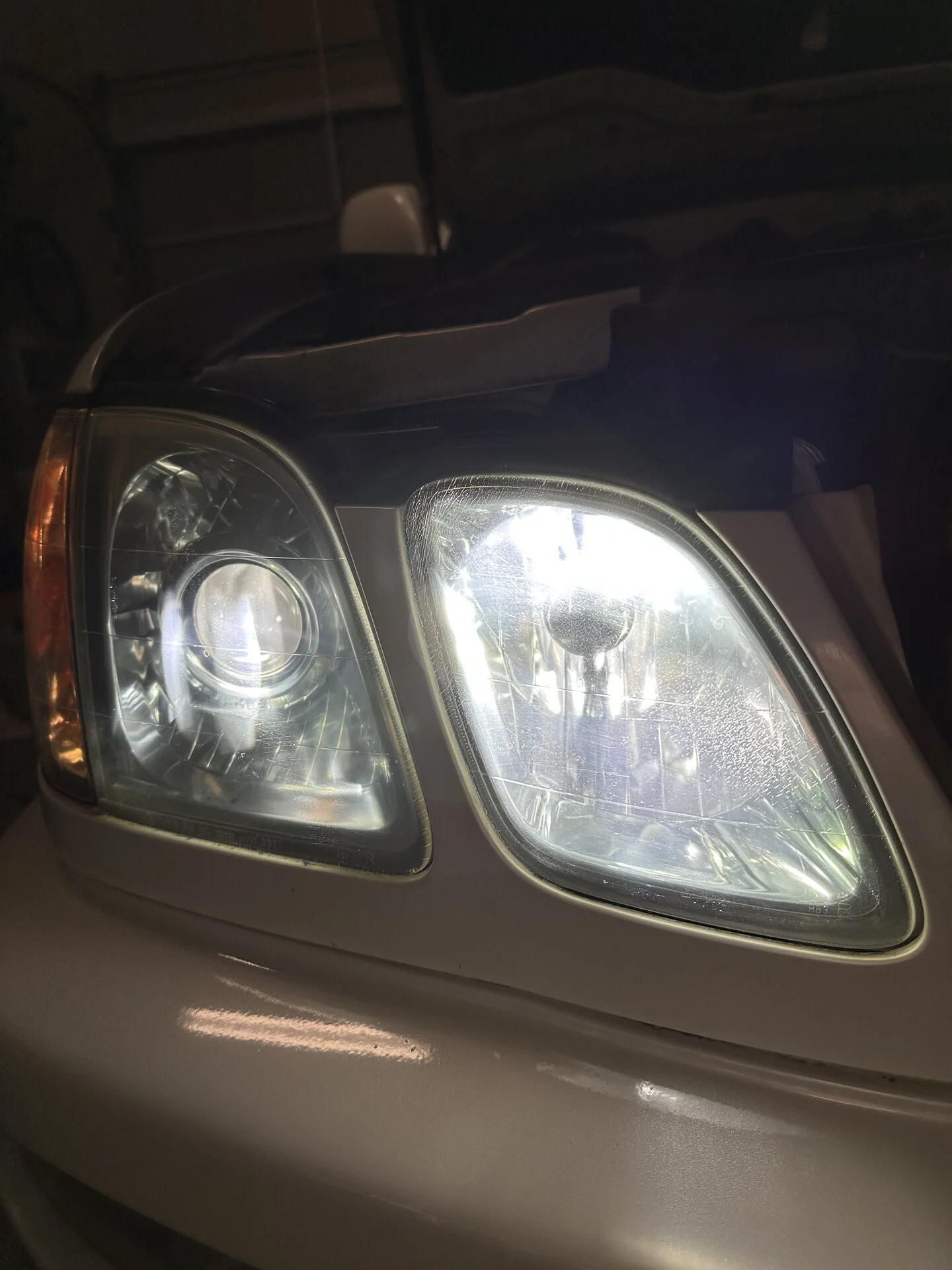

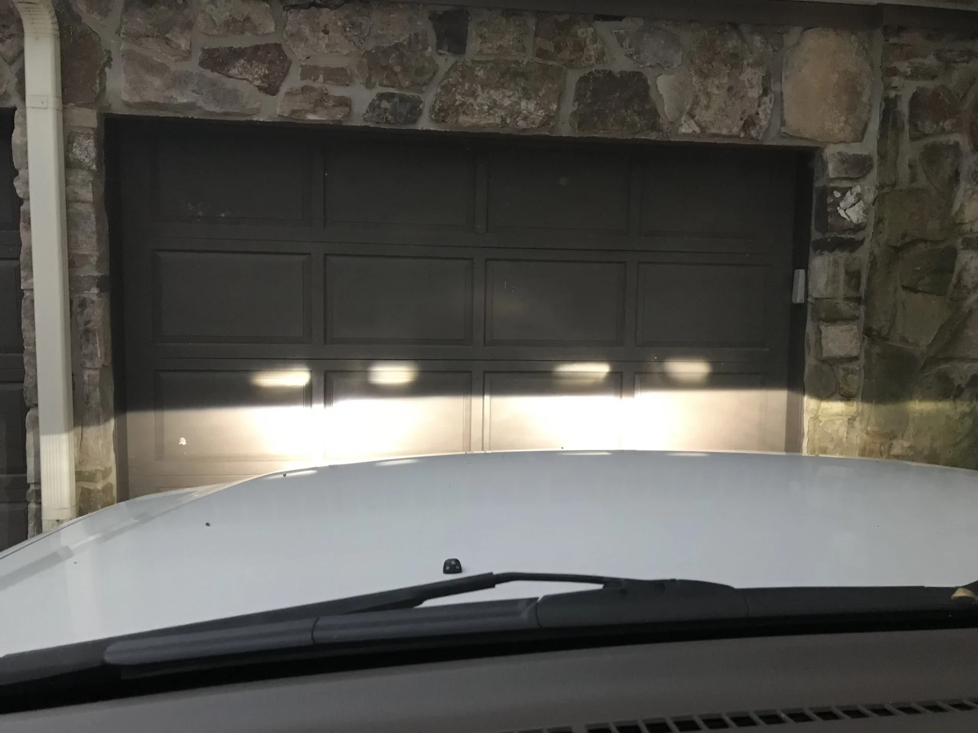

I bought the Hikari LEDs and dust boots, and installed them last night. I got a really wacky beam pattern though, each light puts out 2 squares of very intense light right at winshield level of oncoming cars. The bulbs seem to only fit in one way with the groove in the housing, did I miss something or could this be because I have the earlier glass housings?

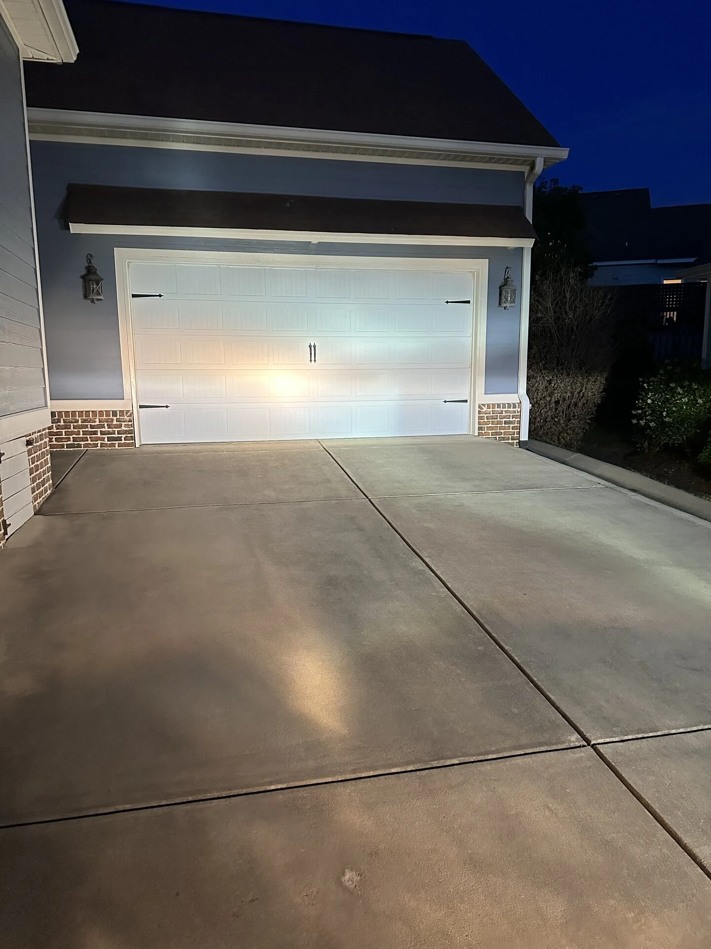

Also, the barn door is a different color than the building, the headlights do actually match in color despite how that photo looks
Those 4 spots are the Toyota/Lexus “squirrel finders”.
Amazing. Thank you. I didn't even notice them with the factory bulbs.
I see in this retrofit thread, they were blocked with aluminum ducting tape, I'll have to see if that is accessible from the rear tonight. Even if they're supposed to be there, I parked the LX and drove my Corolla by it and that low, it was blinding with the LEDs. I wanted to give my own empty LX a middle finger. Bulb length must be directing more light through them.
The squirrel finders are not accessable without removing the projectors unfortunately.
They do aim higher than most vehicles though.
I messed around with these bulbs some more, I didn’t realize the retainer base that clips in was removable at first. I clamped that in first then put the bulbs in 180 degrees from where they were and the squirrel finders are much less apparent now. Definitely tolerable.

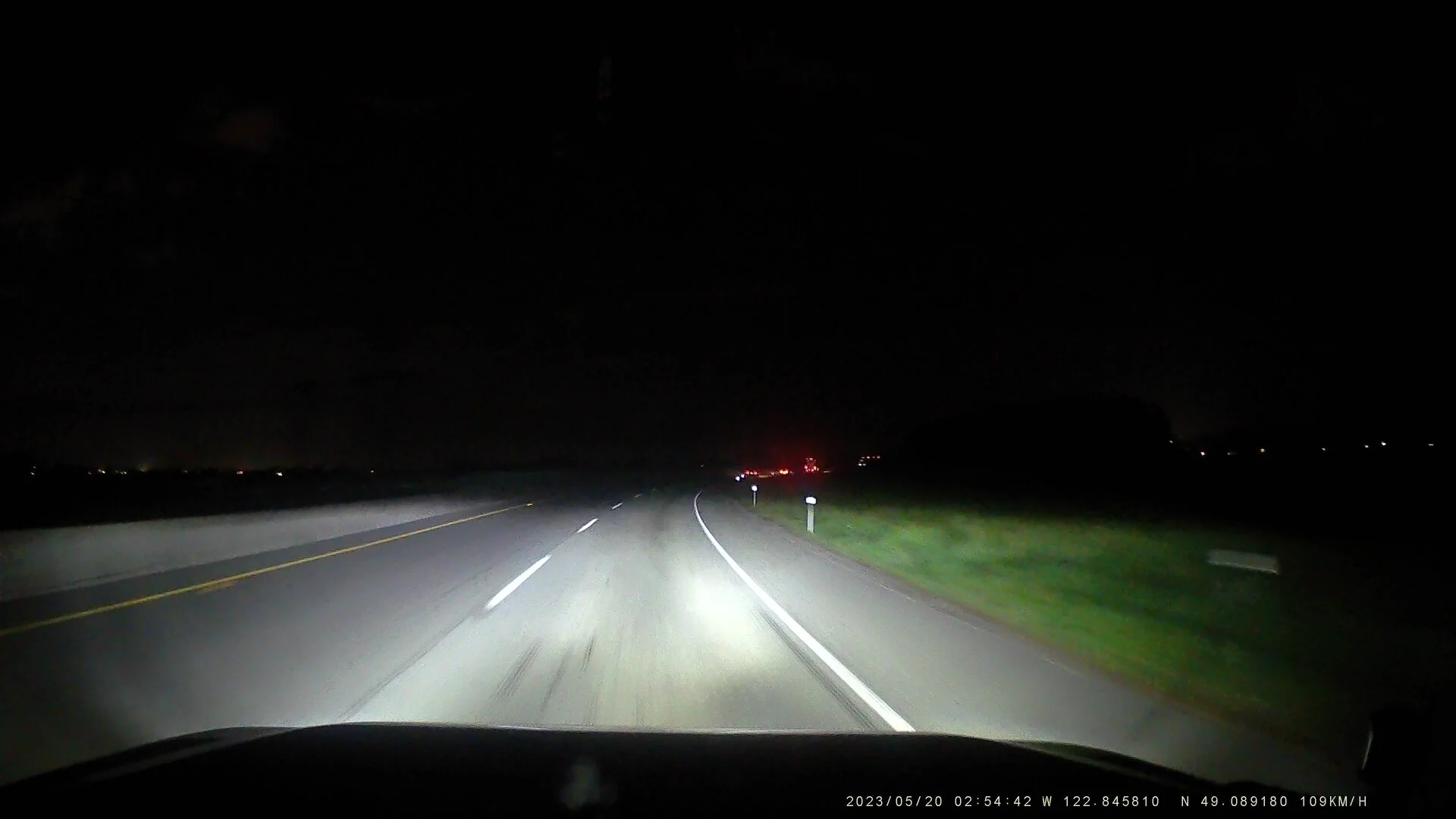

I changed up to the "HIKARI 2023 Future 30000LM" and they are awesome. Much better than the DDM I was running before. Highly recommended

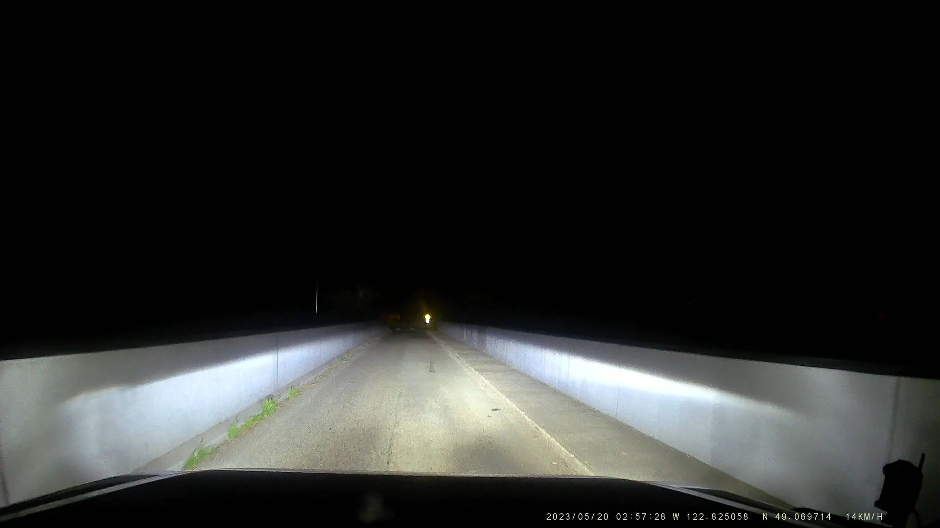

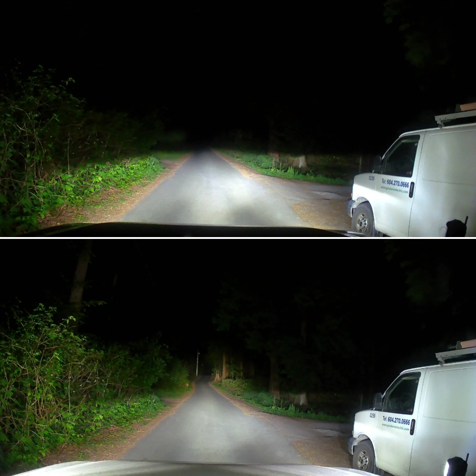

DDM was still a good bulb, but the Hikari clearly puts out more light under the cutoff. DDM has a shadow right in the middle of the beam.
DDM on left, Hikari on the right
