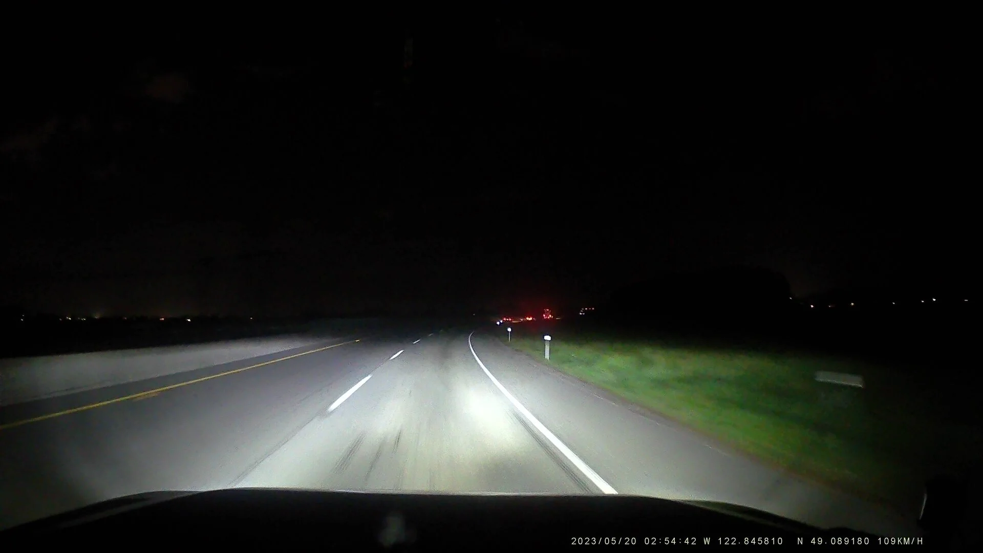

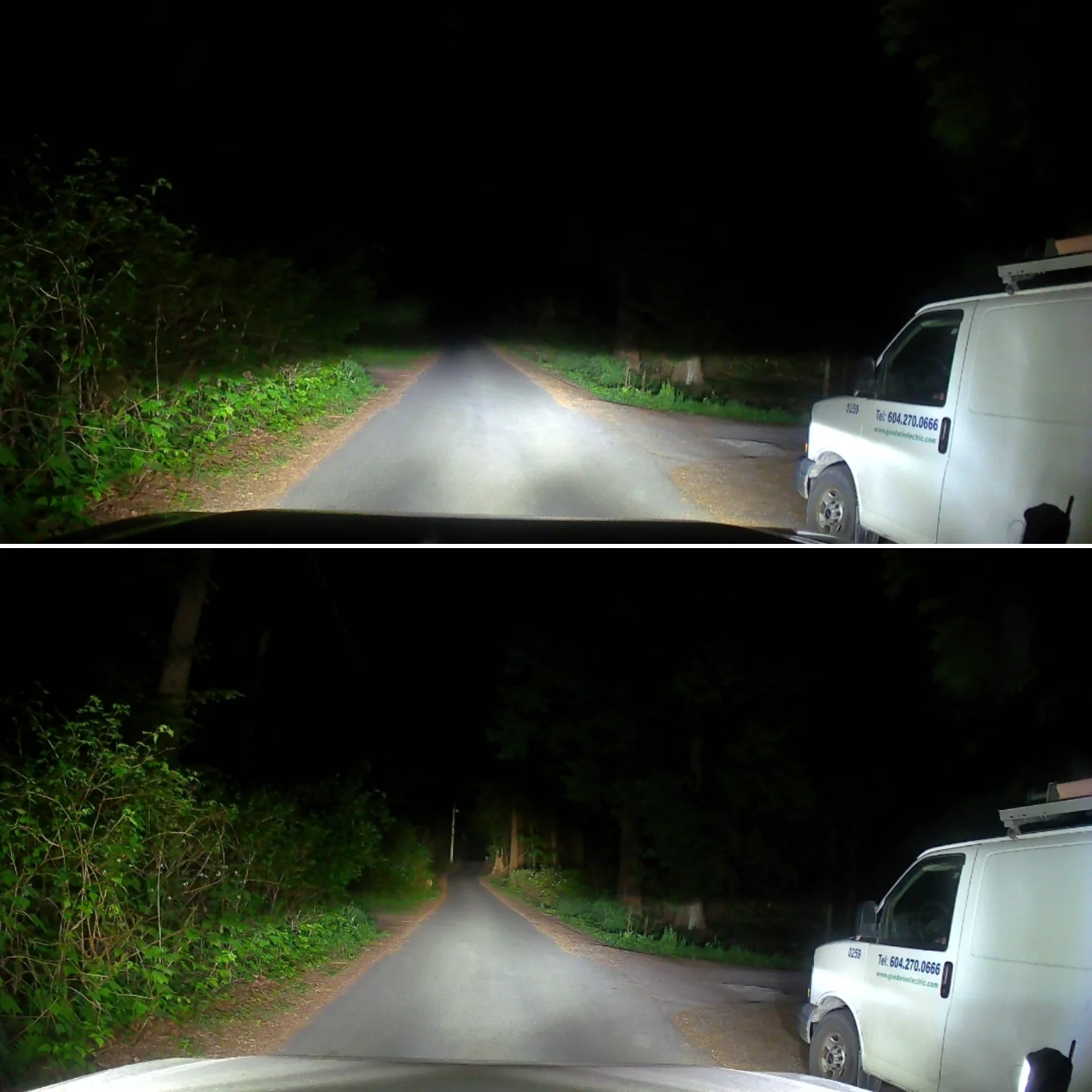

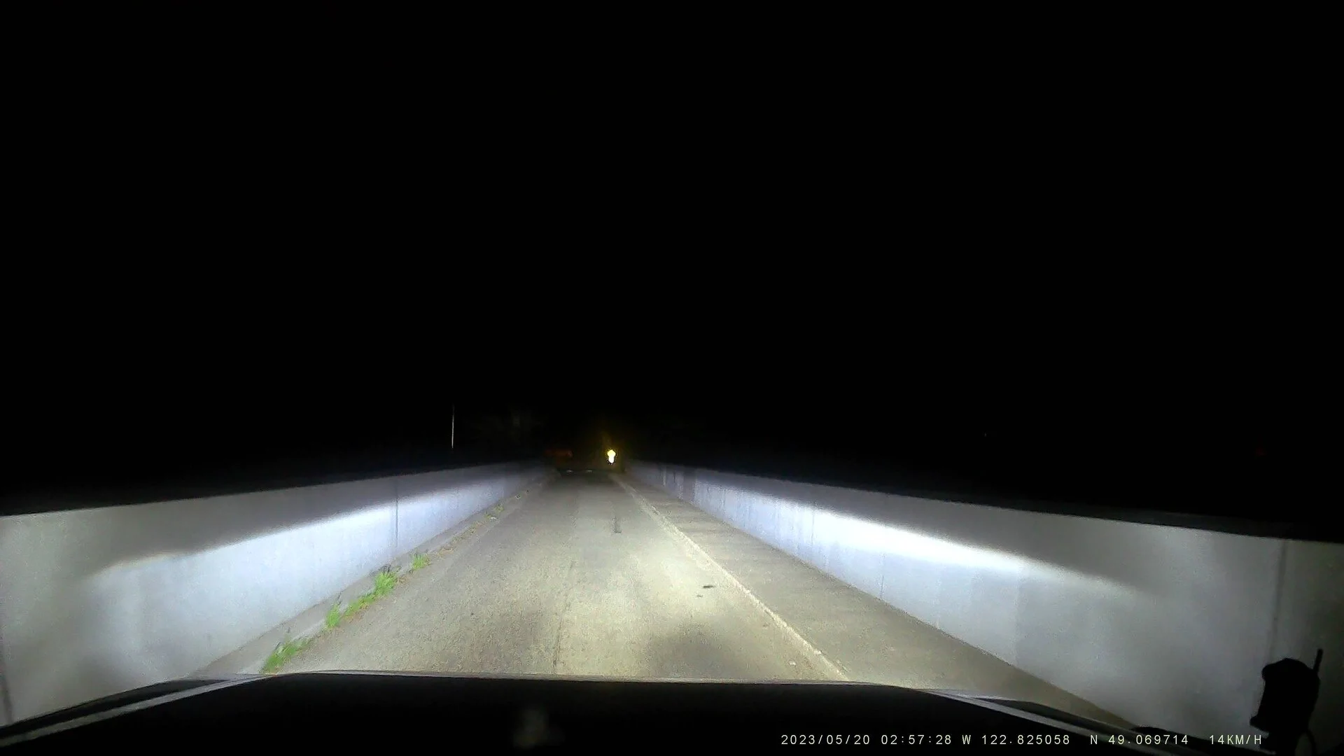

I'd love to know how you got such good results with the Hikari's. I tried them in my stock headlights and had horribly scattered beam patterns.
Any tricks?
There are several different Hikari bulbs out there so I can only speak to the 2023 model.
But, making sure the bulb is seated flush and clocked/rotated correctly can make a big difference.

Hello
I was in search of an LED bulb for my 2006 Lexus LX470. I found it, and it is awesome. You will need to buy H1 Led bulbs and new dustcaps. This is what I bought from Amazon. It does not require any kind of cutting or flickering devices. I just hope the bulbs last.
H1 Led Bulb: (HIKARI 2020, H1 LED Headlight Bulbs)
Amazon product ASIN B07XKSWSF6
Dust Caps: Car Rover Headlight Seal
Amazon product ASIN B076Q9D52Z
See pictures
