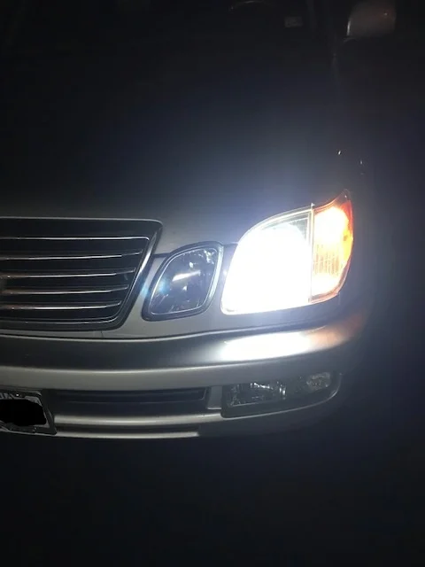

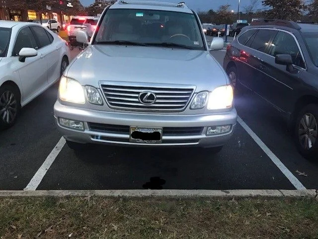

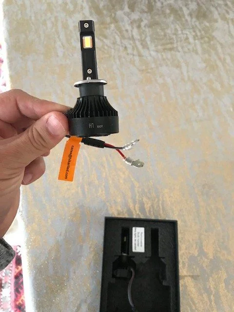

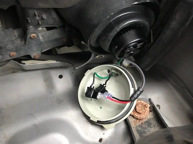

I was in search of an LED bulb for my 2006 Lexus LX470. I found it, and it is awesome. You will need to buy H1 Led bulbs and new dustcaps. This is what I bought from Amazon. It does not require any kind of cutting or flickering devices. I just hope the bulbs last.
H1 Led Bulb: (HIKARI 2020, H1 LED Headlight Bulbs)
Amazon product ASIN B07XKSWSF6
Dust Caps: Car Rover Headlight Seal
Amazon product ASIN B076Q9D52Z
See pictures

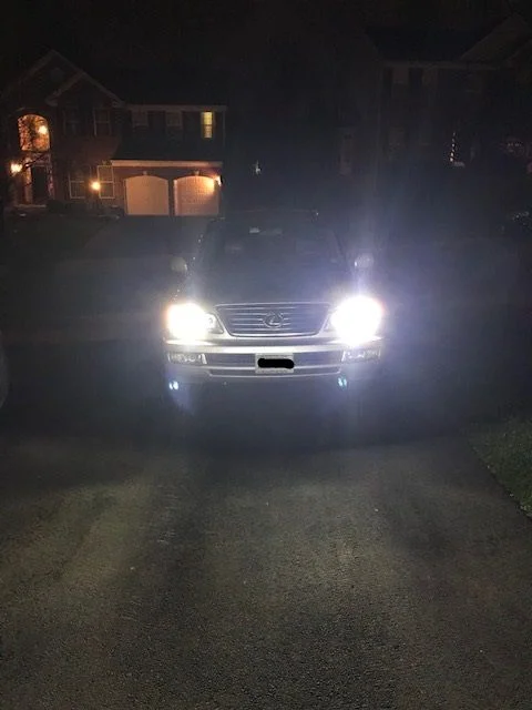

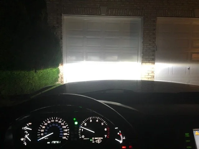

Would you post a pic of the beam pattern on a wall or garage door please? (looks REALLY glaring from those front pics) Thanks!
As far as LED's in a LX470 with Factory Projector Lenses, the consensus here is that they don't work well in the LX and should be avoided.
Here's a couple threads with really good info and pics of the beam pattern
(you definitely want that "cut off" at the top to keep from blinding people on the road)

Yikes, I see this time and time again, LEDs in projector housings. They just don't match and give off an insane amount of glare for oncoming traffic. I also hate LEDs because the beam gets lost whenever the road is wet.
Hope we never meet coming down the road.
The light output looks pretty good.

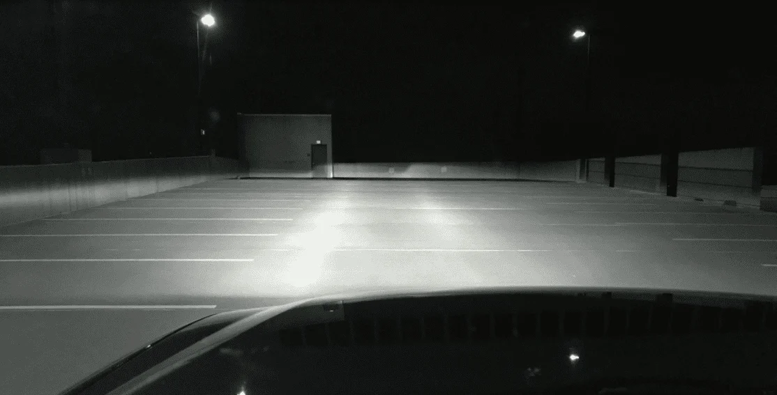

Can you take a pic from farther away.
Here is a picture of the beam pattern. It looks good, the Hikari 2020 H1 LED bulbs are DOT Compliant and Street Legal.
thanks for the pic, I'd be interested to hear your experience in the rain at night. Have heard that led's can be washed out or lose power to cut through rain.

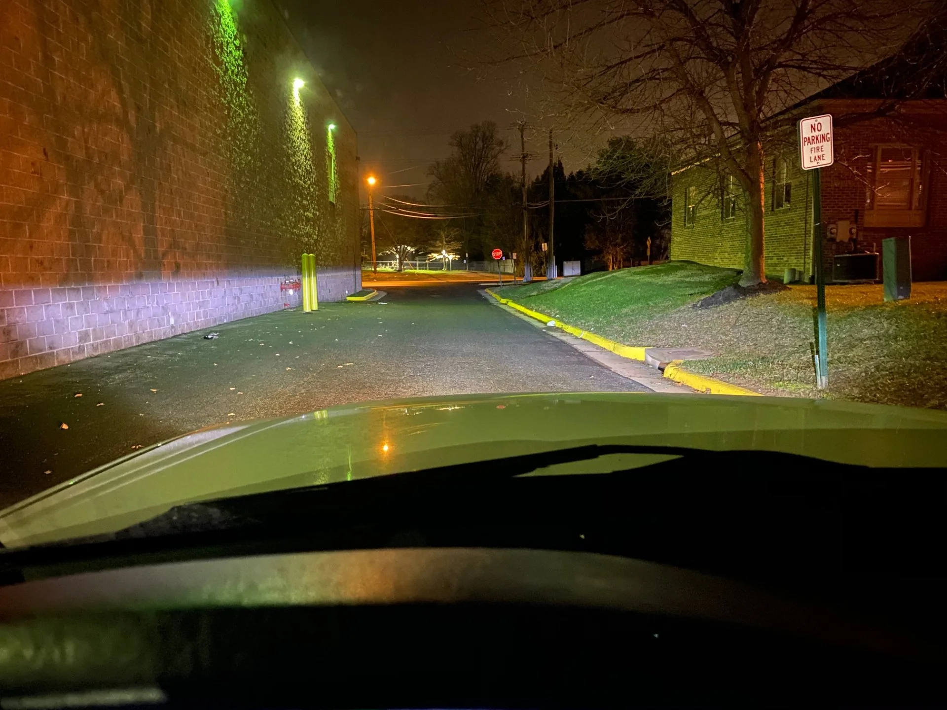

Thanks for sharing. I bought these based on another user's experience and photos showing a clean cutoff. Forget who originally posted these:
Amazon product ASIN B07HWVDTBN
I have the same cutoff on my LED's that you posted, and have personally driven (in other vehicles) in front of and head-on and don't experience any visibility/LED glare issues. One thing I did was zip-tied the bulb once set in place so that it wouldn't move and would hold its cutoff placement. Haven't noticed negative side affects due to weather or anything, and keep them on 24/7 since I disabled my DRLs due to having an LED high beam.
LED's get a lot of hate around here...I'm guessing due to the lack of awareness around LED technology and its advancement over the past few years. There's definitely room for user error as well, especially if you don't check your cutoff and adjust as needed. HID upgrade is likely in my future.
