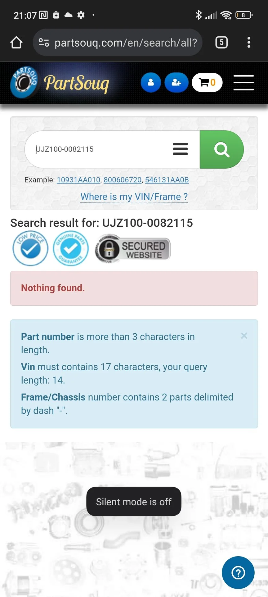

The vehicle you are looking at is September 1999. I’ve checked using partsouq.com by entering chassis number. It also had VSC and TRC. 1998 and above models indeed had cool box option.
I tried partsouq too but can't seem to find it... What am I doing wrong? 😳
