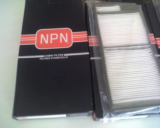

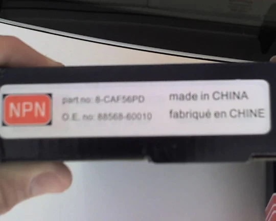

ok I bought some from maximumautoparts.com they delivered the ES/LS filters for my family and cancelled my order for the the LX/LC Said they were out of stock and needed me to call back in two weeks. I did and they just arrived yesterday. I ordered four for that price I thought why not, plus it got me free shipping. I received a large box, with four individually wrapped filters. They all look the same and do not say Denso, they say NPN and they are made in japan. I am going to try to install them since they look like the ones posted here. I will post some pic's

If you have problems getting them to fit in the older LC's, where they have not been installed before check the bottom of the filter slot, mine was full of pine needles and dead bugs sucked in through the cowel vents. I was having trouble getting the first one down far enough to slide the second in on top. There was some serious dirt in there.
They was a suprising amount of stuff to vaccum out, but none the less the new filters looked the same as the ones on here and similar to the ones in my ES. I really don't think ths type of filter is terrible effective. If it had a charcoal filter infront of it maybe. But the more effective the filter, the more pressure/suction needed. I think that is why there are several fans around the Charcoal activated carbon filter in the LS that goes behind the Glove Compartment horizontially. It worked. Not really happy with the fact that other guys got both denso filters for 13. and change and I paid that per filter but still beats the 50-70 some paid.
