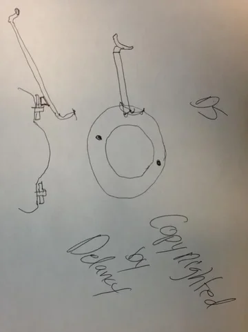

Here's what I think, considering it's very tight confines to weld anything to the upper coil tower, at least with my facilities and devices, plus permanently affixing would make PS gearbox removal difficult, if not impossible.
There's two bolts the attach the bumps to the top of the tower, penetrating from bottom to top.
Why not cut a ring that's the same inner and outer diameter of the flat portion of the coil tower, utilize the bump bolts to bolt the ring to the tower, making for easy removal when the time comes, the weld the bolt on Poly Performance resi mount to the ring, with the resi oriented towards the front, and maybe stiffener between the bottom of the resi mount and the ring?
Hold on for pic.

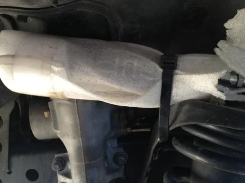

If they'll be offered "For Sale" I'd replace my temporaries with....
Nothing like a high quality zip tie.
