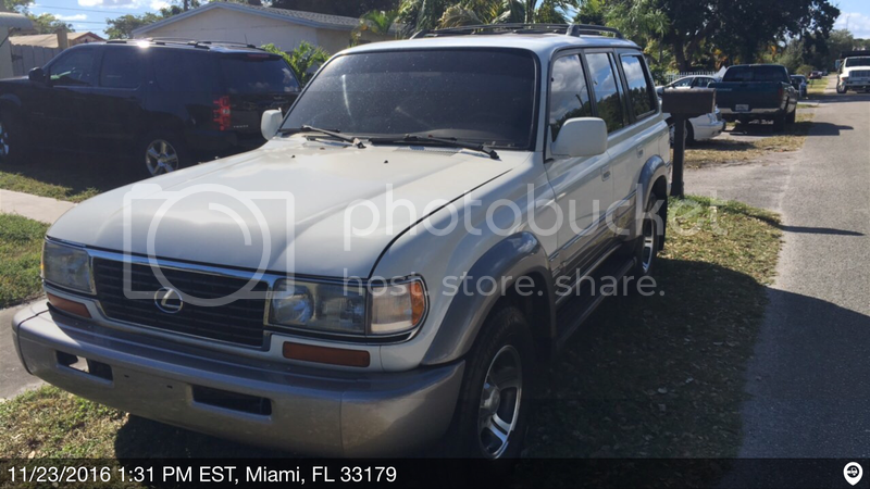

It's finally on the way, spose to be here on tomorrow, Thanksgiving delivery is something else to be thankful for, the shipping logistics was a nightmare, what a cutthroat industry. Any way here's a couple of receipt inspection pictures I got from the shipper, immediate upgrades include: needing a receiver hitch in the interim until a proper bumper can be gotten and new tires, I have a set of cooper sst's on my 4runner with about 10k miles on them and they have gotten a lot louder and it seems to be continuing to escalate, probably go with nitto terra grapplers or maybe some sort of toyo....so many options, looking for good on and off road performance but more towards on road most 4 wheeling will be done at the beach.... not gonna beat and bang this one for a while.... here's the pics....
