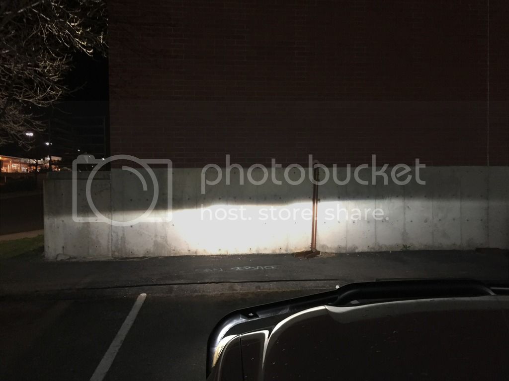

LX 570 HID Headlight retrofit
Cost was very reasonable. Hope this helps others!!
Make sure you have enough slack on the hid bulbs so the projector can articulate. Otherwise the AFS will go on a fritz and disable itself - you'll know bc you'll get an error on your dash. Glad you stuck with the lx. As I mentioned the S2k is mid to late is 90s technology while the lx is at minimum mid 2000 engineering. Anxious to see the output pics

Yes, I did. It's a night and day difference and easy to do. You just need to cut the back of the factory plastic bulb covers. Am using 4500k HIDs as I didn't want any blue, just a pure white. Cutoffs are also pretty good. Keep in mind the hoops on my bumper block some side light on both sides.
