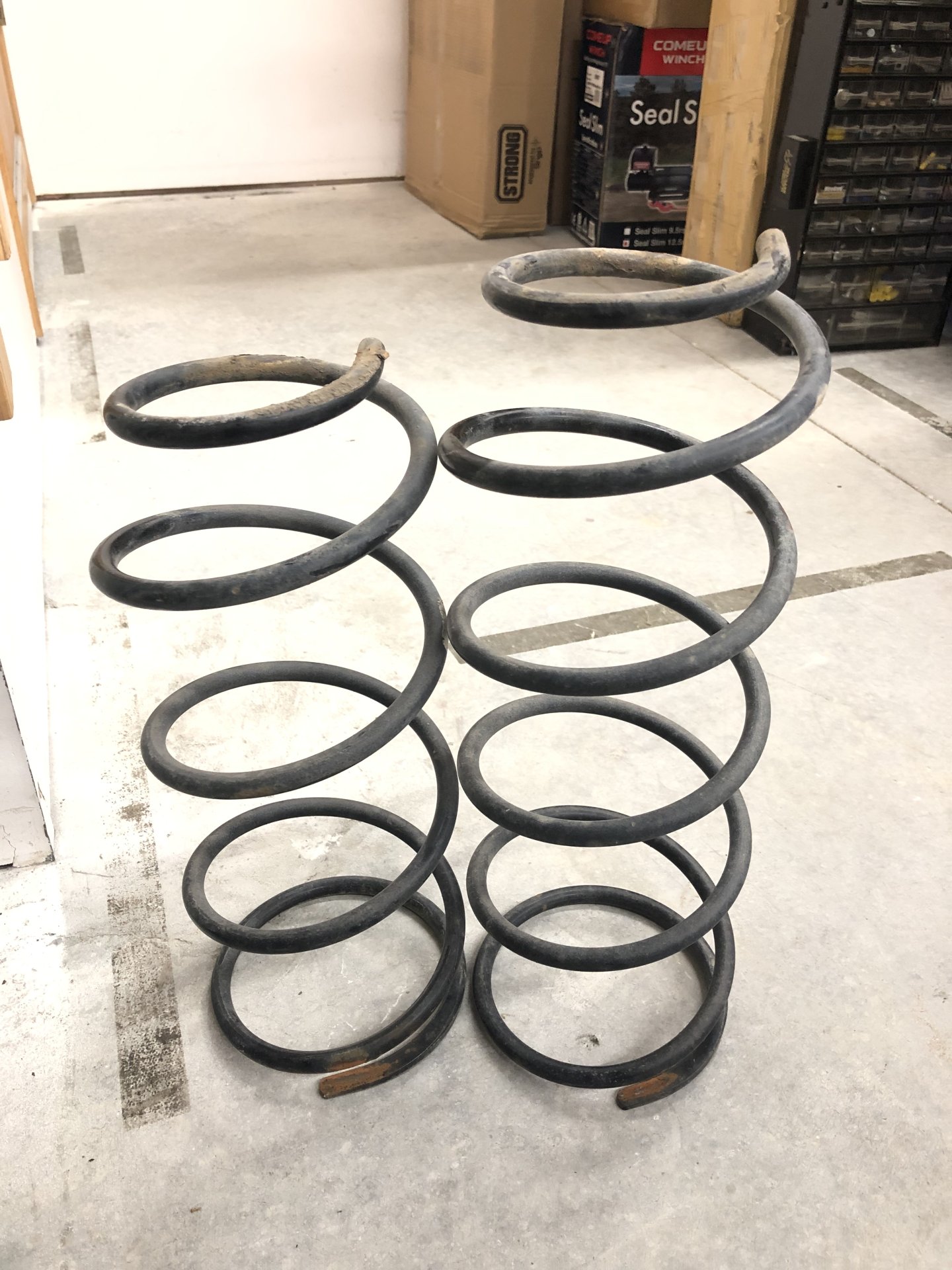

Picture earlier in thread on page 1. The oem passenger has 6.25 coils

It’s 6 5/8” to the outside of the factory coil springs. It was easier to measure these accurately since they’re off the truck.
Oem rear driver
12.67mm, 175mm outer, 5.25 wraps
149.7mm inner diameter
92 lb/in
ok. so that makes this
Driver - 12.67mm, 168.3mm outer (143mm inner), 5.25 wraps - 105 in /lb
Pass - 12.67, 168.3mm outer (143mm inner), 6.25 wraps - 82 in / lb
So now the driver is exactly the same measured and theoretical at 105 in / lb
Not sure how springs combine, but if it's linearly than the mean of above is 93.5 in / lb between the two.

If memory serves, the passenger rear is not only longer, it actually has a thinner coil. In other words the driver rear has 5 coils at whatever the thickness of the wire is…the passenger rear has 6 coils but has a thinner wire.
You are correct. I’m at about 12.45 on most of the passenger coil 👍🏼

Pass coil updated to new coil thickness
Pass - 12.45mm, 168.3mm outer (143.4mm inner). 6.25 wraps -> 76 in / lb
Avg now 90 in / lb
