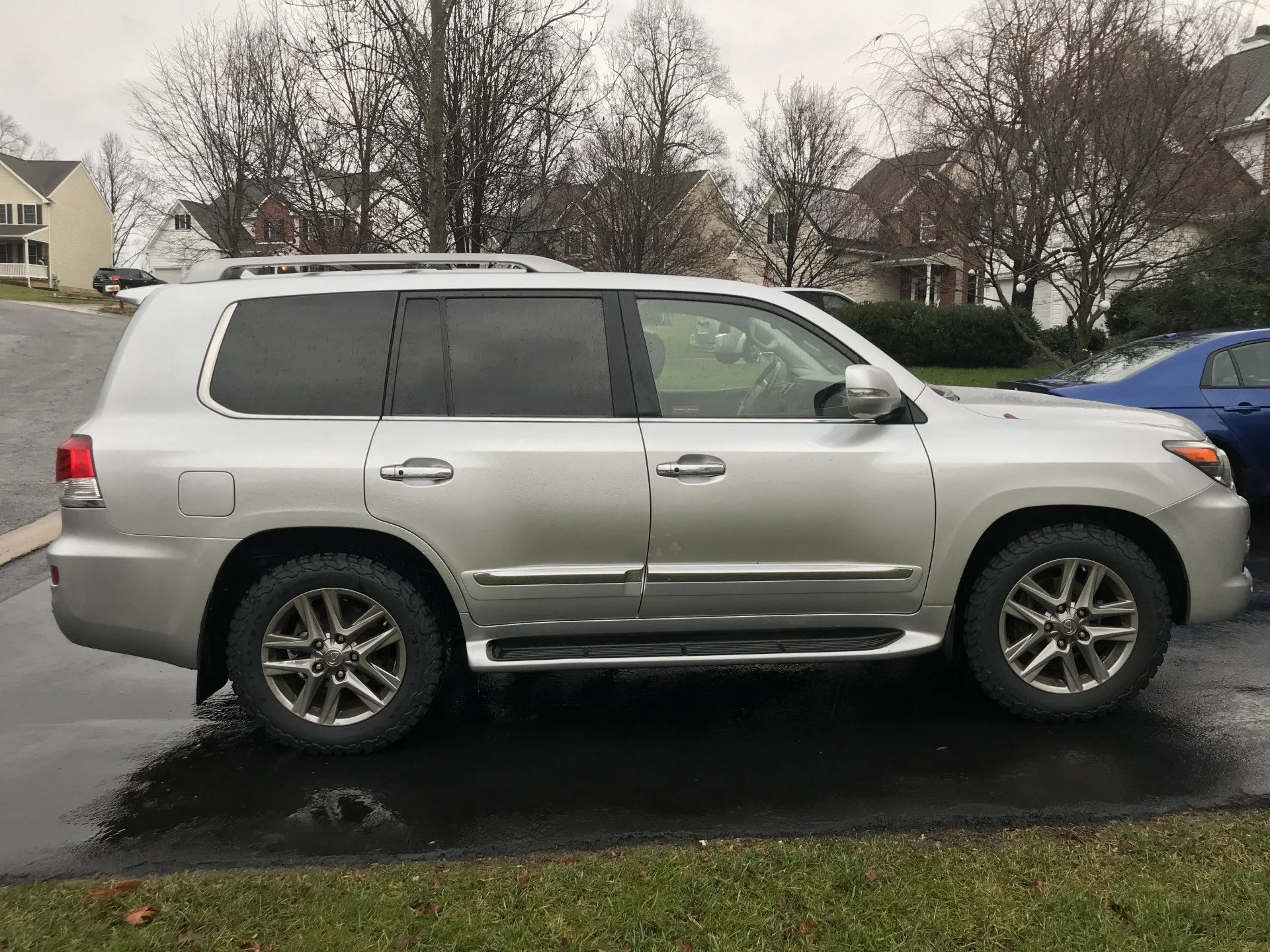

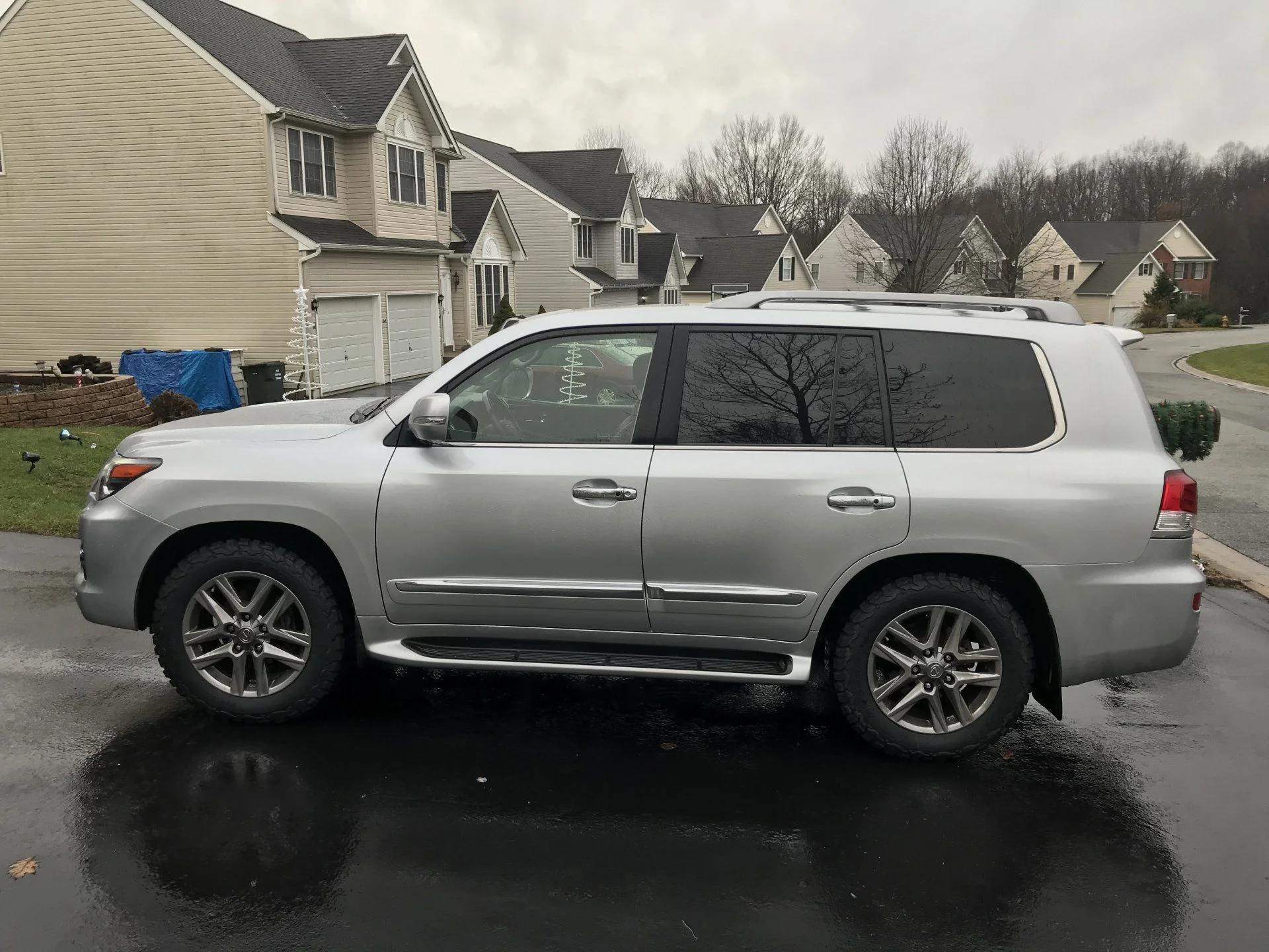

Currently Running KO2 -LT 275/60/20 no rub (with proper alignment)

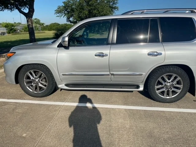

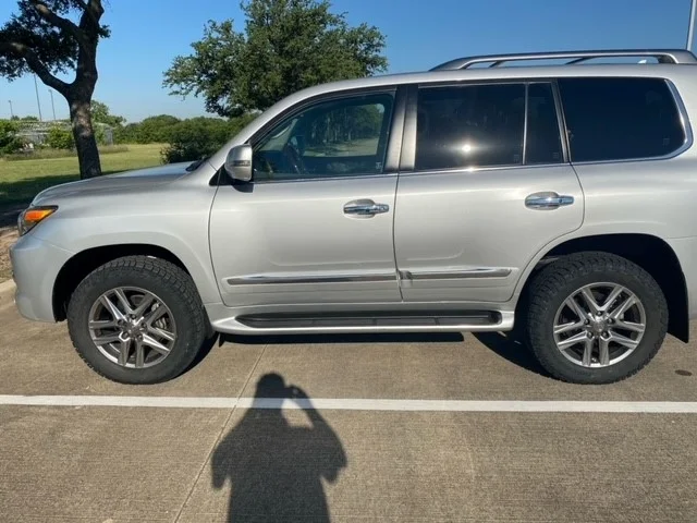

Also did a 1000 mile highway trip last week and have more data to share on the tires and tire size. I"m running the Toyo Open Country A/T lll in 285/60/R20. The tires are great. I have an off camber entrance to my yard that gets pretty flexy and slick when its wet. Thats the extent of off road usage so far and the tires have been great. A little more grippy than the KO2's on my 100.
The highway noise is hardly noticeable. The ride quality has decreased a bit on the highway and around town. The loss of power and fuel economy is very noticeable. I'm down 2-3mpg highway and obviously more around town.
The truck looks great but if I could start over I would go with a shorter and potentially less aggressive tire. The 570 is my daily with little to no off road use. I fell victim to wanting to look good but its really not worth the sacrifice.

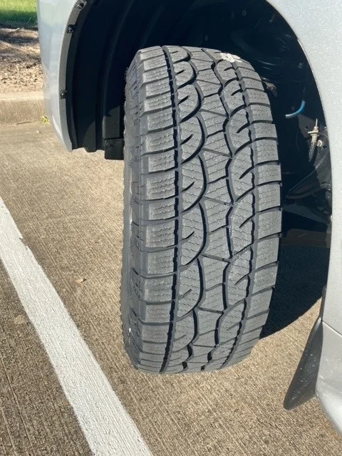

Day 5 of ownership and the comfy cruiser got new tires. Size: 275/60/20 Price out the Door: $900.62
I have had several sets of BFG's on my last few trucks and they are simply awesome in performance and wear. But, comfy cruiser needs to be quiet and the BFG's get a little noisy for family excursions.
The Cooper Discoverer ATP II is a new tire being carried by Discount Tire/America's tire. The tread pattern is noticeably more tame than other all-terrain tires and there is zero tire whine while driving. The sidewall tread design is beefed up and appeals to my mall crawler sensibilities.
