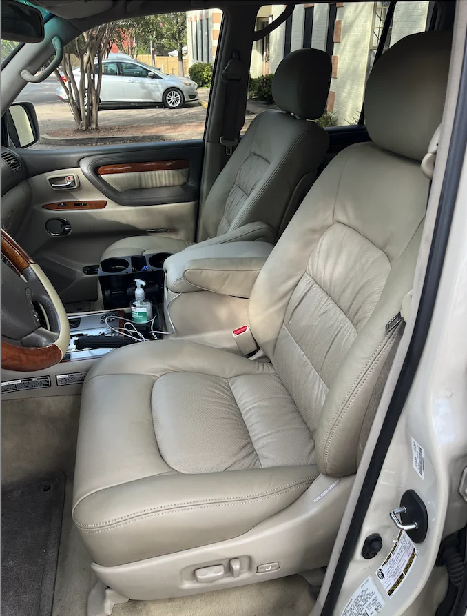

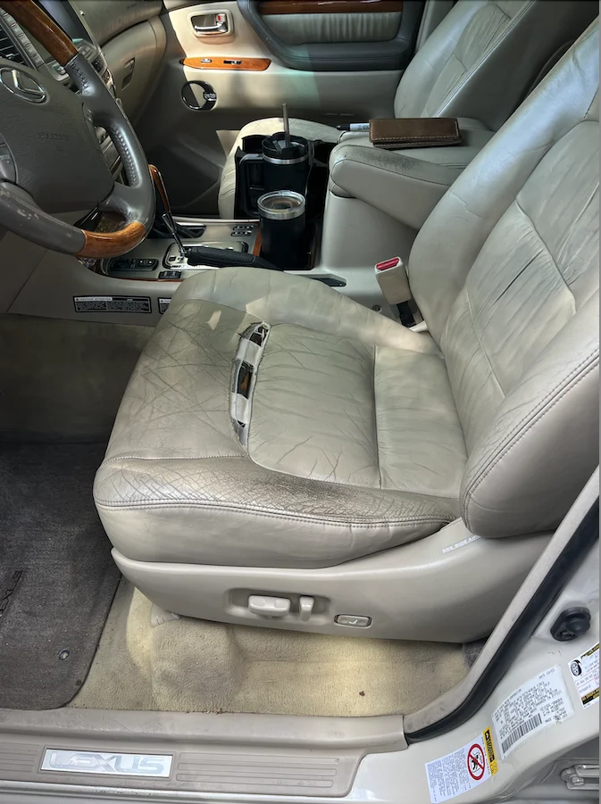

Fun before and after with Ridies, Arm isn's great. Next time I would just have upholstery shop cut leather, but still very comfortable and look a little better than what I had
fun View attachment 3441774View attachment 3441775

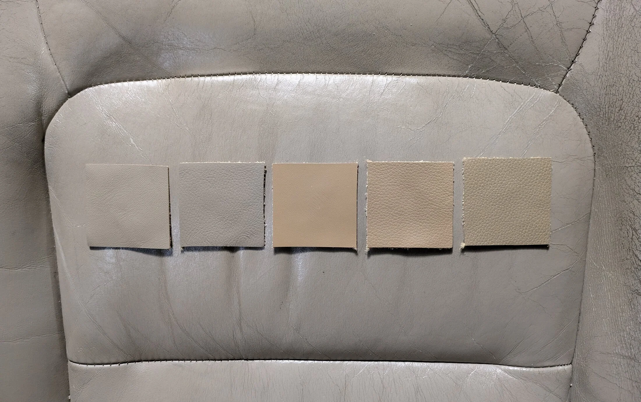

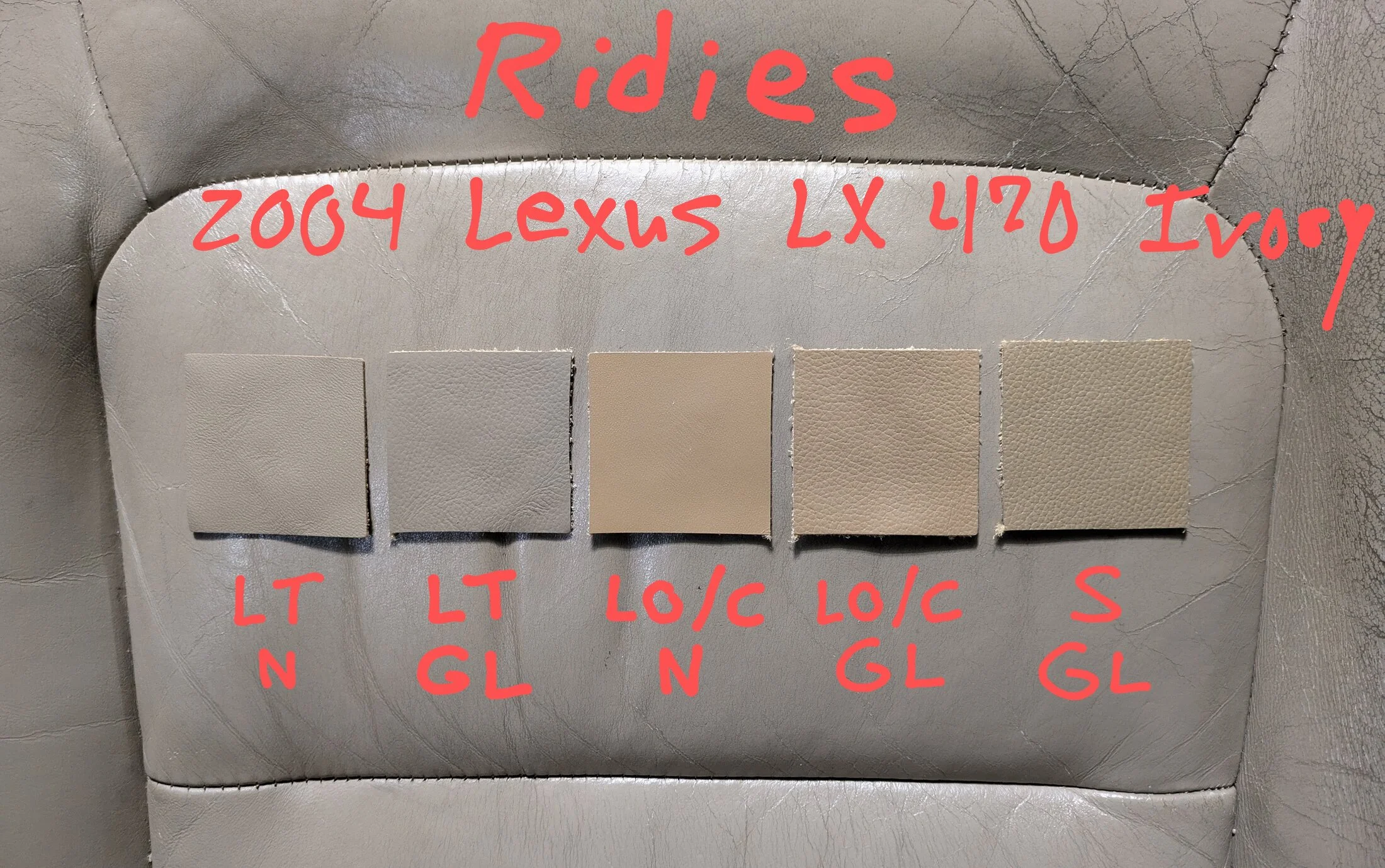

In case this is helpful to anyone, I received my samples from Ridies this week and laid out the close matches on the front passenger seat of my 2004 LX 470 with the ivory interior.
As you can see below, Light Tan - Napa is by far the closest match of both color and texture to OEM Ivory.
I have heard the genuine leather is more durable than the napa (material strength and dye?) so I'm not quite sure which direction I'll go yet. The napa matches better but I'd definitely prefer higher durability.
Key:
LT - N = Light Tan - Napa
LT - GL = Light Tan - Genuine Leather
LO/C - N = Light Oak / Cashmere - Napa
LO/C - GL = Light Oak / Cashmere - Genuine Leather
S - GL = Sandstone - Genuine Leather
Photo with codes
Photo without codes
Key:
Photo with codes
Photo without codes
Agreed. L/T Napa. Great post and pics. Good job Sir.
