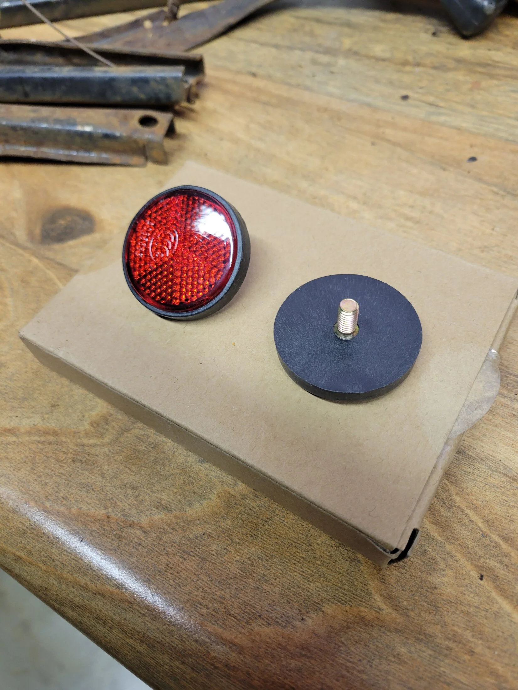

Here's the round red reflectors I stumbled across that should do until the real deals come along. They are 1 3/4" OD. No chrome ring but hey.

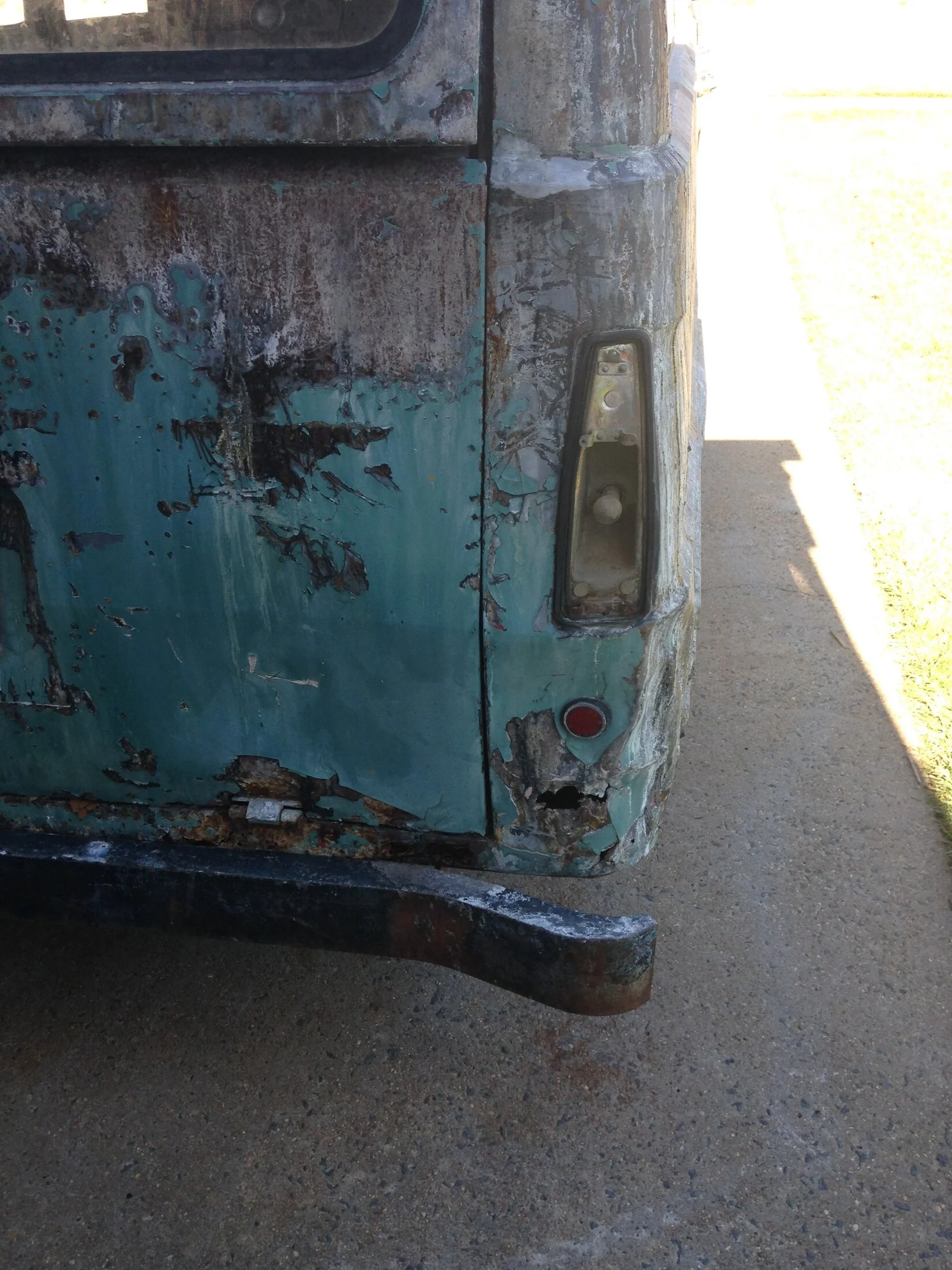

My LV is a '64 and it does have the small reflectors.

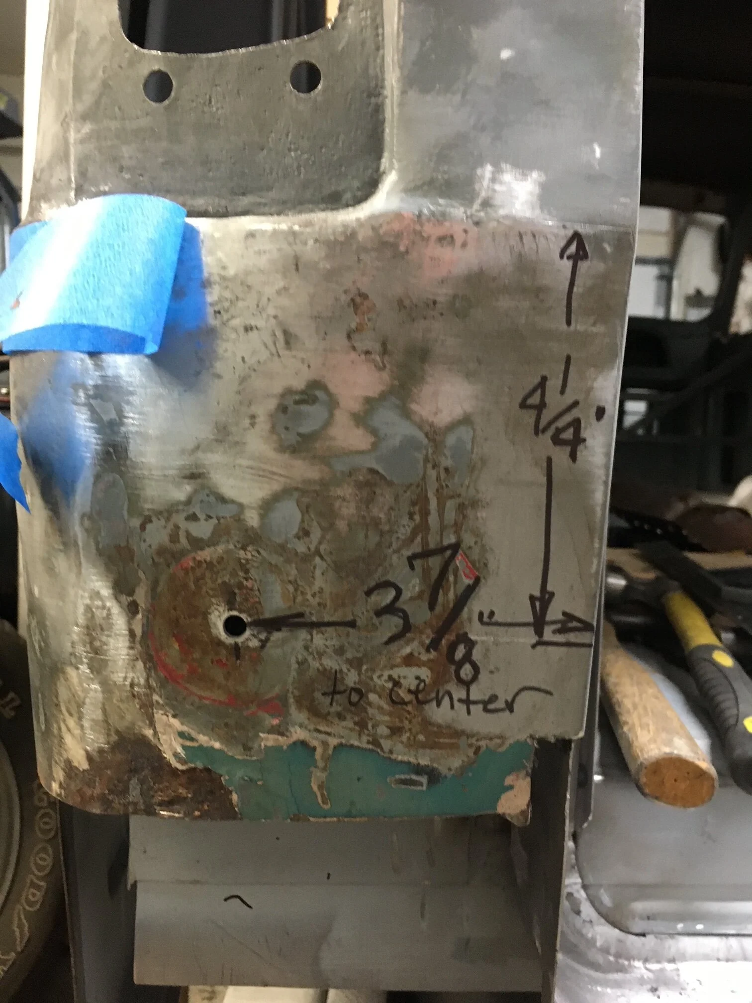

I attached a day 1 picture (yikes!) + a picture of location of the hole. For reference, 4-1/4" measurement is from the horizontal body line.
