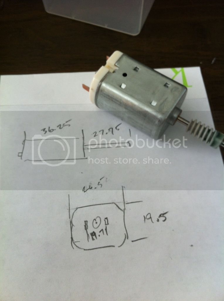

Most likely a high torque 540 motor.
oh this is definitely doable. thanks for the pics!
Is this is?!
http://www.mabuchi-motor.co.jp/cgi-bin/catalog/e_catalog.cgi?CAT_ID=sf_266sh
or
http://www.mabuchi-motor.co.jp/cgi-bin/catalog/e_catalog.cgi?CAT_ID=sz_286wa

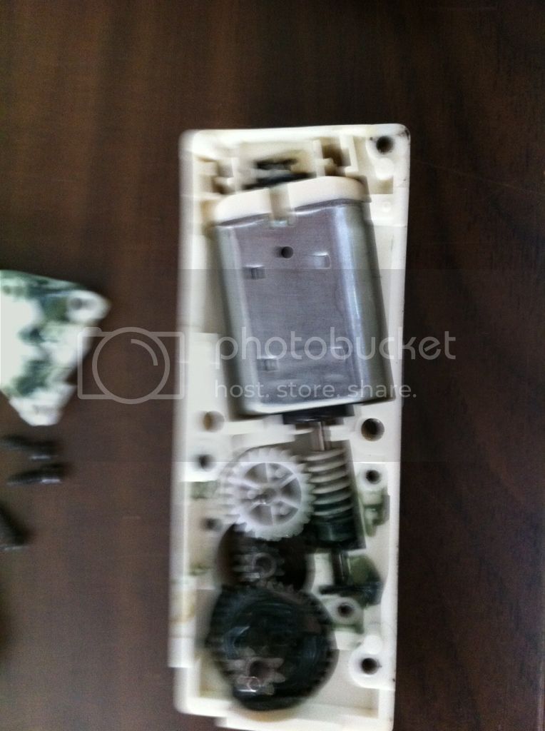

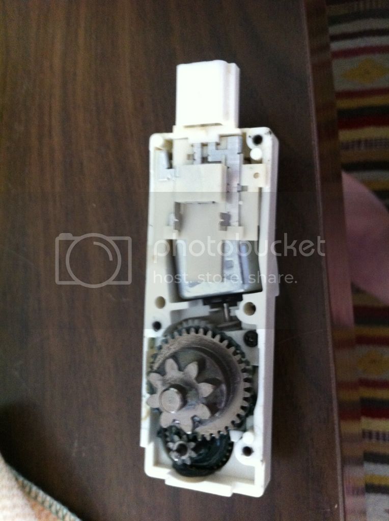

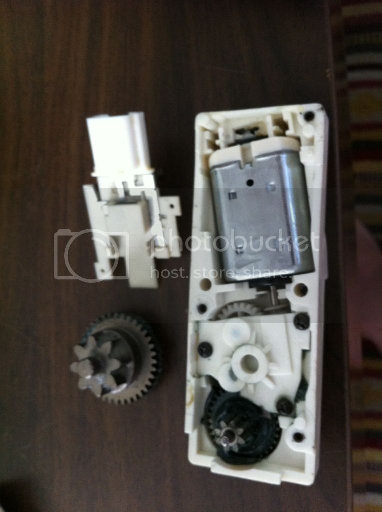

Big thanks to AlabamaLX for sending me his old lumbar motor. I dug into it and found out a few things.
1. the motor is rectangular so neither of the motors I thought might match will work
2. I gave the assembly 12v and it seemed to spin just fine even when I applied some resistance
3. the worm gear on the motor is very difficult to remove. I was unable to remove it. I will try again later
