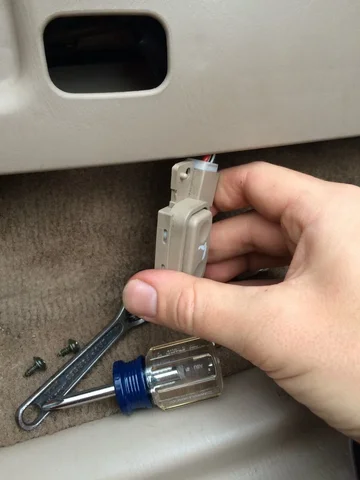

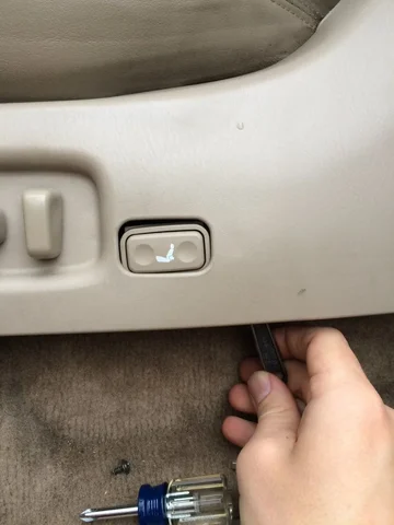

1) First I checked the switch. I used the relevant pages in the 2004 FSM (BE-112, for reference). Note that "lumbar" is spelled "lumber" everywhere in the manual, which might mess up your searches in the PDF. I was having trouble removing the seat cushion outer shield (piece with the switches) and didn't want to break the tabs as others have done. Removing the four screws was enough to pull it back and get in there with a screwdriver bit and a tiny Crescent wrench to slowly loosen the two screws that hold in the lumbar switch. Using the front camera on my iPhone was a huge help to see up underneath everything and find the screws.
Crescent wrench deployed loosening lumbar switch screws
Success!
Upon testing, the switch was fine... on to the motor
