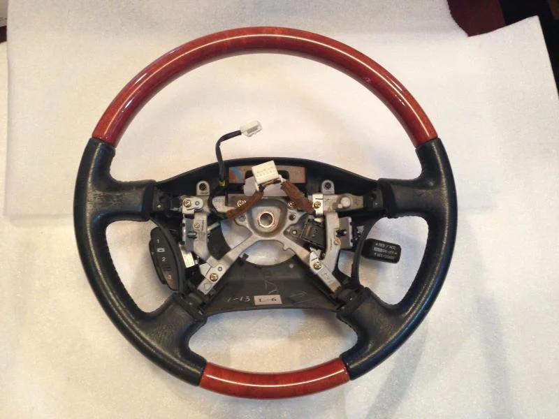

I bought a 98-2000 ls400 steering wheel for my truck last summer and it bolted on, but my airbag did not I can dig part numbers out later, and was needing to throw it up on the classifieds anyway. Have original box too for it so I have the part numbers...
As far as I know, the horn will not work using a 98-2000 steering wheel.
Can anyone verify this?

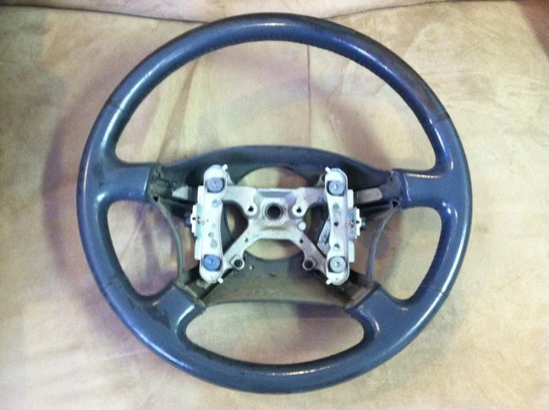

Edit: pictures added of my 97 FZJ80 steering wheel and a 99 LS400 steering wheel.
If the horn won't work, then I have to keep looking for a LC replacement... :-(
Yes, the horn from your Land Cruiser bolts on and works fine onto the LS400 steering wheel. Done it many times already. They're the exact same shell
Reporting back with a definitive answer; the wood 98-00 LS400 wheel does NOT work with an 80. :crybaby:
It's splines are the same and it fits on fine, but the airbag and horn will not work without fabbing some brackets.
