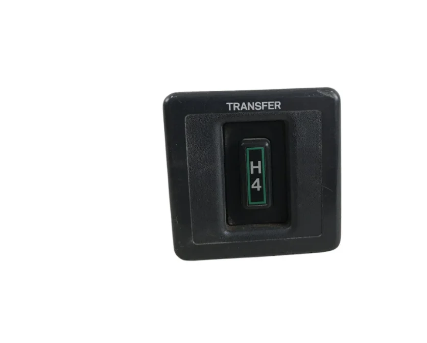

Is this the switch for the dash you mentioned @dbbowen?
Do I have this right - I put the HF2A in my truck as described above - with no 12v signal, the T/C is in 2wd mode, assuming I order it correctly from @cruiseroutfit , and when you activate the switch, it will switch to 4wd, HI mode, then you utlize the lever to select low range for either 2wd or 4wd deepening on the dash switch's selection? I guess we will get to the wiring part of it later during the swap.
