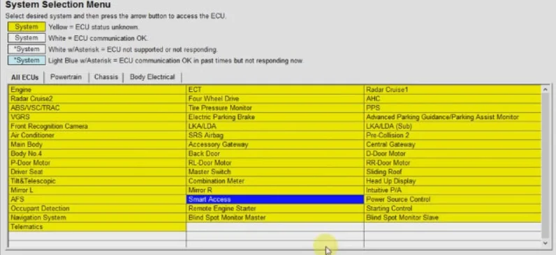

Pretty sure no one has, between the 3ur being a fantastic engine almost eliminating the need and the high level of integration between the engine and transmission computers and the rest of the vehicle. A simple evap code can prevent us getting into low range.. I’d think convincing the Toyota electronics not to look for the appropriate signals for everything to work would be nearly impossible, not to mention the emissions legality of a swap like that.

Maybe as a full gut and replace it would be viable. Replace engine, Engine ECU. Body ECU. All controls. Replace transmission and transfer case. Custom axles and driveshafts. While at it need to put in a SFA.

And at that point you would absolutely have spent more than just replacing the 3UR, and been without your rig for three to six months while the gauge cluster is figured out.. or some other obscure system that is actually really important to have working in a a streetable rig.

With this many ECU's onboard talking CAN bus, and half of them likely throwing fits without key ECUs in place, I wouldn't dare.

The 200-series is a highly integrated and refined car. All the core off-roading tools such as CRAWL, ATRAC, electronic transfer case, variable steer, even ABS...all that potentially is gone, and that's just the tip of the iceberg. A 200-series wouldn't be worth having without those.
