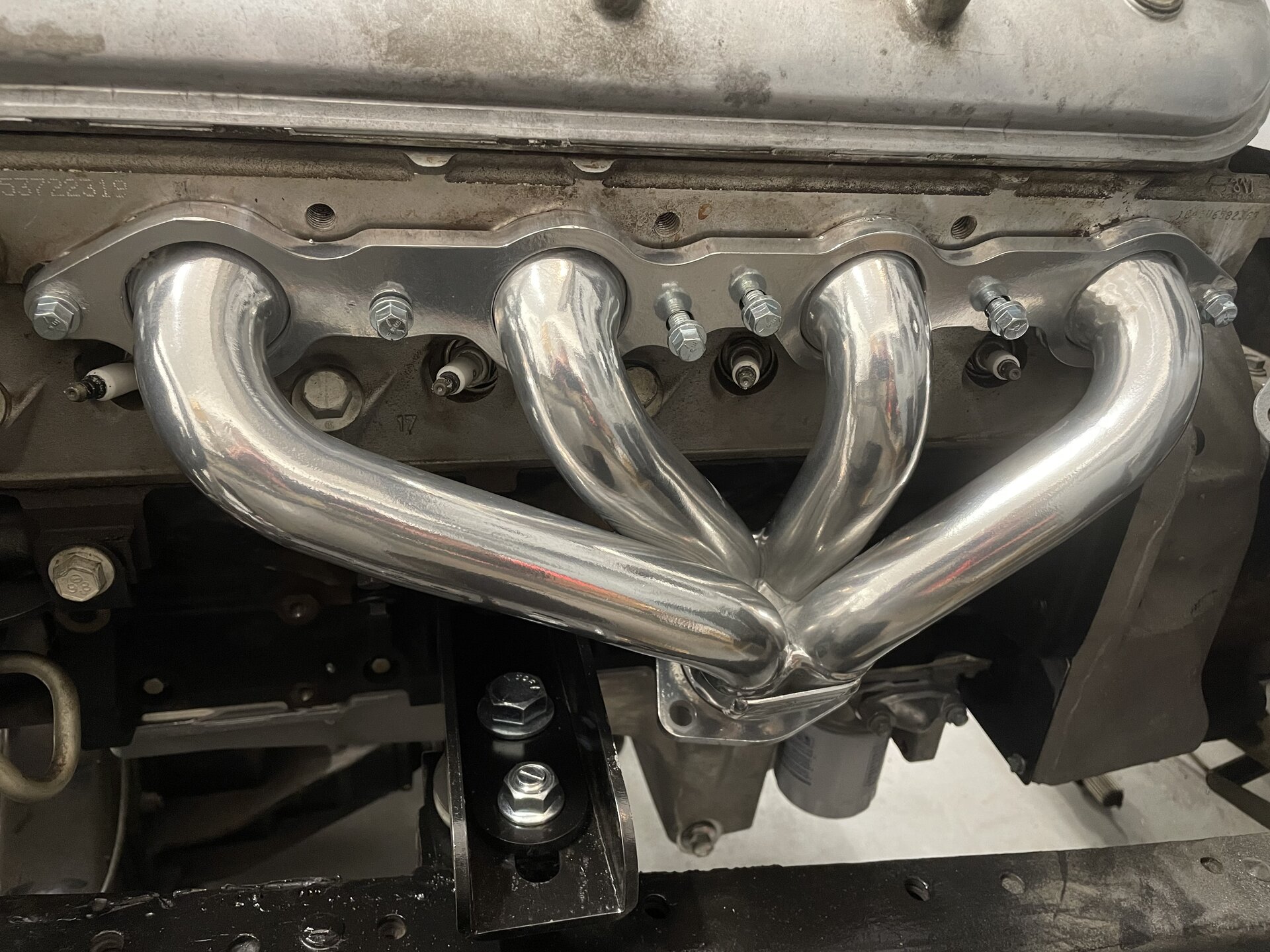

Obviously Sanderson headers work as should. I see Another possible option. I like manifolds better just naturally.

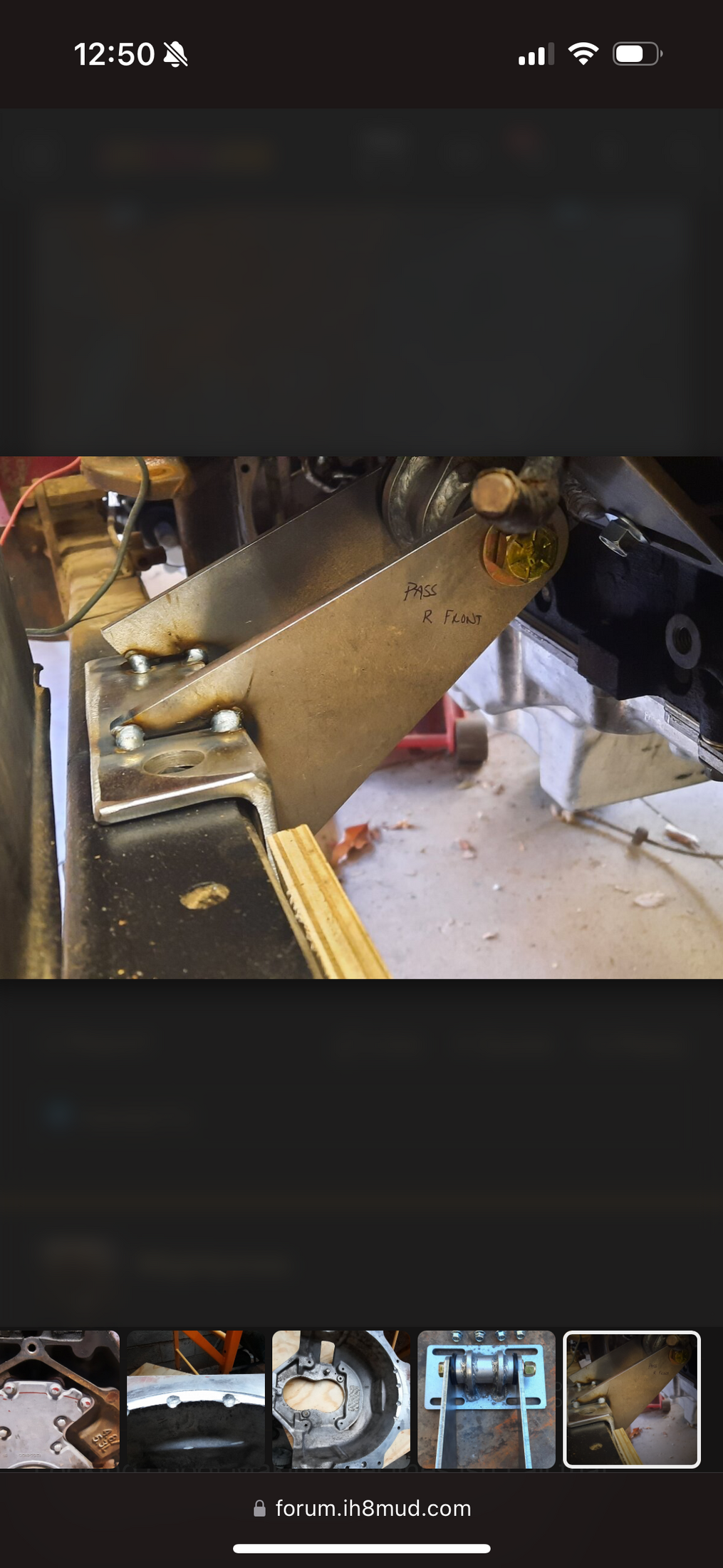

I’ll be using this style engine mount, very much like in this pictures.

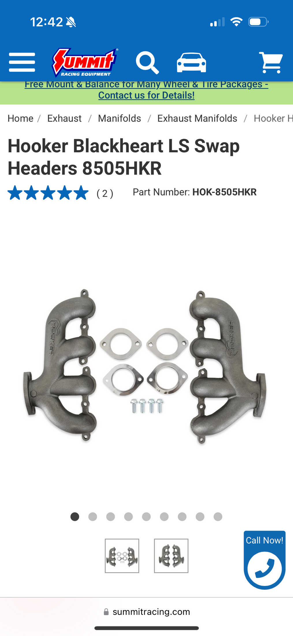

Those rear dump hookers are nice. Curious why not use stock manifolds ? I supppose the cost might be comparable between new Hookers & parts yard stockers anyway. Hookers are good.
I don’t think you can use stock truck manifolds with external slave cylinder.
At least not that I have seen
Ah, you cant, I used a camaro manifold driver side which is close but with a simple alum heat shield & some fire sleeve on the slave line it has been good. FWIW the truck manifold works on pass side but the exh pipe has to curl around starter whereby the Hookers you show might relieve that a bit. If your slave is on pass side then use camaro pass side manifold. They dump almost where the Hookers do but the orientation of the flange is quite diff.
Saw some Speedway headers (Cast) on a 40 with LS at PMC Swap meet that were very nice, had a bit more clearance on the driver side slave than the stock camaro manifold provides. The other caveat is motor mounts for LS, some use GM and some use A/A, not sure a header that fits the A/A will clear if using the GM mount.
