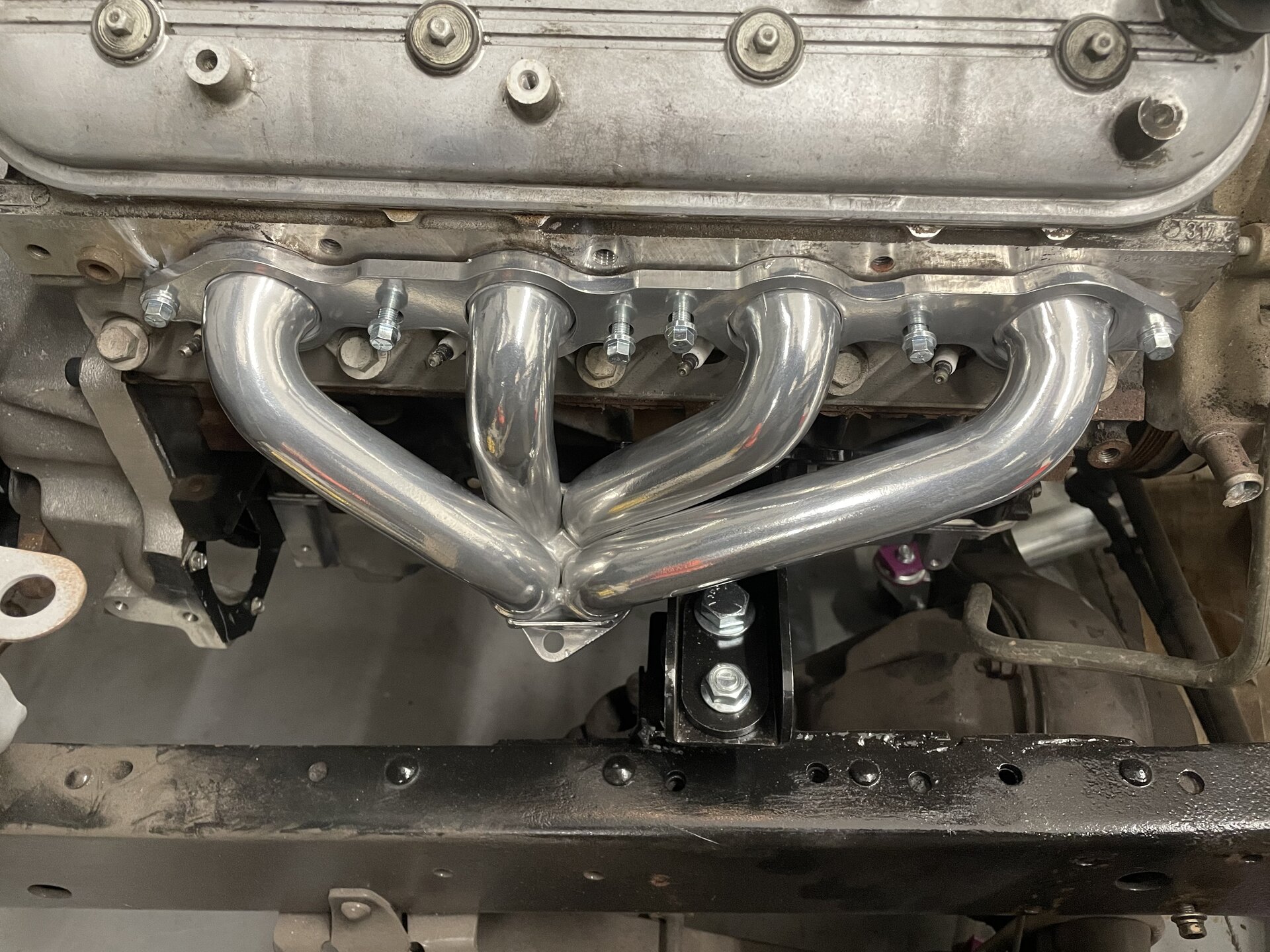

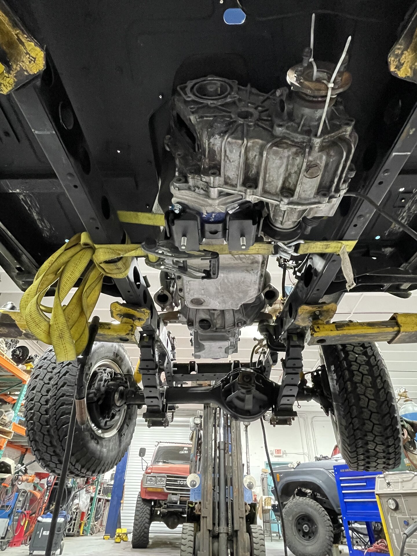

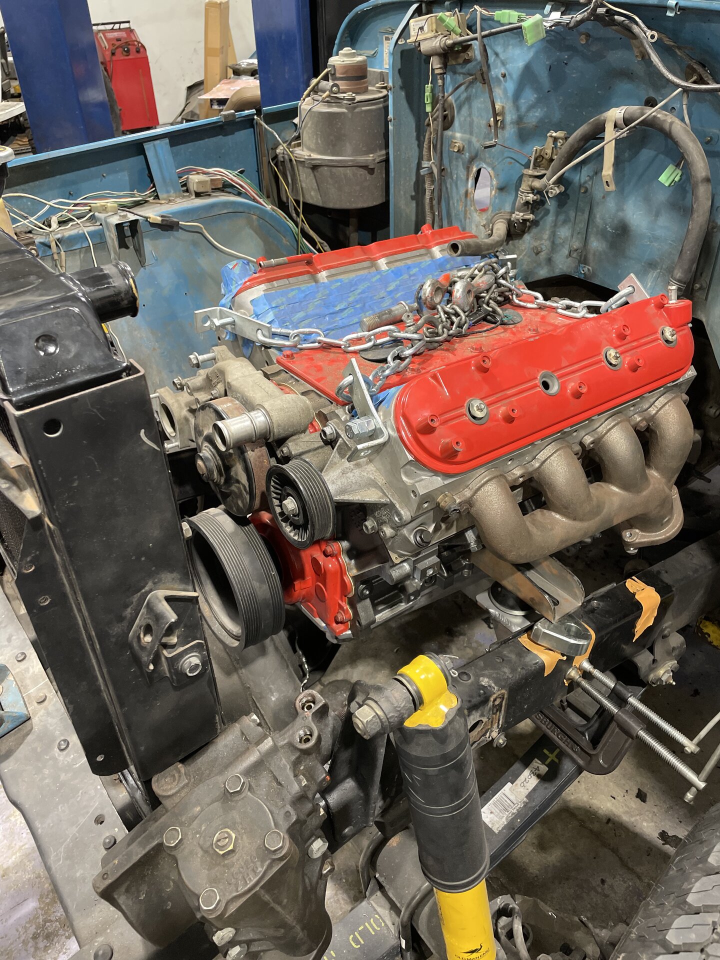

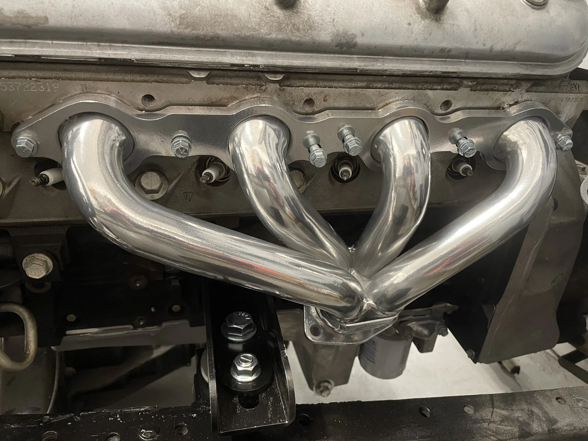

Here is a project we are working on now with a 4l60. Ignore the red valve covers and timing cover, those are getting swapped out red valve covers on a blue truck, don’t know what the guy was thinking :rolleyes:

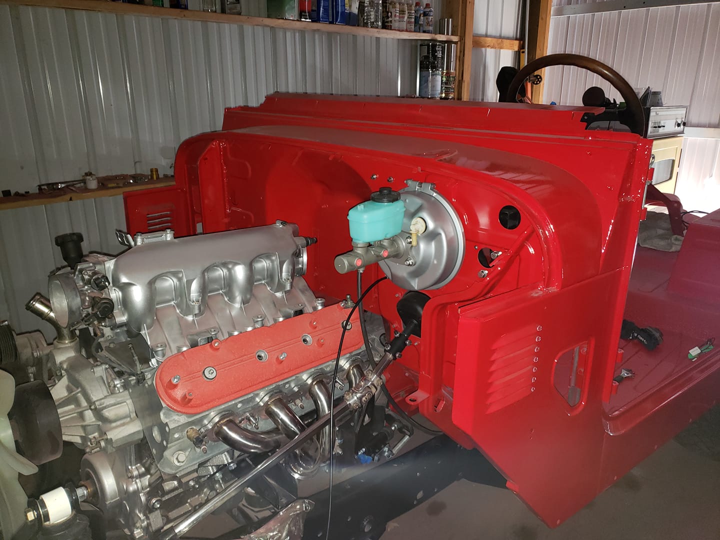

Good ole wrangler at/s.. you don’t see those around anymore.
I like that manifold fitment.
What mounts do you use?
This is just the AA setup. I hate them but unfortunately don’t have time to work on developing a system like I have for 60’s and 80’s.
X2 with those huggers, they were too big plus they dump straight down, hard to route them like others expressed. I picked up two sets of edelbrocks that worked fantastic under the 40, however Not sure if they still make them as this was about 9 years ago. It also has a integrated 02 bung

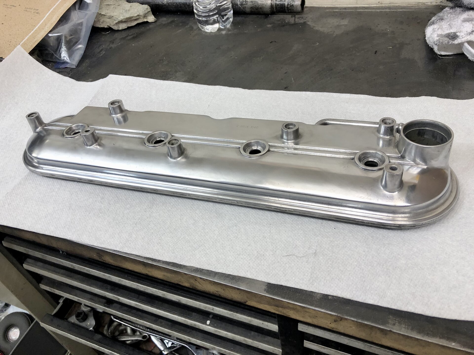

those valve covers are tough to sand and polish, the casting is rough! Good idea to paint them if next time.

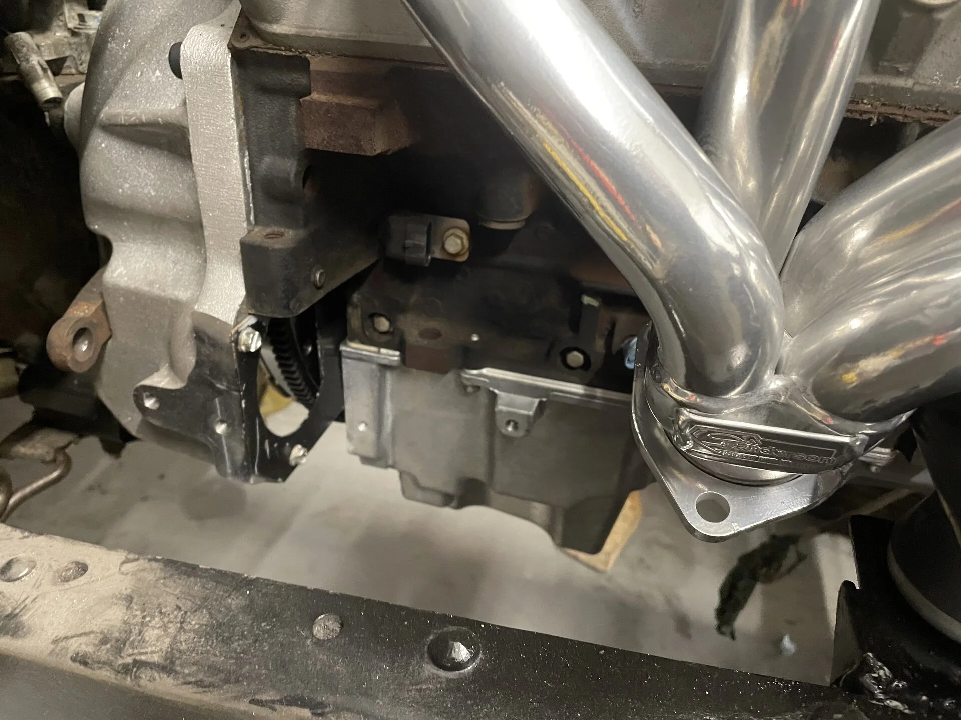

Matt,
Can you get me a couple of pics on the pass side. I want to see what it looks like near the starter. I guess a top view and maybe a side view so I can see how far back it dumps out.

I'll try to remember to - but there is plenty of room. It's like it might as well be an OEM GM manifold.

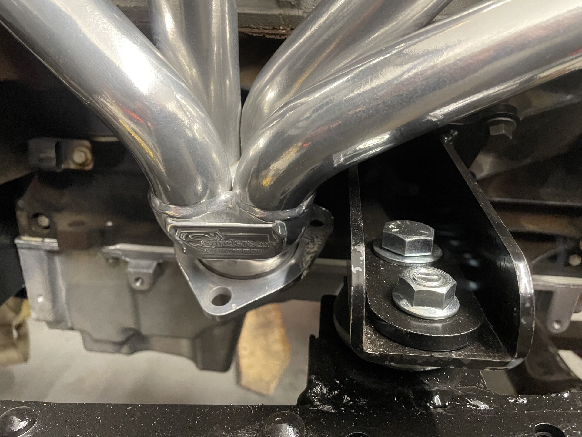

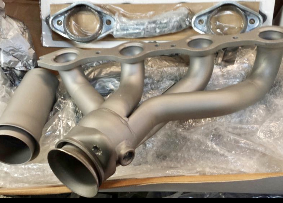

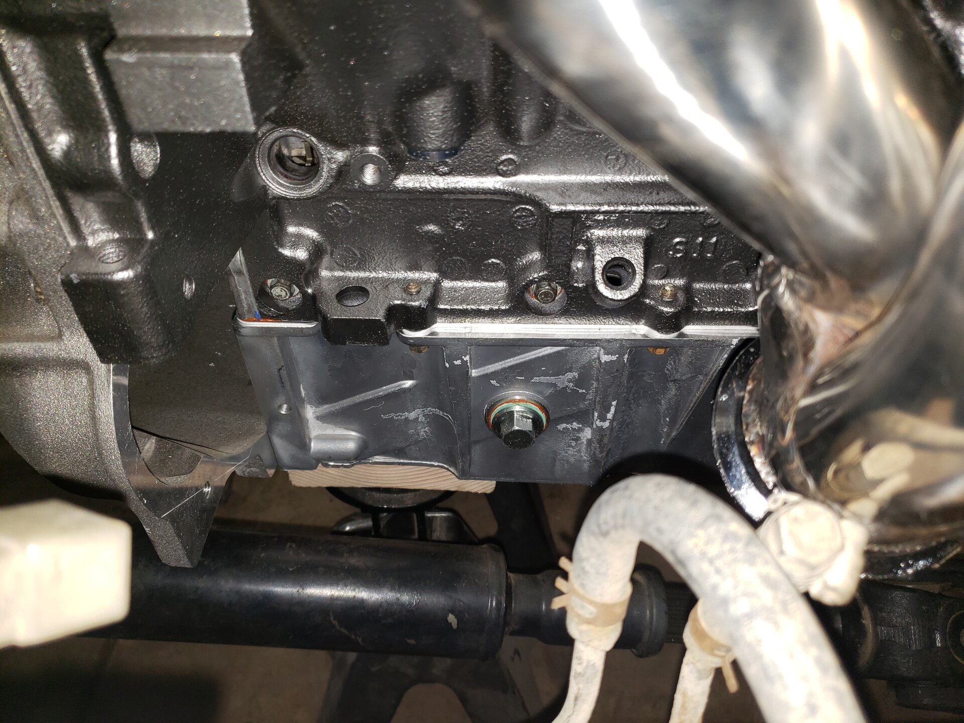

So I just did ebay. $140 last year. Stainless, V-band, block huggers. Came with the V-band clamps and the downpipe flange already welded to a 45 elbow. Passenger collector is a little close to the engine mount. Close up of the clearance for the starter. I can only find 3 bolt flange block huggers now.

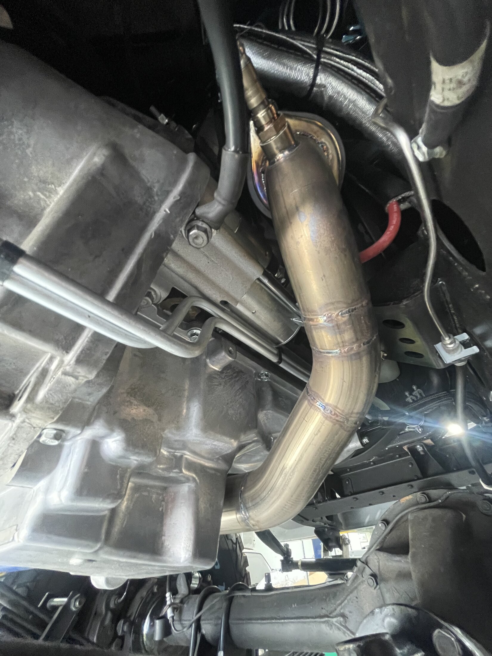

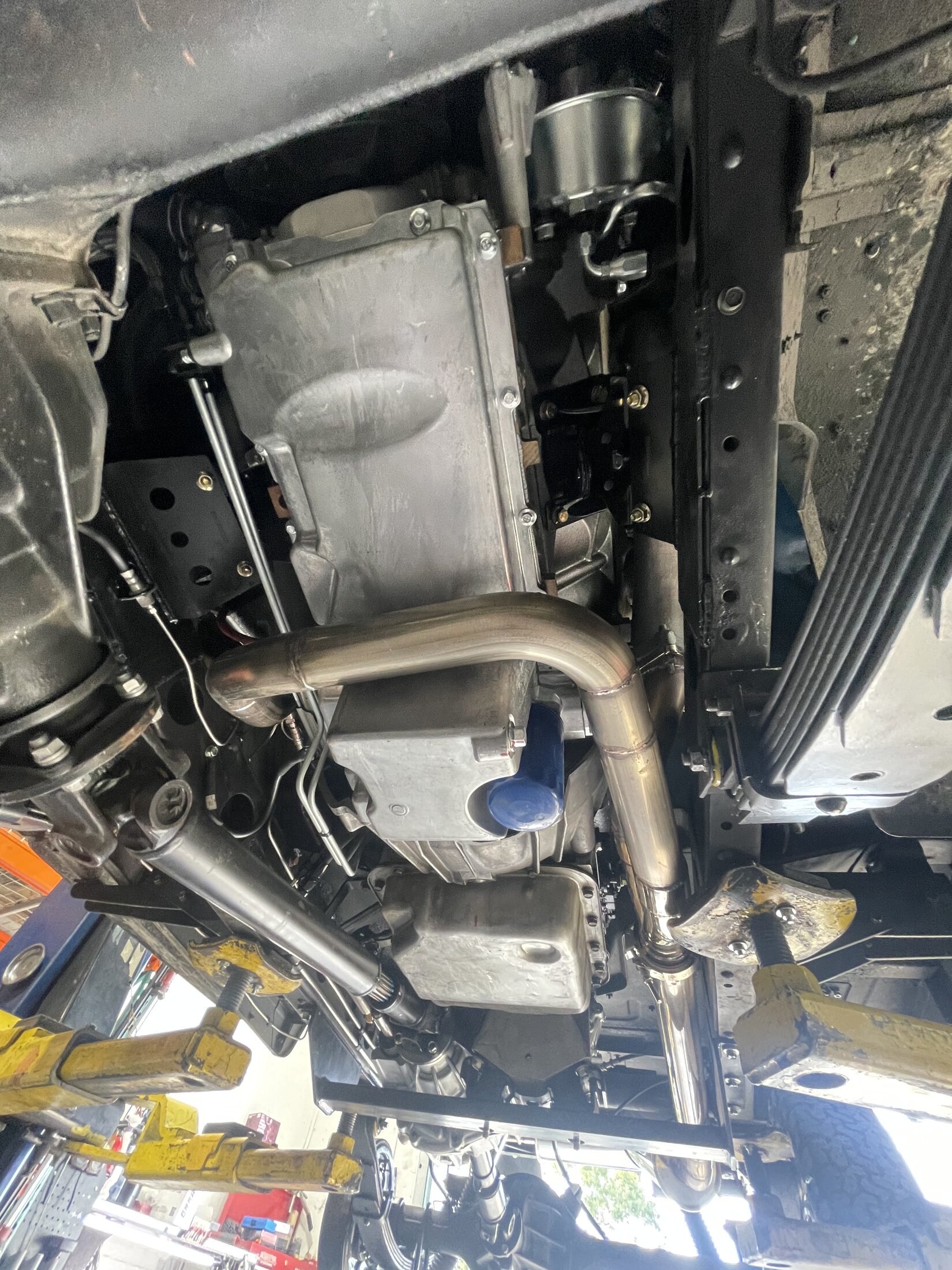

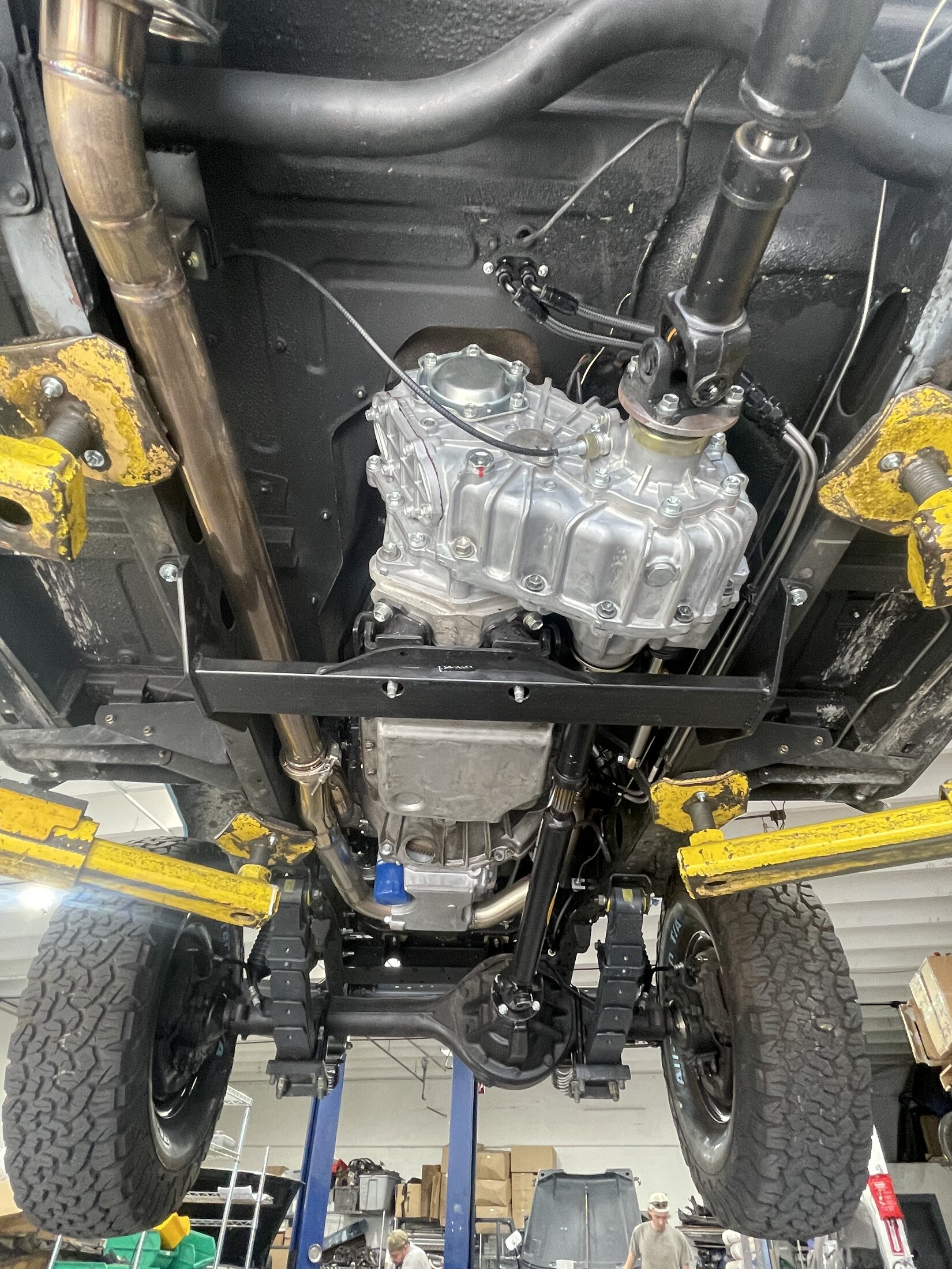

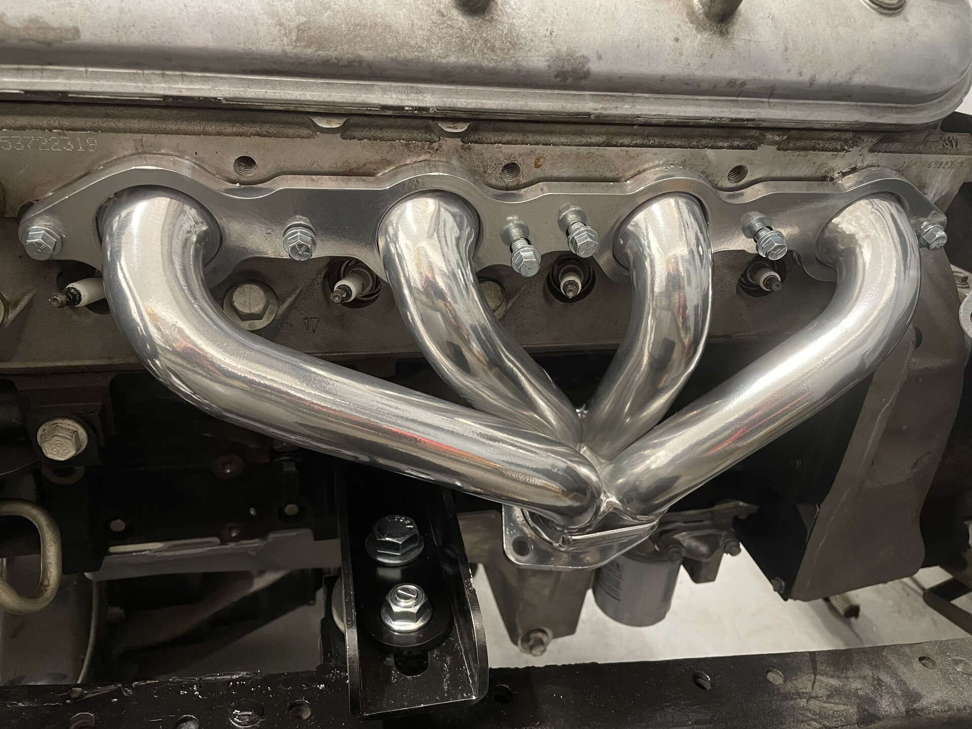

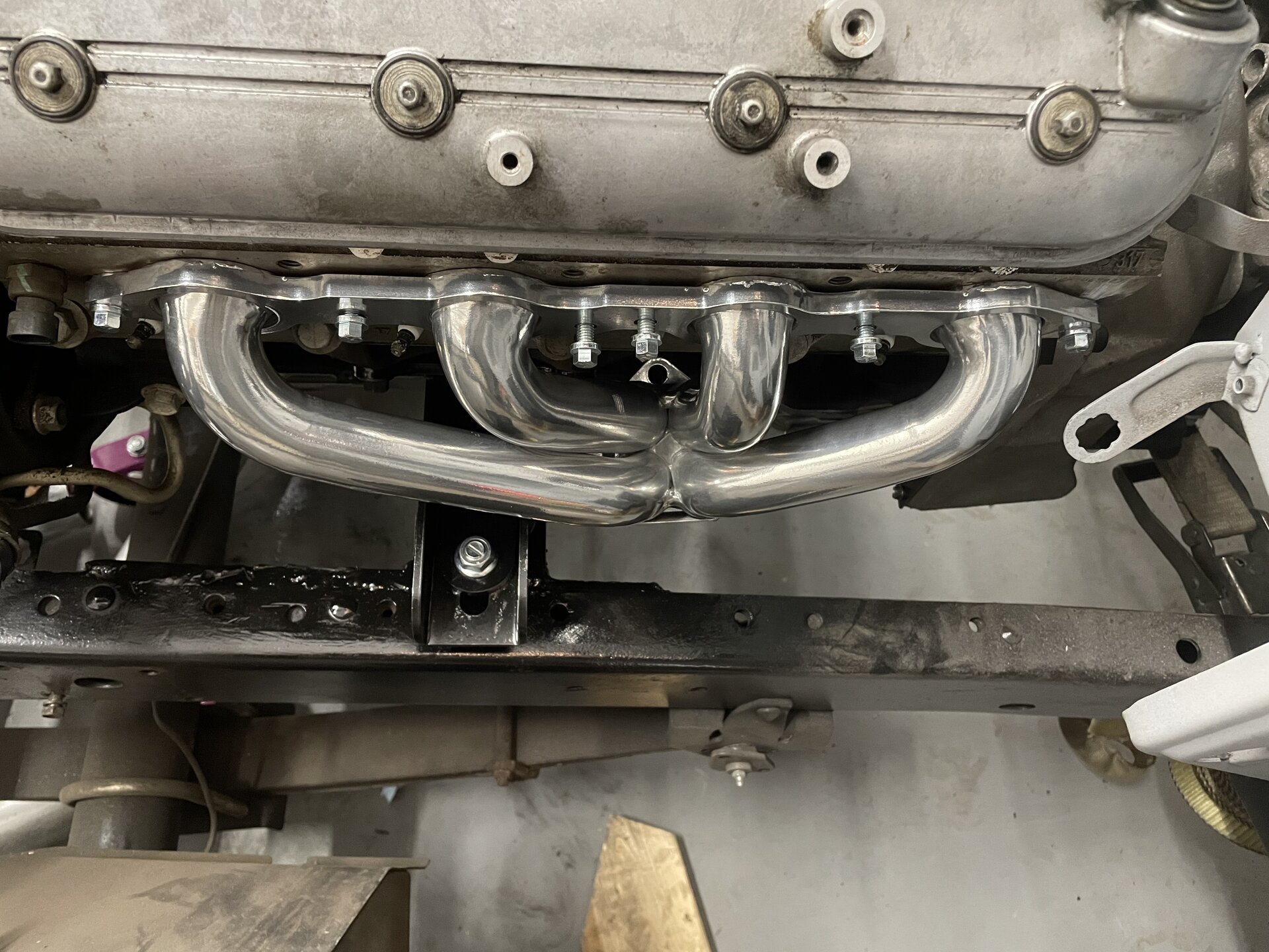

Hey Matt, did you ever take any pics of how you routed the exhaust on this build?

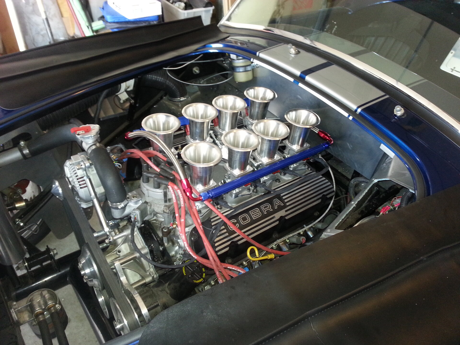

Going on 2 years now and zilch wrong with mine. And here is how I routed mine.
how many miles? I did something like 35 or 40K. (I was driving 650-700 miles a week for work and school) Looks like a nice 40.
Thanks. Did all the fab, mechanical, bodywork, painting, and assembly myself. And I agree, 40k is about the life expectancy for cheap headers, well all fabricated headers. Hooker, Headman, BBK they're all about the same lifespan. I inspected the ones I received and the welds looked good, the flange is 10mm thick, and they are true 304 stainless. Not sure I'll be around if/when these hit 40k.
